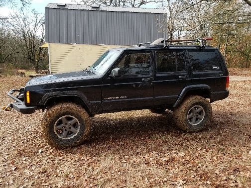

I put a Skyjacker 3" lift with Bilstein shocks and 32" tires on my rig. I do go off roading though. I wouldn't have gone that big if I didn't.

Here's what I'd do if I was getting another XJ to be daily driven(and actually my plan for my kid sister in a couple years).
-new upcountry leaf springs
-shackle relocation boxes
-any decent boomerang shackle
-New upcountry coils up front with small puck spacer to level suspension
-IRO double shear track bar
-5100 bilstien shocks
-Replace control arms with new OEM arms, it's almost cheaper than just replacing bushings.
This should net around 2-3" of lift and ride great. Driveline should be happy at that lift, especially for a daily driven rig.
