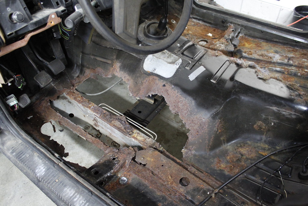

pulled away all the loose metal, trying to find something solid to rebuild from...

and cut away more of the cancer...

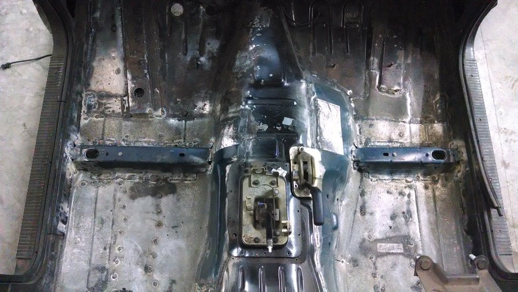

and got some new/recycled metal burned in...
got more of the pass side done today, almost skipped on removing the support bar, glad I didn't, rust was hiding underneath ...
just need to spot weld the pass side and the frame support on the driver, and that pretty much takes care of the rusty floor, then on to the exciting stuff
Seam sealed inside and out and POR 15, no more rust and no more leaks, this thing may actually float now
