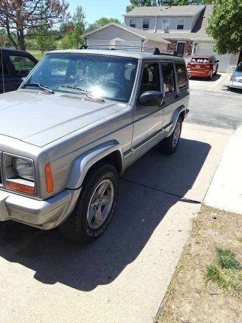

2000 XJ Classic 4.0 AW4 NP231 C8.25 3.55 diffs 206XXX Miles- Was looking at Crown HD packs with full length AAL, maybe OME D22XL, for replacing sagging leaves due to carrying tools frequently for work and mild pop-up camper towing this summer. I'm a Millwright by trade so I am competent in modifications and repairs. Looking for some insight and suggestions. I've scoured the board and Web looking for a similar situation and haven't come up with anything as of yet. I am also leaning towards the 930 coils for a mild lift with tire change of course. I've owned a trick TJ in the past with Nth Degree and Poison Spyder goodies that'd been to the Rockies and the deep South for some crawling but family and 2 huskies required a more DD friendly vehicle. Was a rust free example when purchased in CO last year and is starting to rust at the doors but nothing serious yet. Had a bit of hail 3 weeks after purchase and it totalled it out since it was pristine when I bought it and it helped the insurance adjuster was a Jeep fanatic from the Northeast. 😀
