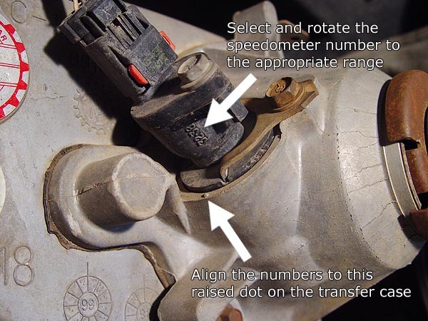

You did pull out the gear to inspect it? On my jeep the sensor was not properly clocked. I just clocked it for the proper tooth count and all was good. Granted I'm 15% off lol

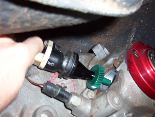

I meant the gear that sits below the housing on the speed sensor. Here you can see what it should look like. Also, it's worth pulling that assembly and taking a look at the plastic gear on the output shaft. Mine hadn't been clocked properly, so the gears weren't meshing and the VSS read. It also chewed up the gears a bit.

having trouble determining how many teeth my XJ is supposed to have, i am seeing 32 teeth, 34, and 39 teeth gears.

Depending how it shipped from the factory there are a few different options. Also you can get different gears for when you change tire size. They are all different colors and have the tooth count right in the gear though so easy to ID. Feel free to post up some pictures if you have any questions
