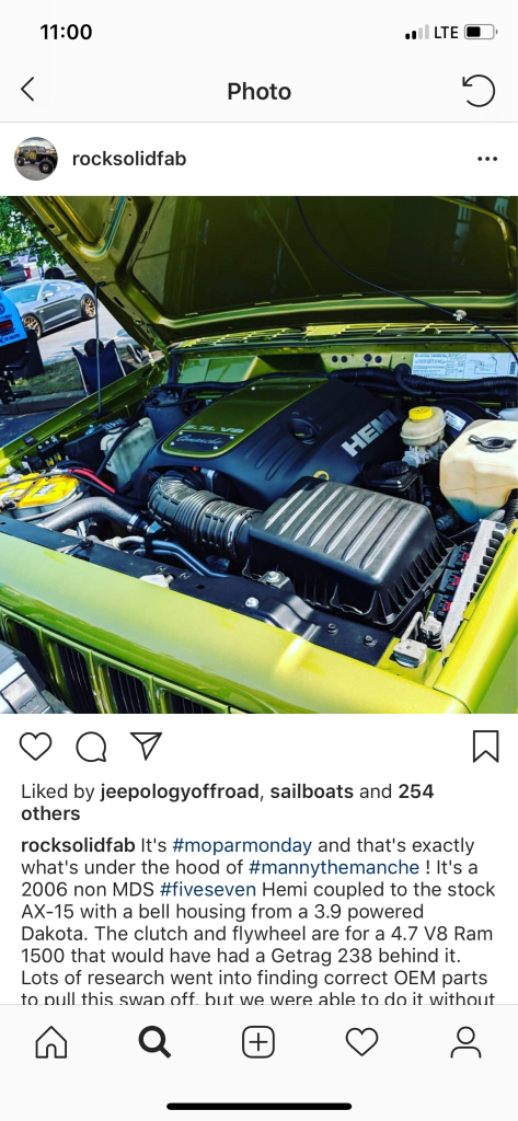

Basically, I started by doing a ton of measuring. I wanted to make sure the engine would physically fit under the hood and between the frame rails. I quickly determined that it would fit between the frame and height shouldn't be an issue as long as I pushed the engine back. Also, we have our production 3 link long arm suspension on the truck, and I knew if I attempted to move the transmission from its factory location I was going to run into issues with fitment. The other benefits of not moving the transmission was that I could retain the stock shifters, linkages, and drive shafts, which also prevented any modifications to the console.
We removed the 4.0 and got everything stripped from the firewall forward, leaving the AX-15 bolted into the truck on the 3 link cross member. I then removed the 4.0 bell housing from the transmission and installed the bell housing from the 3.9 Dakota. This bell housing is a stock piece that works to bolt pretty much any small block LA or magnum engine to an AX-15, but it also fits the Gen 3 Hemi engines as well.
Once the bell housing was in place, I picked the hemi up with the hoist and slid it between the fenders. Obviously the firewall was in the way and the engine could not bolt up to the transmission, but I aligned it by eye as close as possible both vertically and horizontally so that I could get an idea as to what needed to go away to get the engine and transmission mated together. Whew... it was bad. The very center of the fire all would be ok, but other than that, both sides behind the heads would need to go away. Not only that, the steering shaft was behind the drivers side valve cover which would also prevent the engine from moving back unless I moved the shaft over which is what I ended uo needing to do.
Unfortunately Imgur takes forever to upload and I have hundreds of pictures. that will be needed to tell this story. I am going to pause here for now, and continue once I can post pictures along the way. Otherwise it will be difficult to follow the process.
But as stated by Wade, the truck is running and driving now. I still need to do a little tuning to finish it up, but its not anything major.
This is the first XJ/MJ Hemi swap that has been successfully pulled off while retaining all creature comforts such as A/C. Its also still 5 speed which is rare too. Most V8 swaps favor an automatic transmission.
