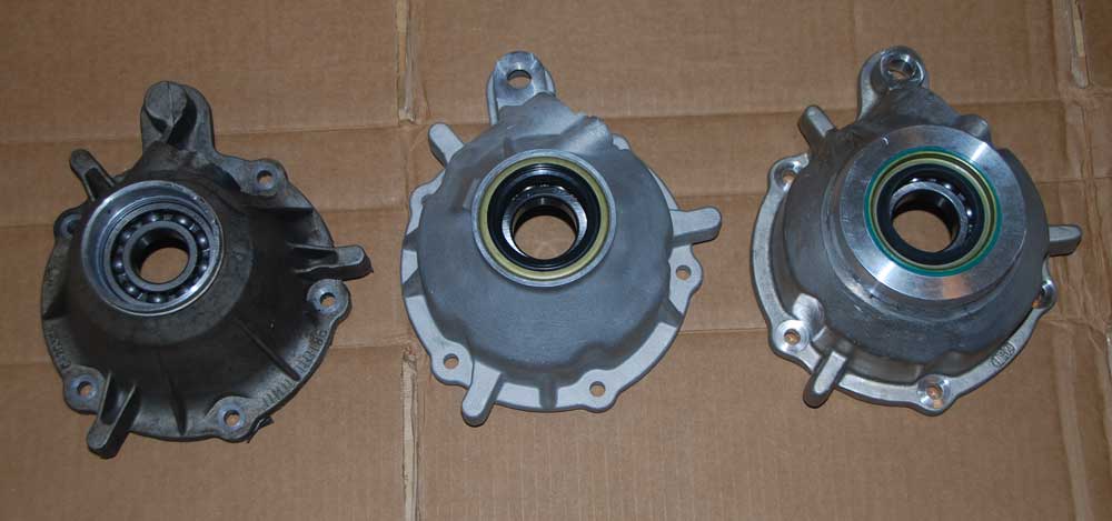

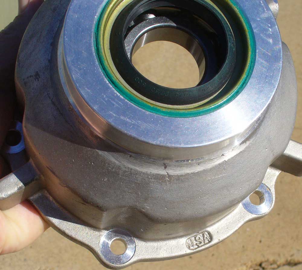

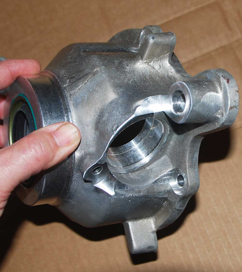

I have seen some comments about SYE kits all being the same, just order one and move on. I have not laid eyes, let alone hands, on any great variety of these products, but I can tell you that the JB Conversions SYE is not the same as the Advance Adapters SYE. These are definitely different products.
Following are some pictures so that folks can see a bit of a comparison.

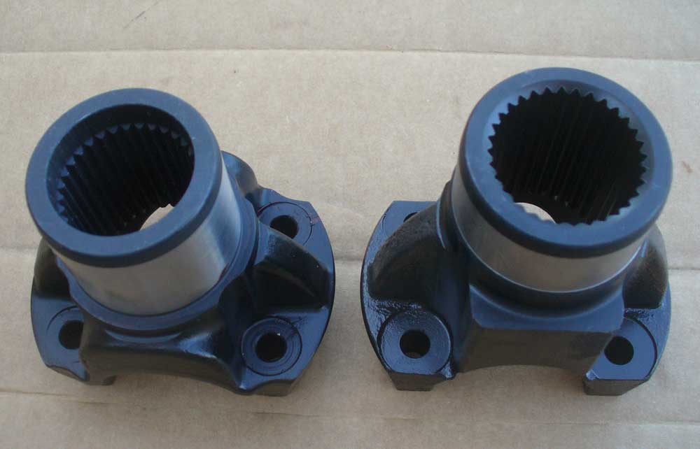

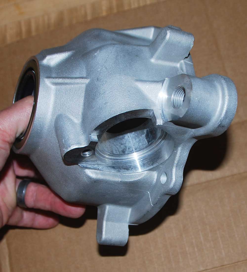

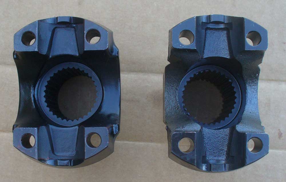

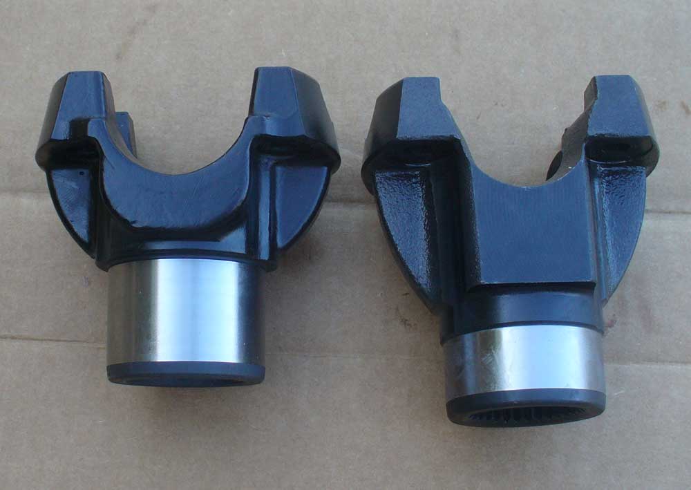

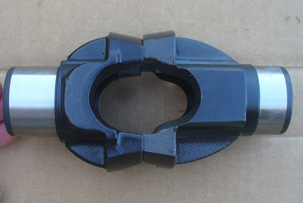

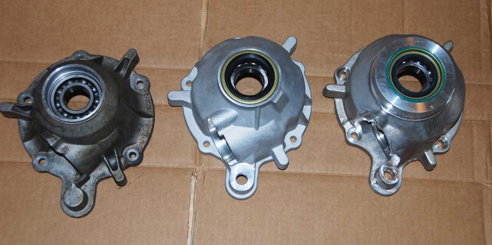

First up is a comparison of three output housings, the factory late model housing, the JB Conversions housing and the Advance Adapters housing:
And:
And:

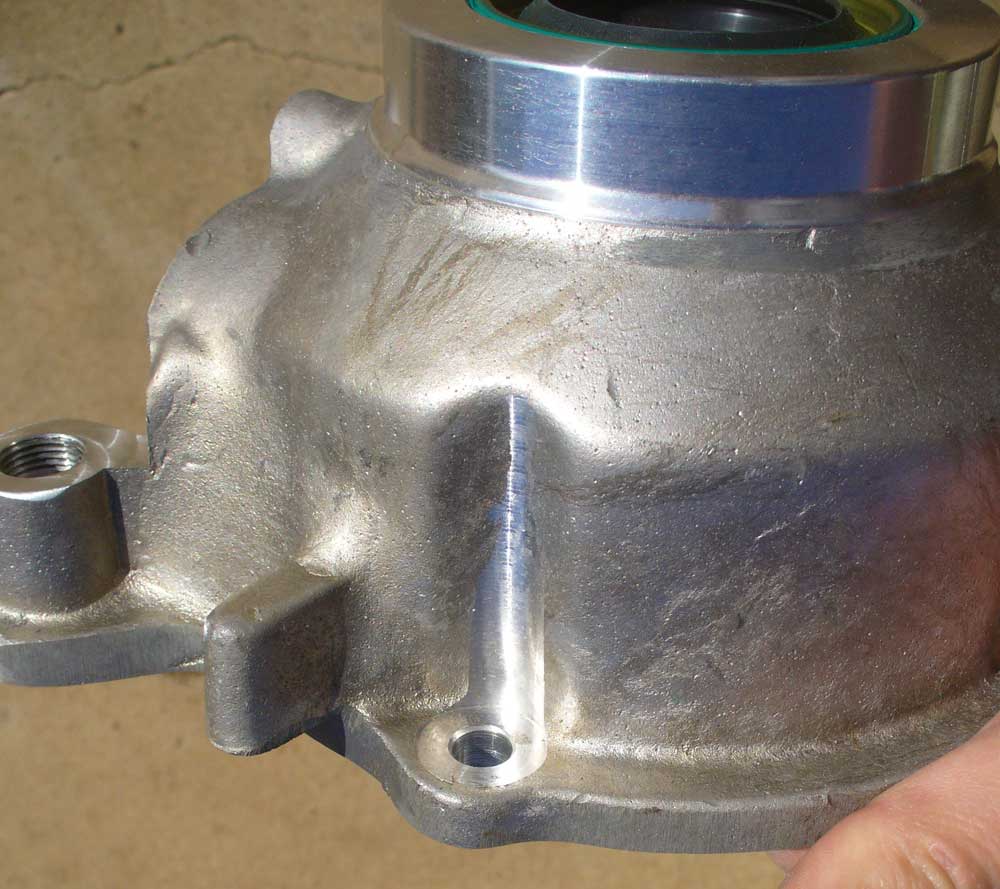

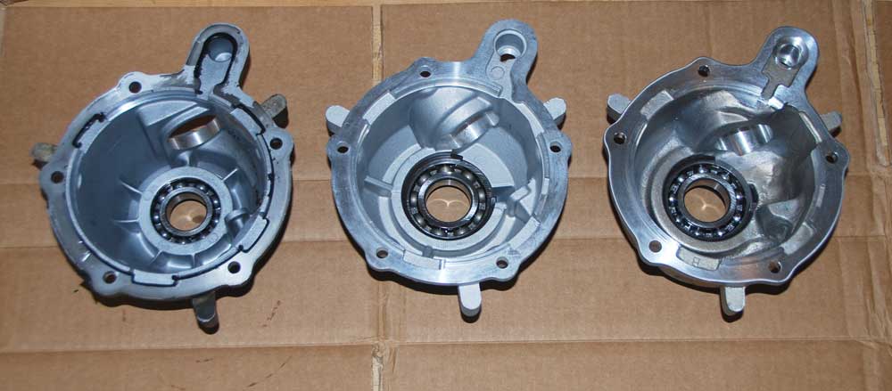

Here are the different oil return channels, factory late model:
JB Conversions:
Advance Adapters:

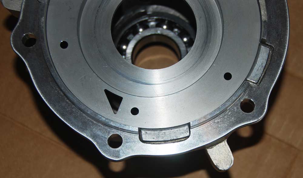

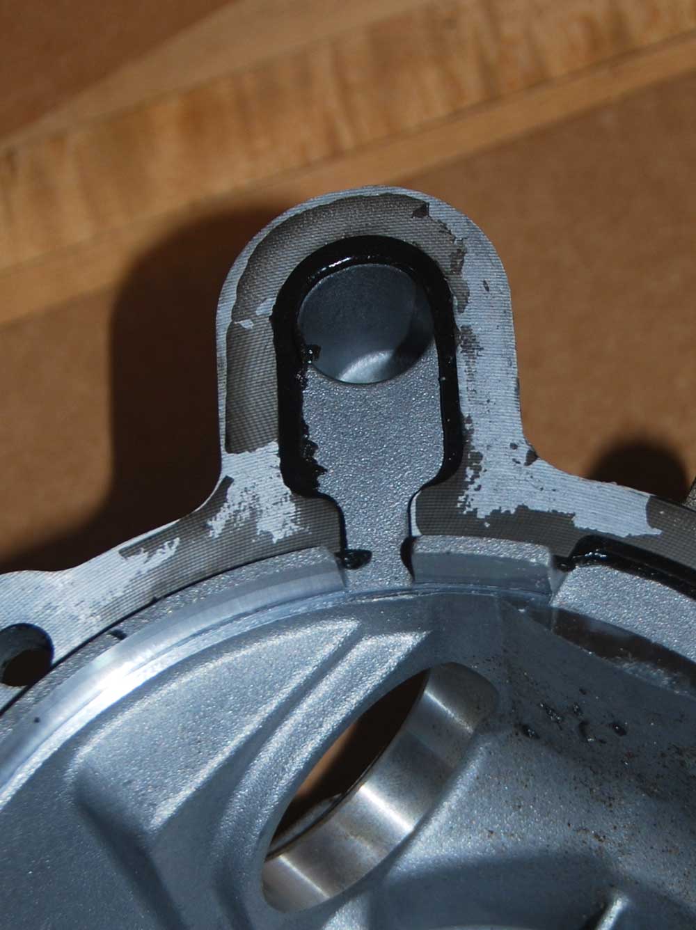

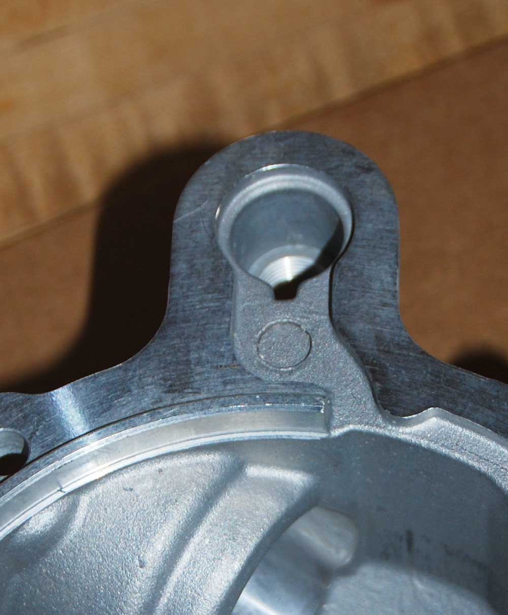

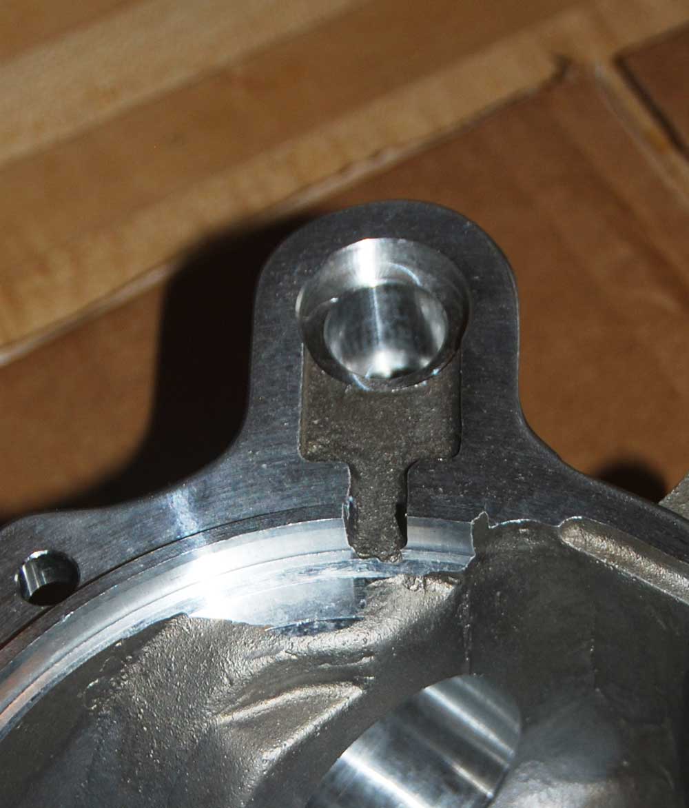

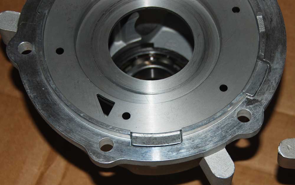

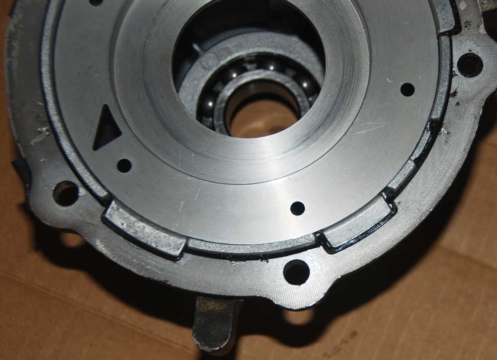

Here are how the oil pump tabs register, factory late model:
JB Conversions:
Advance Adapters:

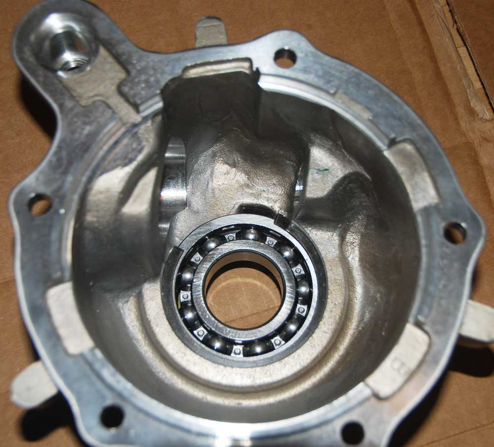

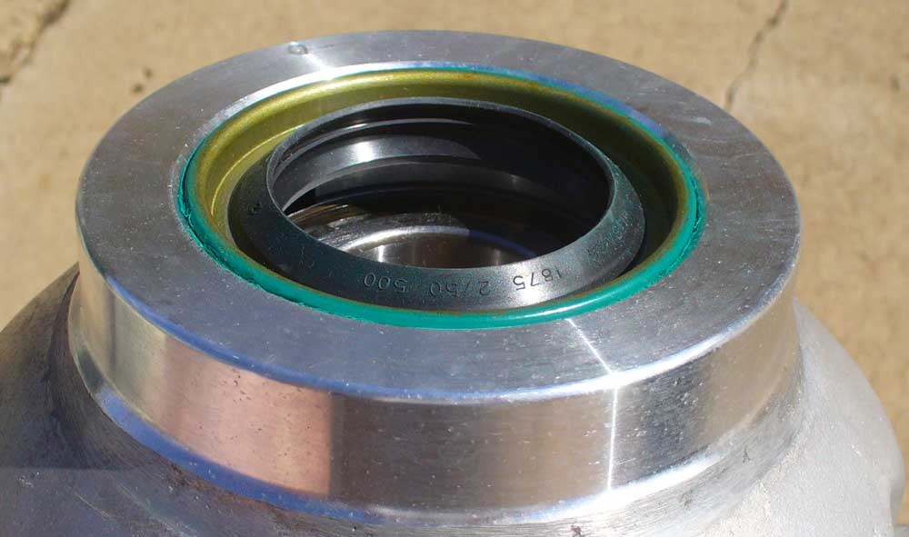

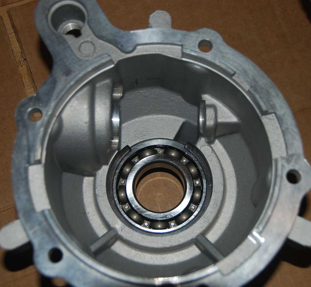

Here are how the rear output bearings are supported, JB Conversions:
Advance Adapters:

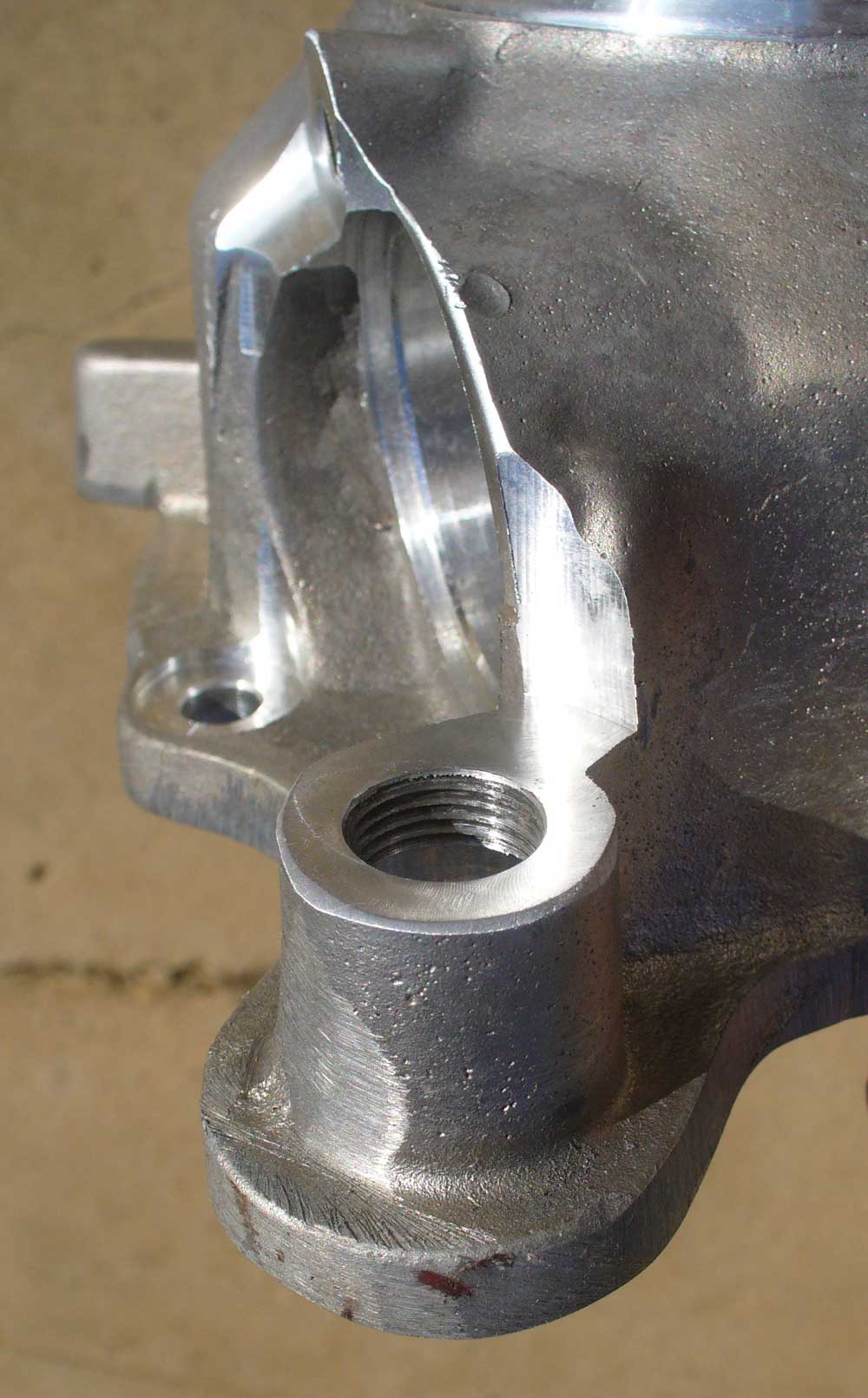

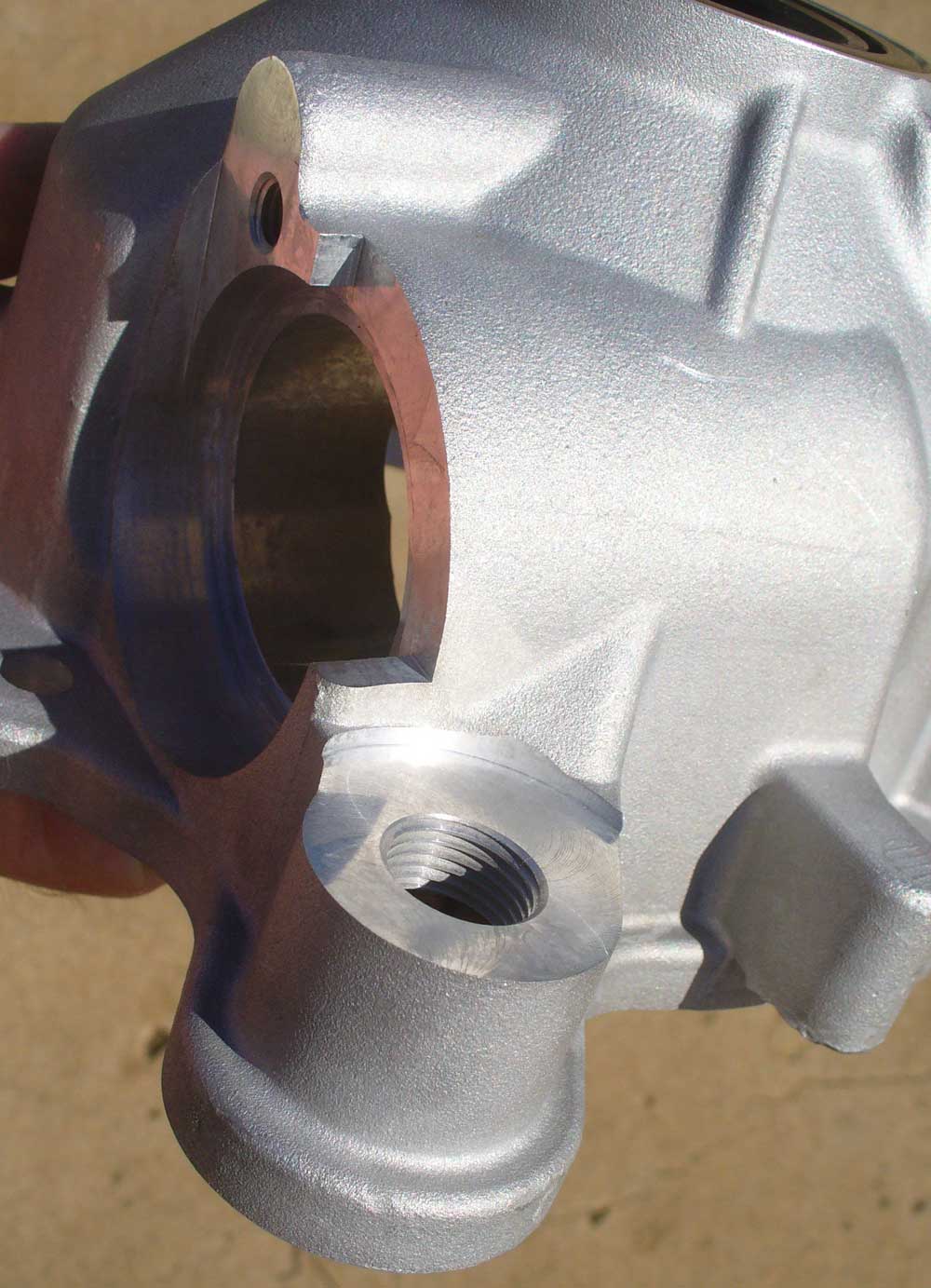

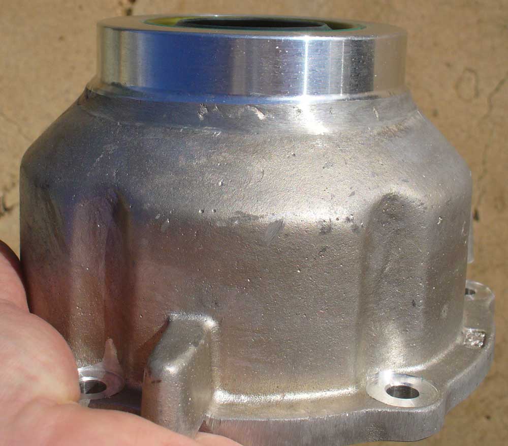

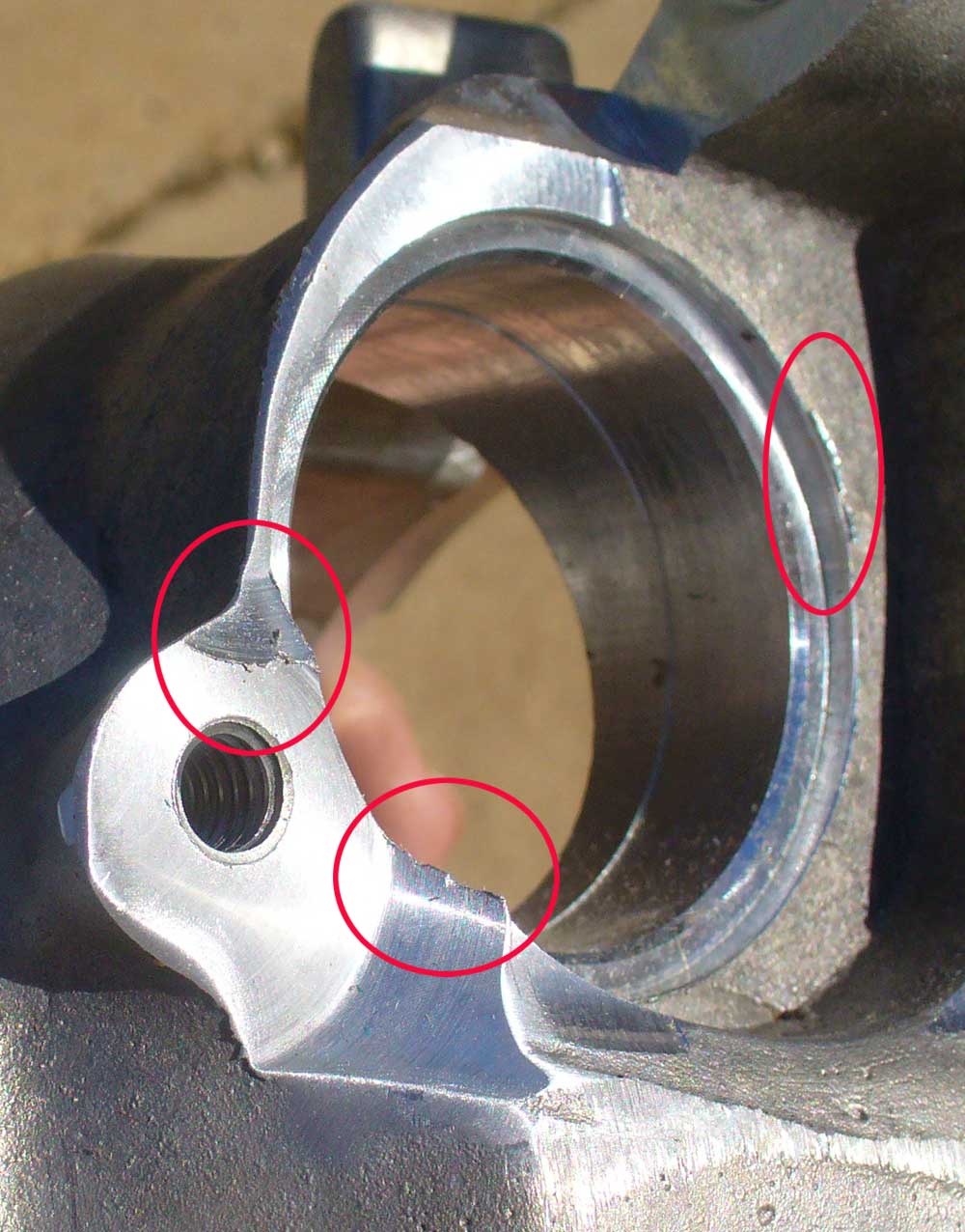

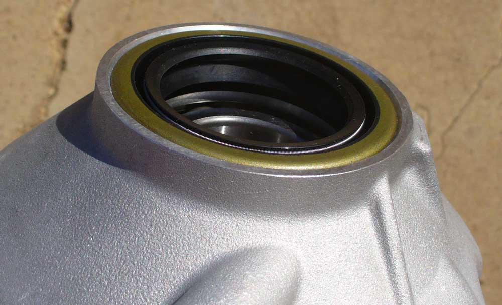

Here are a couple of side views, JB Conversions:
Advance Adapters (note the rough machining around the speedometer mount and the threading):
