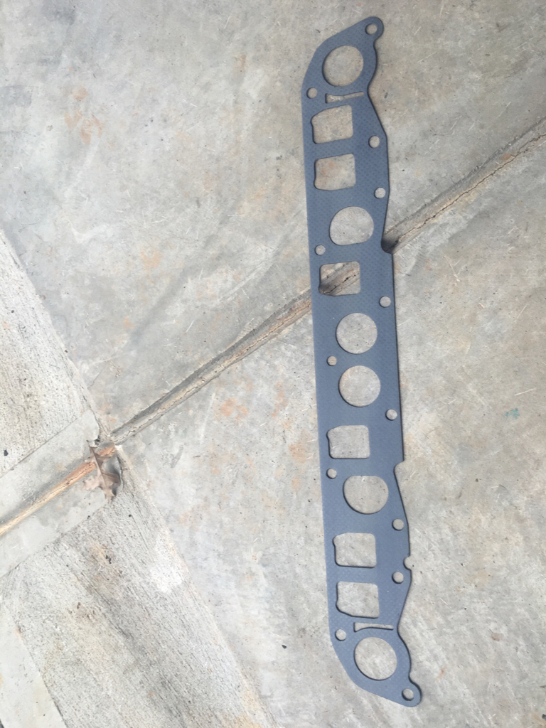

I've read a few threads showing the words "manifold side" on the replacement exhaust manifold gasket, showing a correct installation direction.
I'm my case the manifold gasket is a simple stamped piece of gasket material. Like a stamped washer, one side is the "sharp" side, and the other is more rounded.
There is no directional marking. Is there a correct side to place against the head vs the manifold in this case?
If I had to guess, the flat side would go against head, and the more round side would go on the manifold.
I think it would only matter if there was something like a copper ring around the edge. All my motorcycle gaskets have that and it's usually the ring away from the motor, IIRC.
Thanks. There is no ring here. I recall seeing those crush rings on motorcycle base gaskets but not on this one.
On what you have; I'd use the flat side onto the head, and the bulging side outwards to receive the header bolt-down torque installation. As most FSM's suggest; one must provide an In-Service-Check, i.e., a re-torquing of the header nuts, some hours, or miles down the road as per; to FSM's values.

Well crap. It's in there now - got it in last night.
I copper coated it and honestly things went pretty smoothly, albeit a few grunts and getting dirty.
