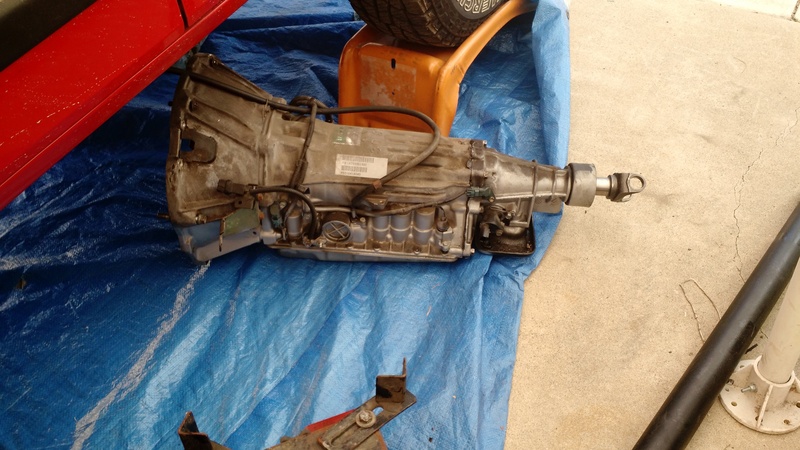

Out with the 2wd junk.

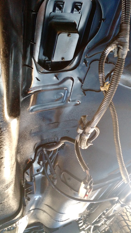

The underside of this jeep is as clean as the top.

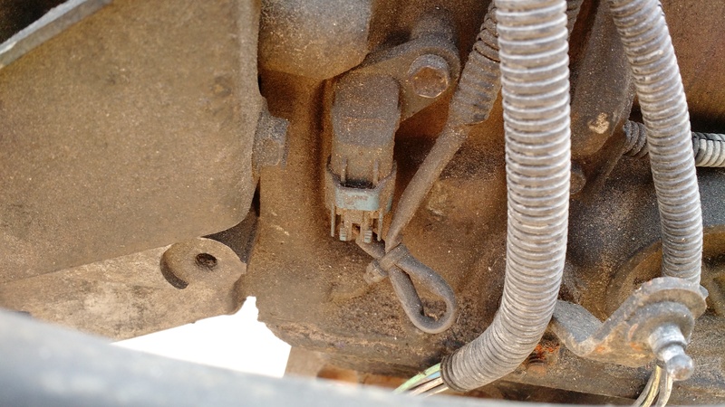

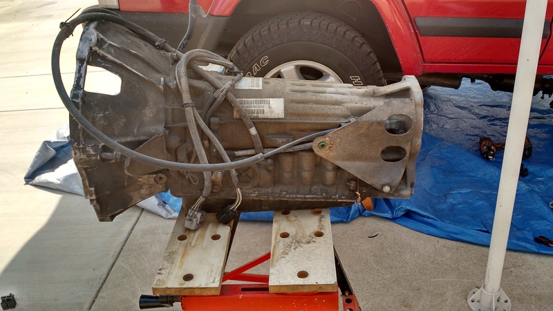

The irritating input sensor that causes 98+ guys so much drama finding a trans. grr.

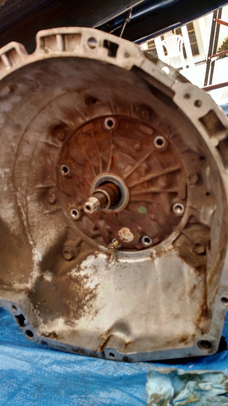

The dipstick tube on the new trans was jacked up, so I ended up swapping the pans between them.

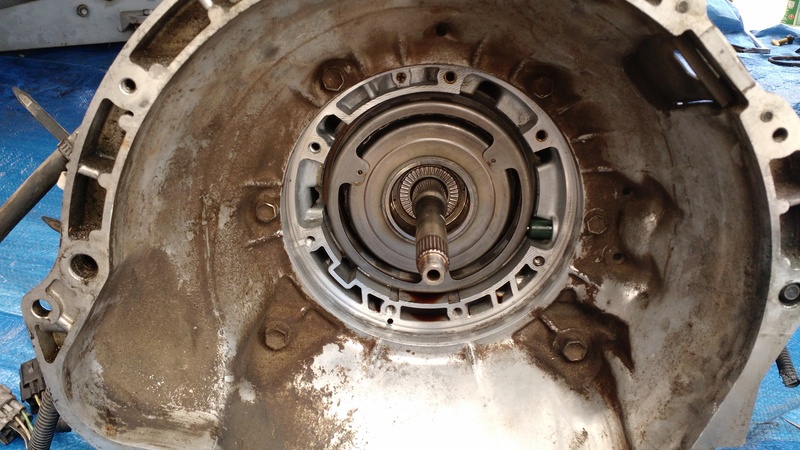

Got the trans installed (no photos) and found that once the first torque converter bolt was in, I couldn't turn the engine over at all to get to the 2nd bolt. Pulled it back apart and found the pump was totally locked up! Possible we didn't seat the torque converter right, but I've installed aw4's about 30 times now and am pretty certain this was not user error.

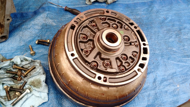

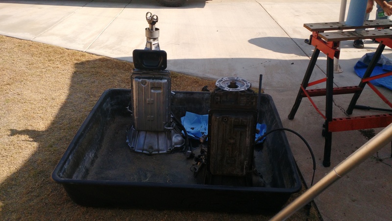

Pulled it all back apart, and swapped pumps between the aw4's.
Careful with these bits here: you bump them, and they all fall out. A pita to put back in.
Making absolutely sure I know how the pump and TC mate up before re-assembly.

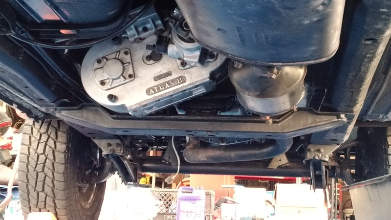

Went digging around in the garage and found the spare Atlas from 4643, and toss'd it in there.
Didn't take any more photos from there, but managed to scratch up a driveshaft to fit, get all of the wiring done and am just about back on the road. No shifters or front end yet, 4 wheel drive will come later.
