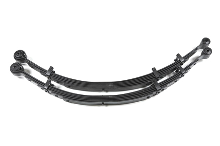

Bryson's build thread lists those as 3" OME's ..... Looking at pics of the OME leaves on their site..... No bends.
I'm gonna say those bends come from bad shackle angle putting down force on them.
Na, Dutch is right. They're IRO 3.5" leafs which have a bend to them. I ditched the OME's a while ago. So far no issues, although I really need a traction bar (the OME's ended up forming an S).
The shackle angle is great ass. ;) :guitar:
