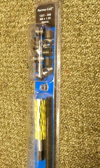

Tim i picked up a kit at oreillys. It came with the tap, a hand full of coils, and the coil insertion tool. All i needed was the drill bit. Find out the thread pitch and size of the bolt and many auto parts stores have helicoil kits.
This is the kit i used.
You can see on the back the instructions and the bit size needed for the kit. I used some red locktight on the incerted coil to semi lock it in place. I let the locktight cure before reinstalling the caliper. I also used a qtip to clean out any excess locktight after i incerted the coil So it would not interfere with the new bolt being installed.
I also used cutting oil on the tap. It was pretty straight forward. Whole process toock about two minutes. Then just waiting for the locktight to cure overnight.
