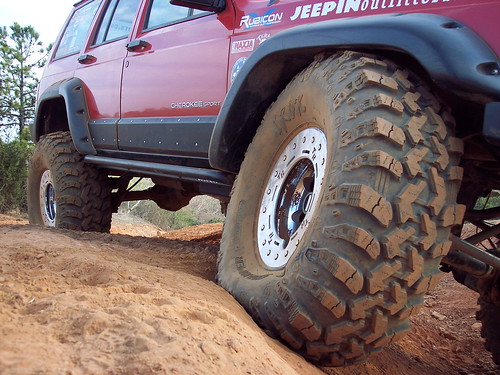

Do you mean something like this:
Thats Forced rear flex in that pic.
