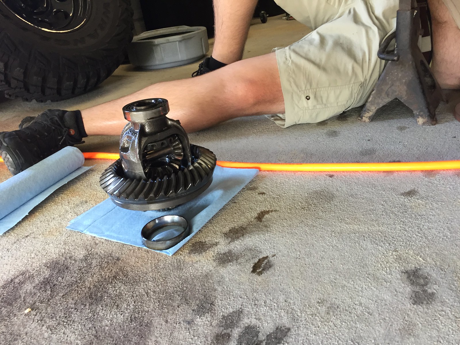

Monday night I loaded up the axle. Tuesday after work I set about regearing it. It took 5 tries with backlash, 2 tires at pinion depth and 4 tries of pinion preload but I am very happy with the outcome.

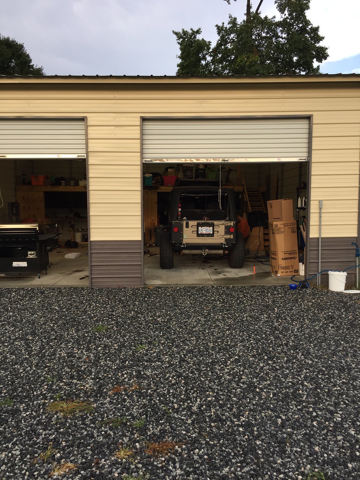

Nice where you get the metal building? I emailed Capitol about one today to put on my girls property in Camden.

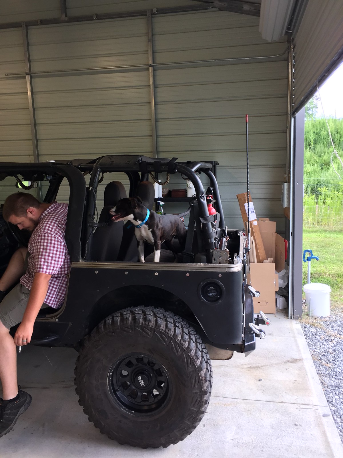

A buddy of mine (fellow club member/coworker) bought a house with this shop on the property. We're slowly filling it with all the tools we need to complete any task that comes our way. A tubing bender is right at the top of the list. Just need to do some more research on brands/types/etc before I buy.
I am sure you have done a bunch of research but the only reason I went with a JD2 over a rogue fab was shipping. JD2 is in eastern TN. When I get somewhere I can have a large air compressor I'll upgrade it to a air/hydro setup and make life easy....
How difficult is it manually bending? I've only ever used air over hydro
