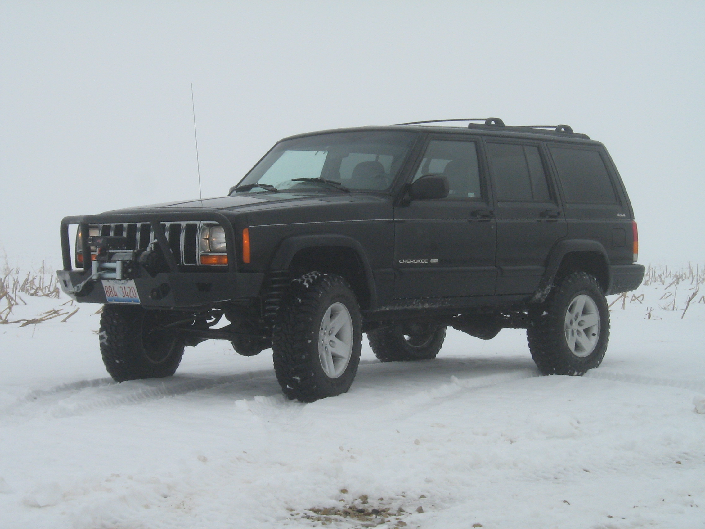

a Pic of my old XJ, and the new one;
OLD '96
NEW '98, work in progress
