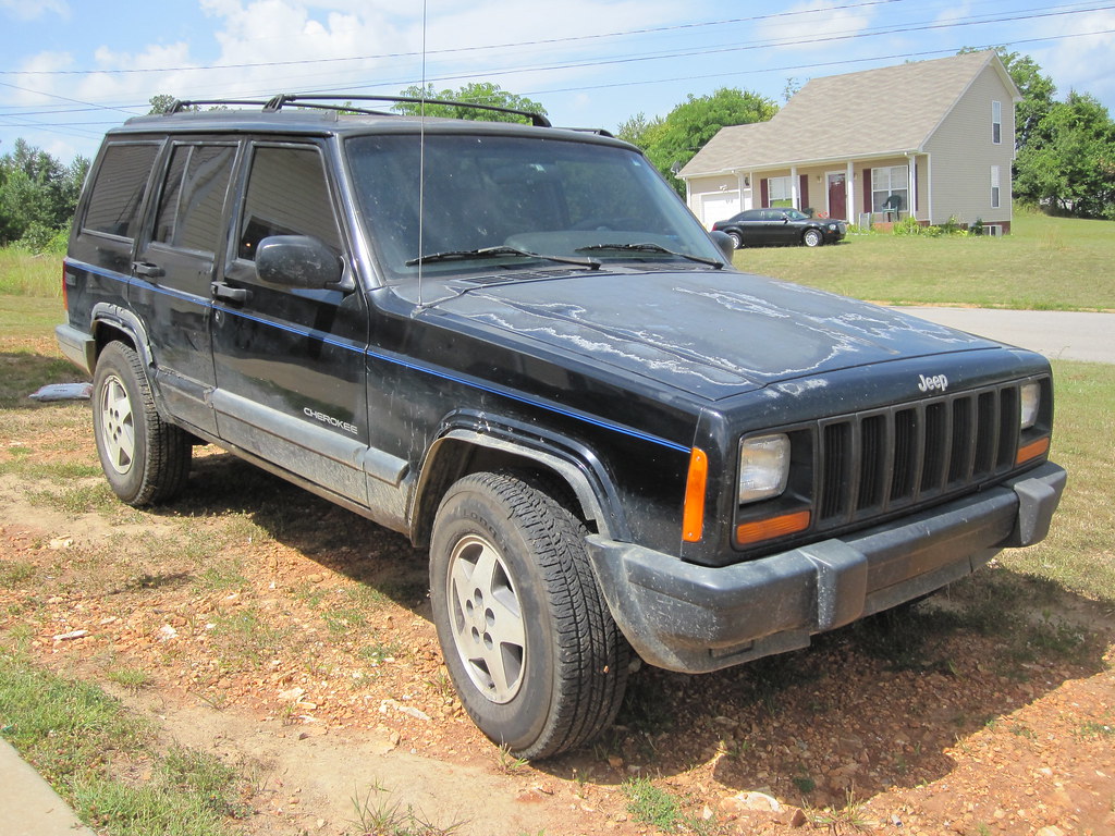

BEFORE:
Not just any ZJ rims...but '93-'95 to be specific. '96-'98 were much nicer!

Let's see it!!

So, you started a thread last week...
Said "Stand by"
Then posted one picture.
and made one comment about 2wd to 4wd conversion.
This is quite possibly the most frustrating thread I've ever read.
