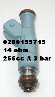

If there is a need for more flow one can use the 96-98 Taurus/Sable 3l V6 DOHC injectors, 0280155715 256cc(24 lb ).
These are EV6 without clip nut and flow exactly the same at the FMS M9593-A302.

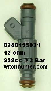

Or 2001-02 Camaro, 2001-04 Corvette LS1 injectors 0280155931
which flows similar (wee bit less) but does have a clip nut. Both will out perform the older 24lb/hr EV1.3 FMS-M9593-A302 injectors.
