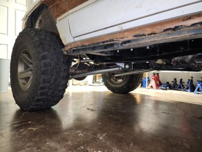

Had frame stiffeners and a StinkyFab long arm kit installed a couple weeks ago.

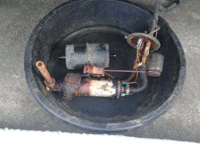

Inline fuel pump was no help, except to confirm that the dash fuel tank level gauge was lying (Gas tank was not full, it was 85% empty or more). My son helped install it and a day ago we installed (mostly my son) a new Renix Fuel pump assy in the tank.
Also replaced the FPR. Now on to getting it to actually run again. Wish me luck.
It served it me well. Not sure of it was the 1987 FP, or one installed before I bought the jeep in about 2005.
May my old Renix FP friend RIP.:
