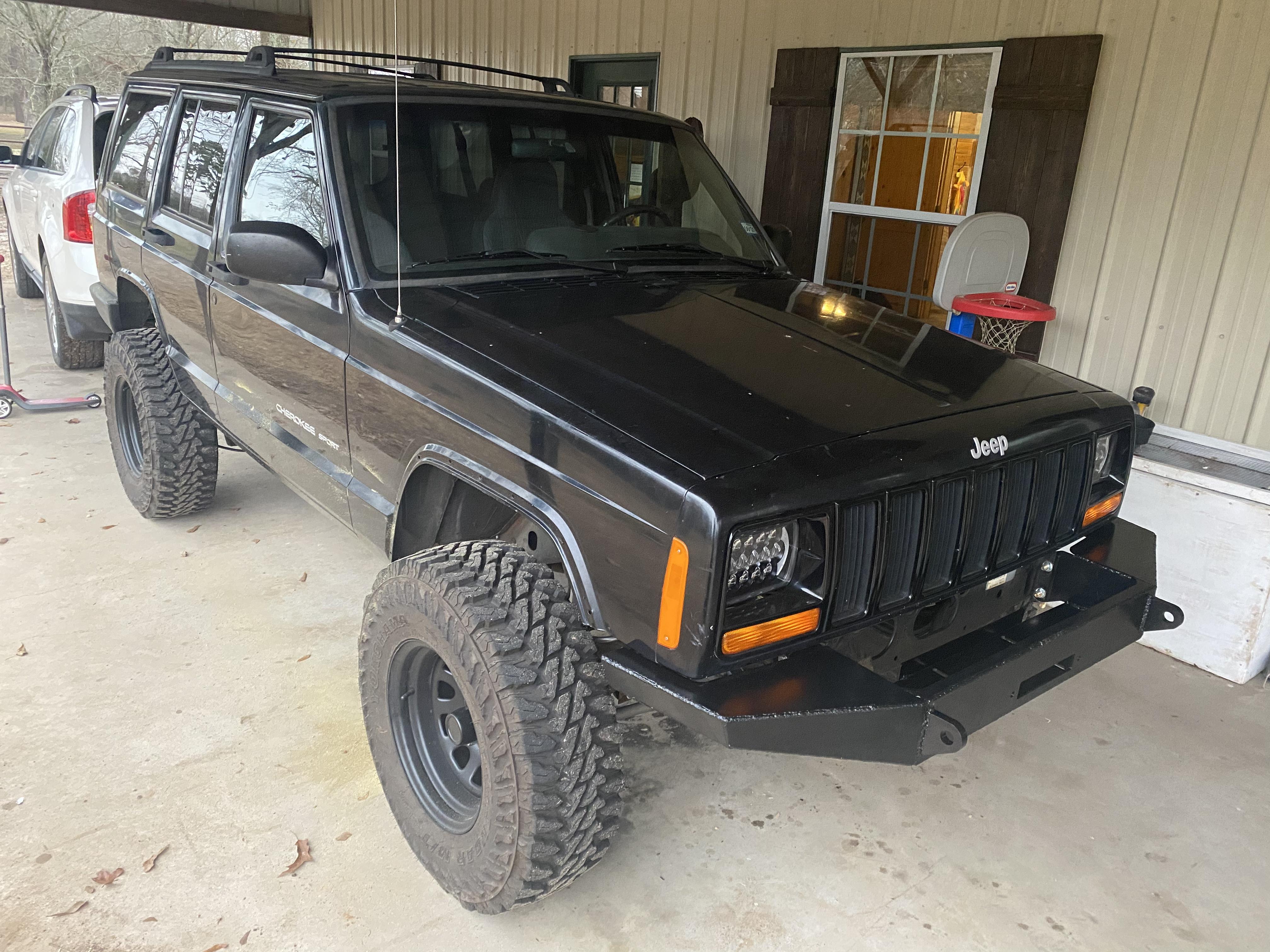

Got the DIY bumper finished up and installed.
