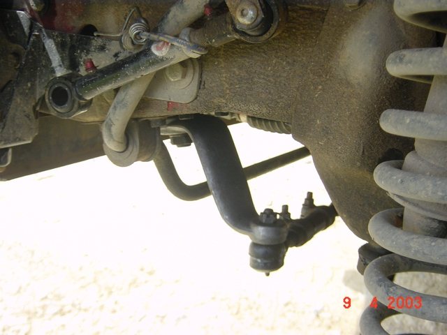

I 've been using a couple of those elastic tie-down, hooked cables.
See the picture below:
When not in use, the free end attaches to the safety clips of the tow hooks.
