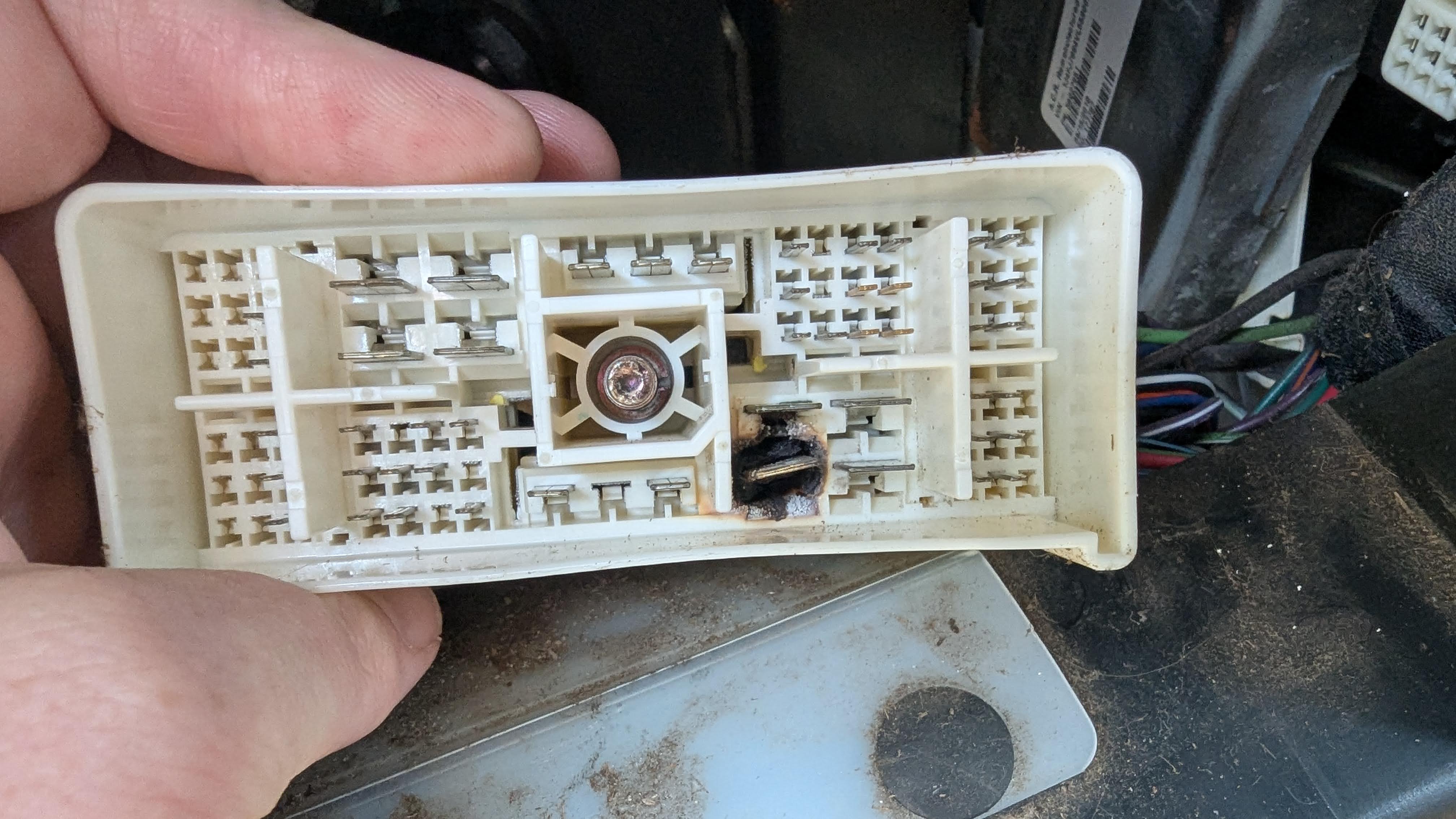

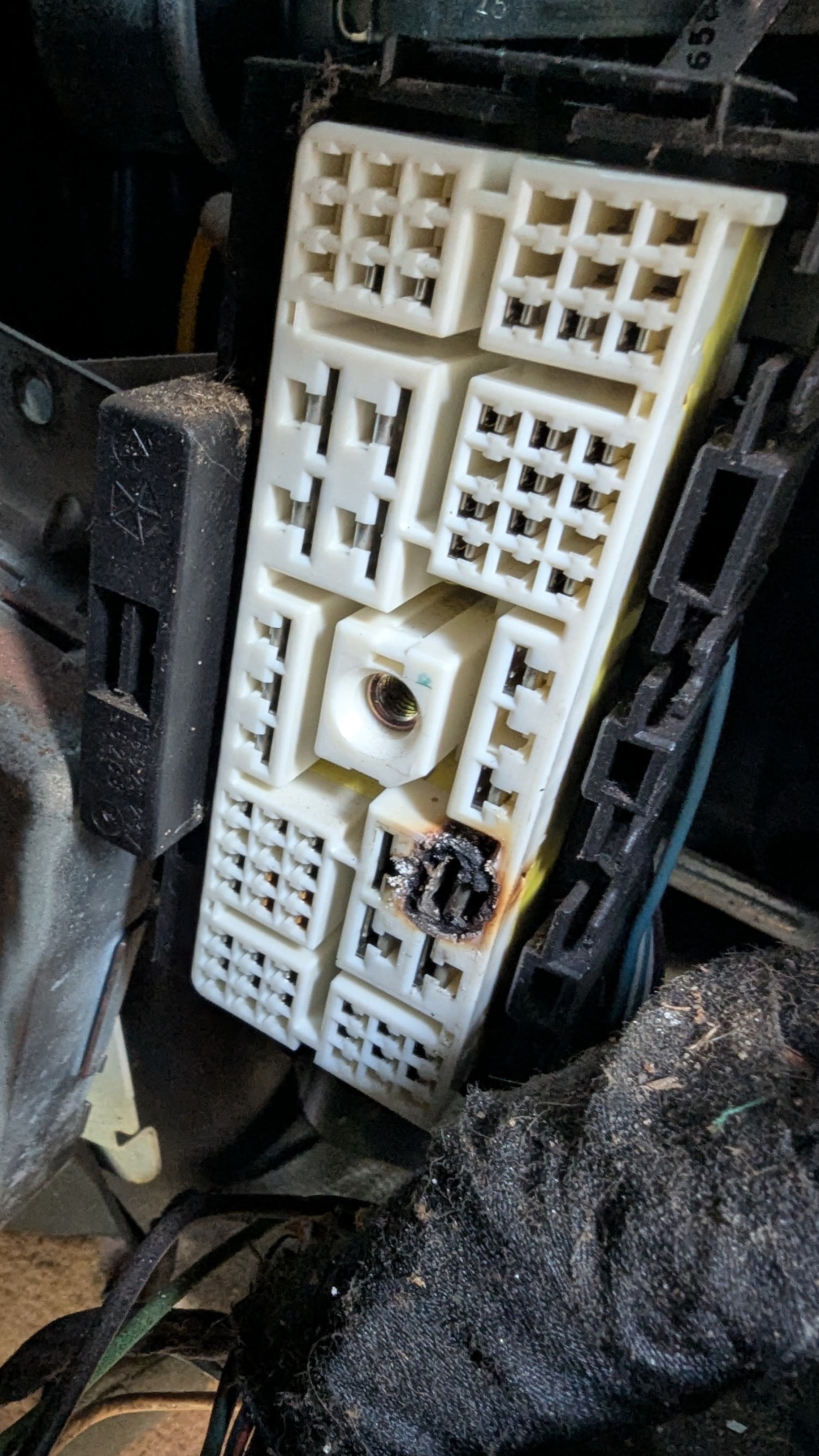

What is this burnt electrical connector
What year is your XJ? Where is the general location of this?
It looks like the C201 connector. It connects a lot of stuff. The burnt pins appear to be for the ignition switch. (Ignition Output Start/Run
Edit: Wait, had the orientation wrong. Looks like pin 11, blower motor feed.
If blower works, should I just rock it? Through some electrical grease in there?
