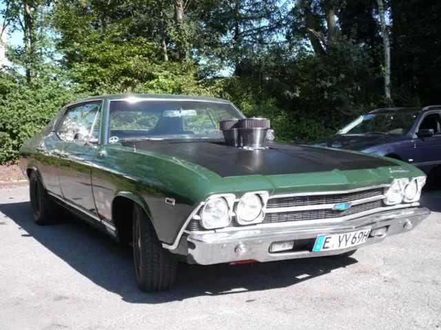

No one seems to know much about velocity stacks and if they will make any change, I will let you know as I am working on one and yes it will have a filter and fit under the hood unlike 96Sportxj's Chevelle. Thanks for the replys.
If it fits under the hood, it won't do much.
