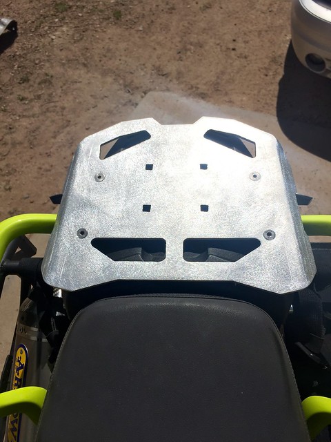

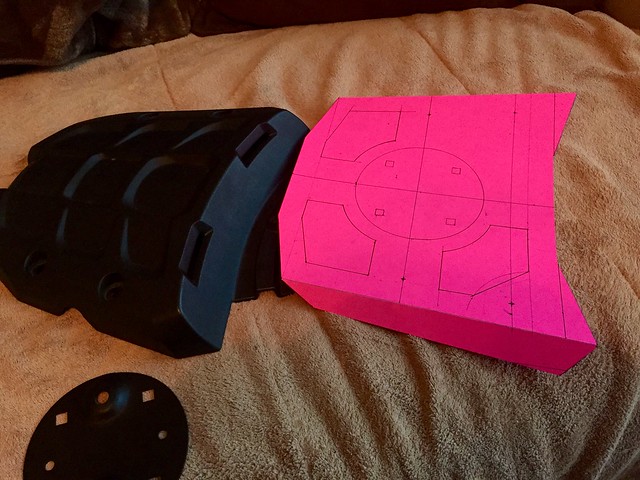

A few weeks ago i made a posterboard template for a rack/plate to mount a 1 gallon rotopax to the back of my bike. Went down to the flopshop this weekend and had jon cut me out a prototype on his plasma table, made a few changes, then cut the final piece out of 1/8" aluminum
I just need to do a little cleanup here and there on it then paint it.

I agree. That looks tidy and handy as hell for that kind of bike application. Hell, offer it up as a flat space as well for someone to mount whatever they'd want to on it. Looks killer....... as does all the stuff you put your talent toward.

As far as marketing the cargo racks, there are a lot of companies making them, and they arent super expensive. I just didnt like the size and shape of alot of them. I wanted something small and sleek that would be hidden once the rotopax was mounted.

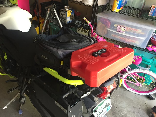

I found some time this afternoon to paint the luggage rack i made last weekend. I also added door edge guard to the back to prevent my tailbag from chafing on it, and added to rub strips for the rotopax to rest on so the texture paint wont get rubbed off.

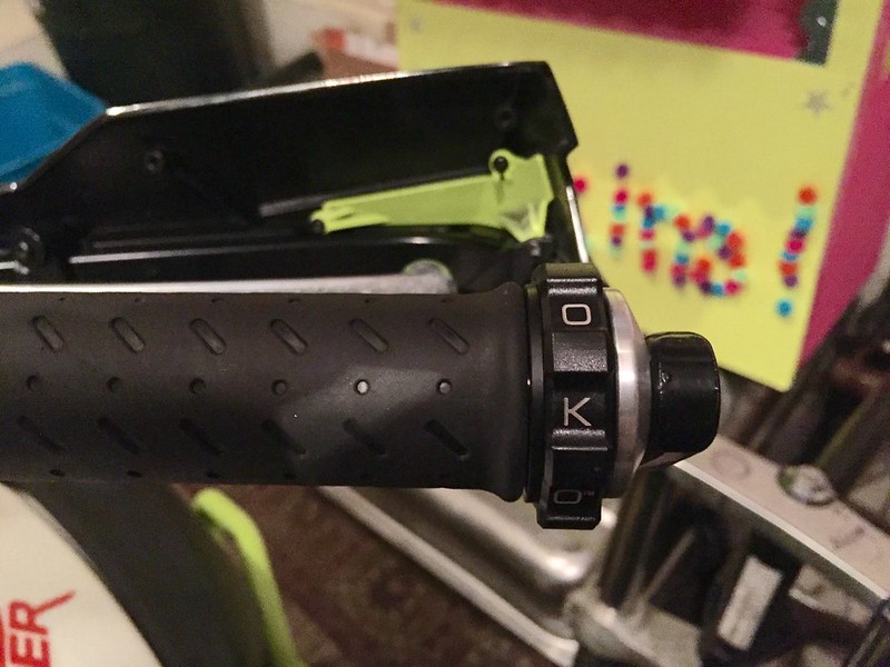

And last but not least, I installed a Kaoko throttle lock/cruise control. This is probably the thing im most excited to have on my bike for the upcoming trip.
Cruise makes all the difference in the world. Those legs are a lot wider too! Feel more stable standing up? Tall guys off road sucks man. Everything is built for 5'8" guys.
