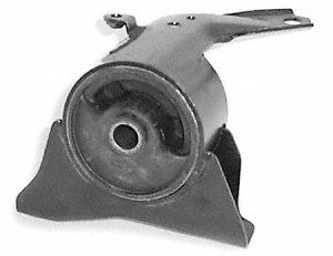

Here is a crappy pic of all 4 mounts. There doesnt seem to be a void all the way through but figured filling any type of recess might help longevity.
This seems to be the mount that fails on my car. You can see what looks like thinner webbing in the middle of the mount. All 4 seem to have this issue/recessing.
And a used one
