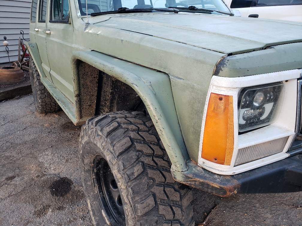

92 with 4.5 inches on 31s here. Only minimal body modifications - cut-and-fold rear quarters, and front fenders trimmed to a 97+ style line to allow the bumper I bought to fit (a pre-Crusader JCR Stage 4 with side protectors).

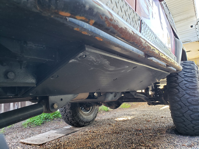

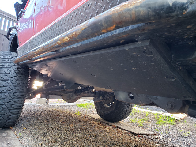

I went with .5" thk UHMW and added supports under the long spans (near the bottom and center). Grainger had best price when I bought. It has a high COE so make sure you account for thermal expansion in your mtg holes.

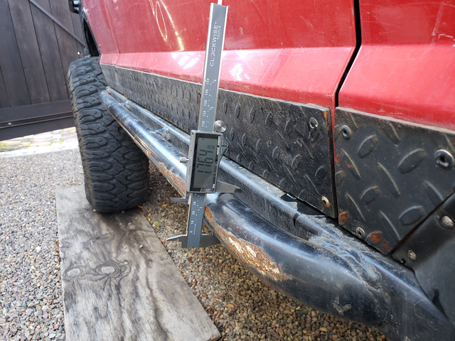

Rub rails are 1.75 dia x .188. Pretty sure about the .188 but I forget, def not .125. They're holding up fine and glad I added them. And, fwiw, the bends were done on the cheap HF pipe kinker.
Depends how you wheel, but I personally wouldn't go thinner than .188 on the 2x6. If I had a mostly overland rig then maybe .125 with the UHMW skids and rub rails.
B pillar cage tie-in doesn't exactly line up with an outrigger. I think ended up adding a support plate under the cage tie-in and welding it in.

I have been thinking about adding tube rockers, I like the 8 inch wide idea, good door protection, and a nice step to access the rack. I am thinking 1/4 inch, yeah it does add more weight, But I reason it is low down weight, kind of counter balancing my roof rack gear. I hate being top heavy on off angle grades.
Nice red XJ! Thanks for the photo of the UHMW skid you have mounted. Is the UHMW skid metal backed? Where do you get it? What is the name brand? (UHMW is a whole class of plastics,so I am not sure what to get).

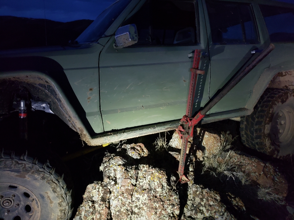

I did the rockers on my last XJ with .188 wall 2x4.
I used .125 wall 2x4 for my current XJ
The silver XJ had an RE 3.5 inch lift, the maroon jeep has OME 2.5" lift. The jeep gets used for overlanding and hunting but the most likely thing to contact the rockers is the high-lift jack.
I'd like to see pictures of all the mangled .125-wall rockers. I have not regretted cutting back at all.
