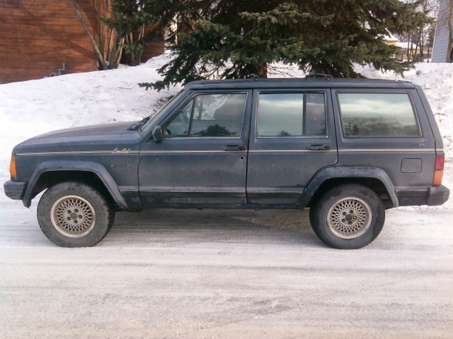

I'm new to jeeps but have always wanted one. and recently I bought a 90 cherokee limited.

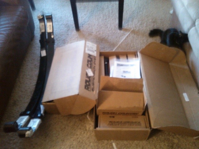

And after a bit i have a brand new 4.5" RC x series lift sitting on my floor.
Heres the jeep for those interested.

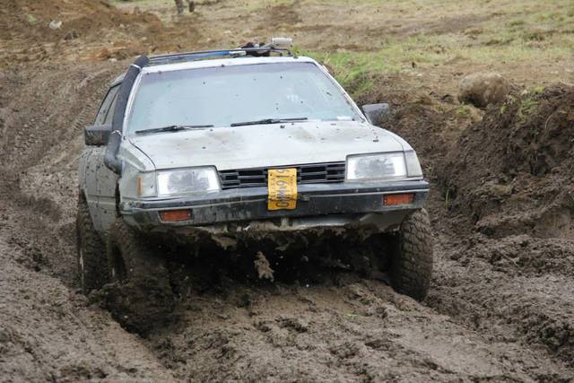

Also I'm not a noob at making huge tires fit where they shouldnt, case in point; 85 subaru wagon with 30" KM2's on 2" lift.
