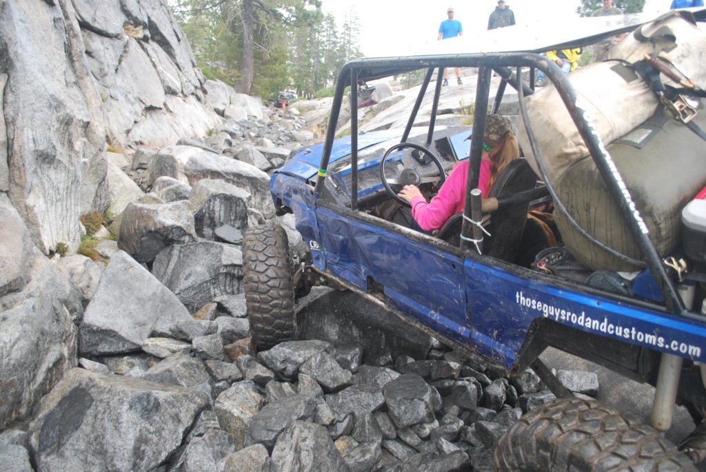

Yeah I am undecided on the panels. I wasn't sure on them but I do like having them on. Keep alot of the road crap, water, and mud we ran into out of the inside. Also keeps straps/coats, etc from falling out.
The final skins will be different. Want to have them look like a XJ.
anyways it did pretty well this weekend. Happy with the end result, no glass.

Went down to CO to some friends place for a fun weekend. The duct tape is just from the trailer ride home and last weekend:
Badlands 2 weekends ago resulting of the use of duct tape:
back to CO, finished off the driver's side:
and after a day of super tight canyons like this:
the panels had to be re zip tied multiple times:
So until I either learn to drive better, which is doubtful, I probably won't spend a whole lot of time on body panels. :D
