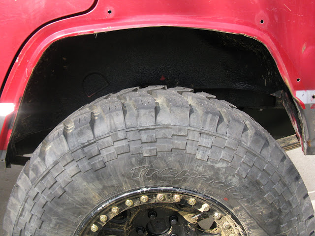

The XJ I have was trimmed by the previous owner. I don't really understand if it was done correctly or not in the rear.
I wheeled for the first time today with the 35's and the rear needs some trimming. Anyone in the Charlotte area interested in schooling me on how to do this? I'd pay for lunch/dinner and/or beer.

If it's the red one in the build thread link in your sig then it looks like it was just trimmed back to the spot welds. You could probably do the cut and fold and get about another 1/2-1" in the wheel wells. Best thing to do is snap a pic of the wheel well from the outside showing the body lines and then one showing the inside of the wheel well and we'd be able to tell you real quick.
This is a good sugestion. Snap some detailed shots. You can also see how I hacked mine! :)

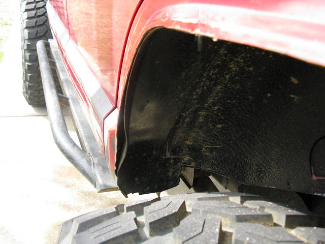

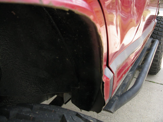

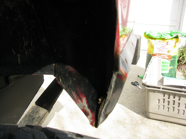

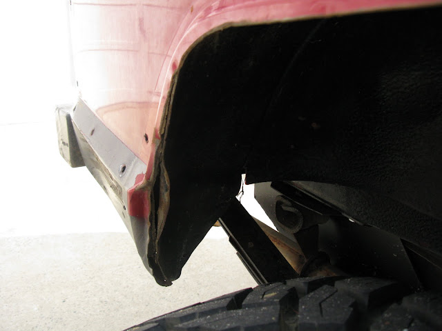

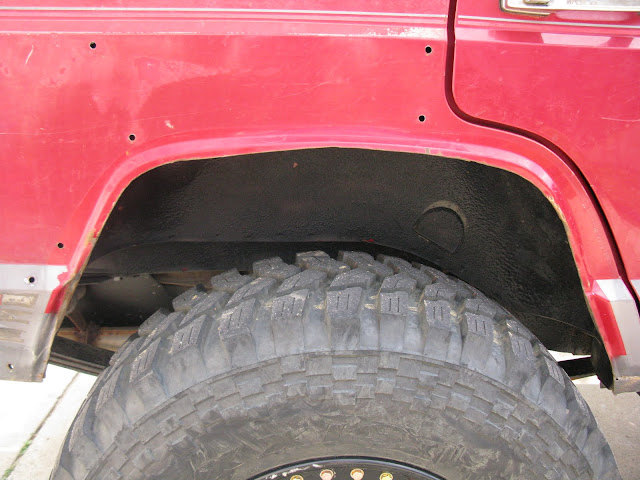

Hope these help.
Wife approved the purchase of the newer Bushwacker flares. Once I have those I will need some guidance on where exactly to trim.
Ouch! That is bad. They cut it and did not fold it. That is bad IMHO. You need to weld those two pieces back together. The bushwakers will get wasted on your first trip out.

When most of us do the cut and fold it's usually cut little slits in multiple places from the inside of the wheel well going towards the body all around it. Then when it gets folded over it gets folded to that body line that the previous person decided to cut to, so that leaves you with not being able to trim anything else off unless you want to re-weld the wheel well to the body (which looks like it needs to be done in some places). It looks like you could also benefit from doing the rear 1/4 cut and fold so the tires will stop hitting the back lower portion of the wheel well.
