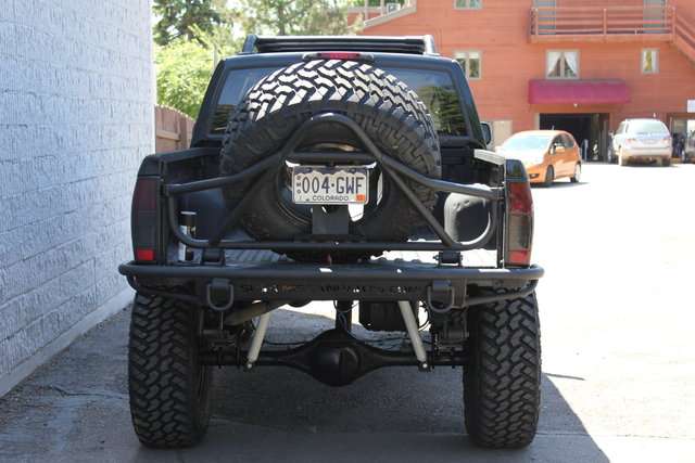

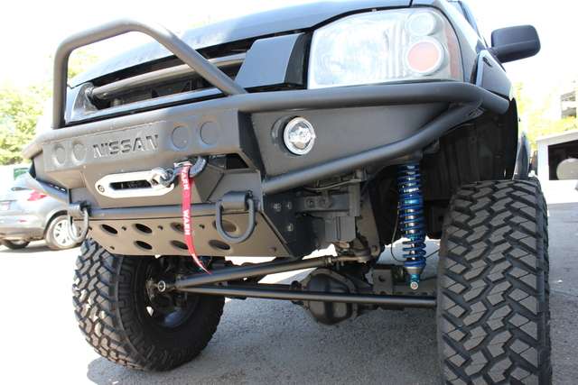

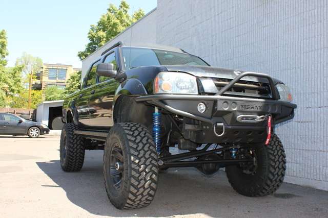

That first hardbody looks nasty. I like it. You build em for fun, or for selling?
