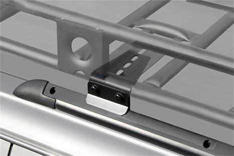

Another option, Garvin has a mounting kit for their basket that hooks into the stock tracks (part #28011) which they will sell for $100 (per an email I got). It looks like a pretty sturdy setup, but I don't think it will work with the Yakima Load Warrior due to the differences in basket construction, and the fact that it bolts directly to the basket instead of intermediate rails.
https://www.quadratec.com/Assets/Installation/26926.pdf
I don't see why you couldn't make your own rails with that system. Cut some rectangular tubing to length and drill some holes in it and you have your own rails. Might be nice if you could weld caps on the end. Might be nice if you could add in some tubular inserts where the bolts go through (reinforcement for thinner wall tubing).
The advantage to the Garvin mounts is that they would appear (assuming their drawings are close to scale) to be a couple of inches lower (closer to the roof) than would be the Thule mounts. The Thule bars end up being an inch or two higher than the factory bars.
something I just discovered, Smittybilt Defender racks have a track mount for XJ that looks alright from the pictures, #DS5-6, but the year interchanges are all goofy and half the pictures are for the gutter mount feet, so I don't trust the catalog info. http://www.smittybilt.com/docs/installation/DS5-6.pdf
