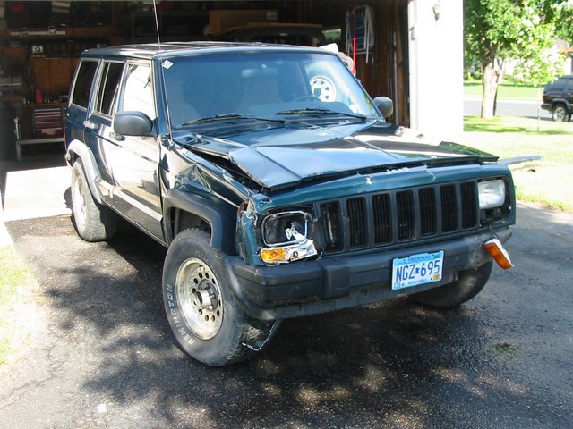

Well all the work I’ve spent fixing this xj up to be a daily driver. Ended up wrecking it today. It’s still fixable front quarter panel is going to need replacing. Along with another new set of control arms and another new set of tie rods. I swear by the time Im done I will know just about everything there is to know with this vehicle.
I bought the 98 as wreck about 8 years ago, with about 180,000 miles. I fixed it the garage, and drove it for another 100,000 before the engine blew.
Yours was worse I got the panel apart. It messed up my front lower control arm bracket so I ordered another and a lower control arm as well. Gonna order a front drivers side fender then I should be good.
