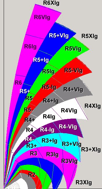

I found a pic of the turn descriptions:
As you can see from the image, there are also lg (long), Vlg (very long), and Xlg (extremely long).
