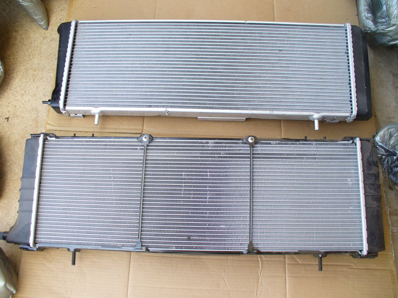

I went ahead and bought both radiators.

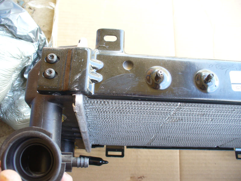

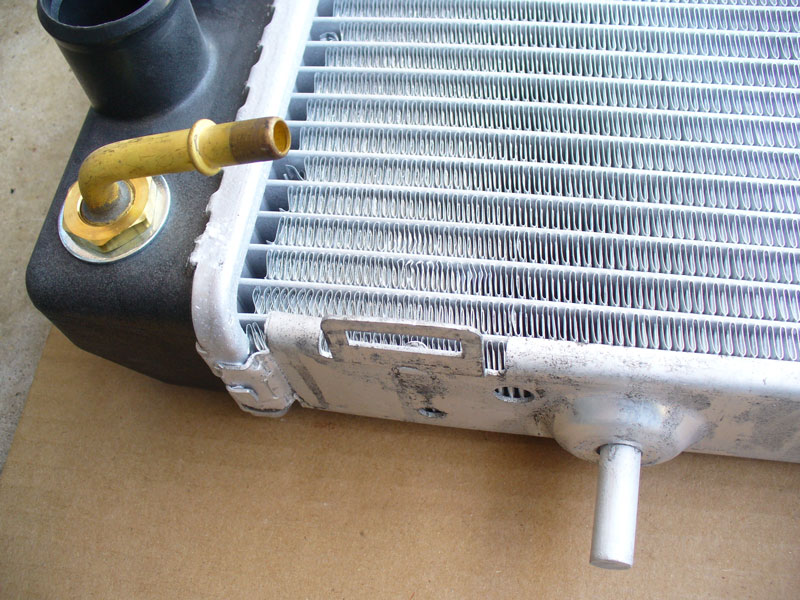

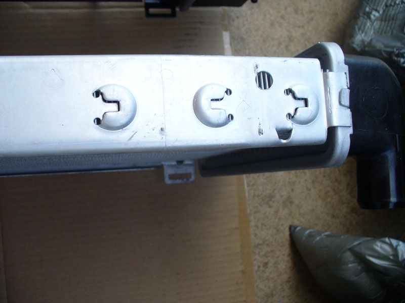

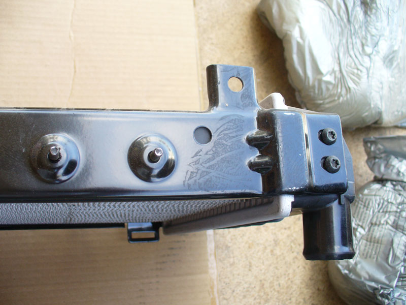

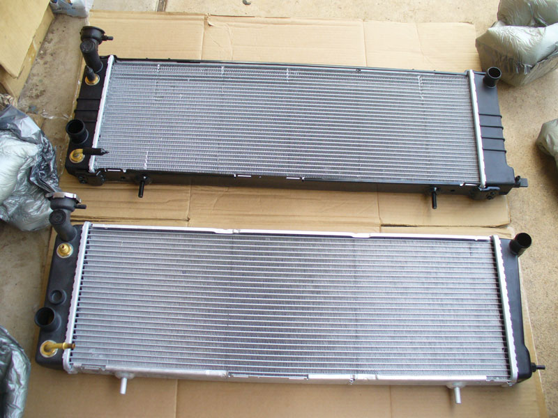

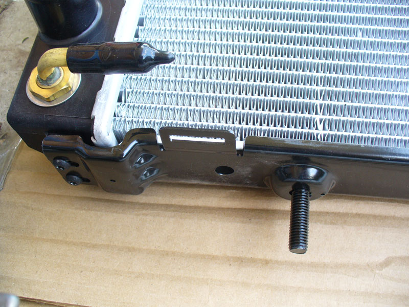

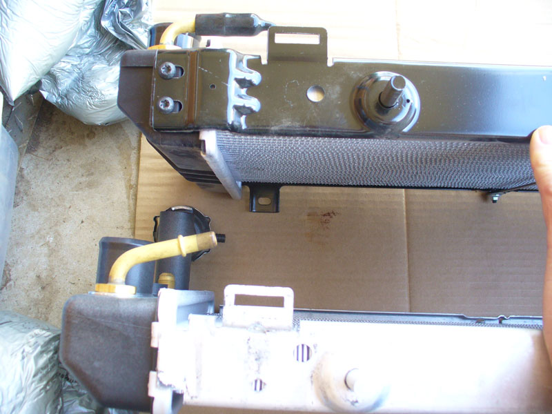

Here are pics for the sake of comparison. The 52080104AC is the one which is bounded with steel mounting top and bottom, whereas the 5191929AA has aluminum mounting points top and bottom.

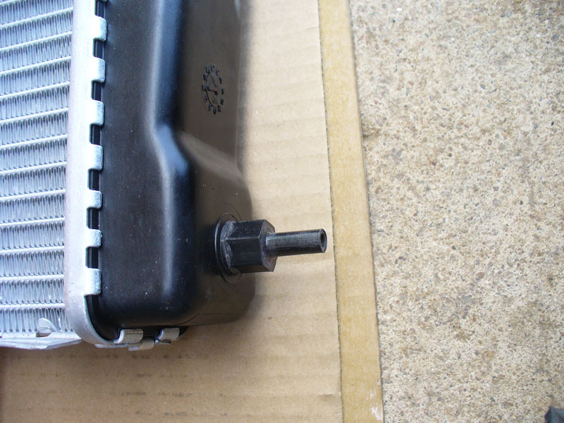

It looks to me as though all the important features are the same. I am not sure why the pins on the bottom of the 52080104AC are threads, but I don't see why that would prevent me from mounting it. I would wonder though if there isn't an improvement to be made in the mounting when I swap over?
I haven't pulled the top mount off my existing radiator to compare the use of the already present studs vs whatever it is that clips into the aluminum one, but I am betting I can make that switch. Again however, I wonder if there isn't a particular piece of hardware I should be looking for in order to accomplish that most gracefully.
It would appear that the reason to switch over to the 52080104AC is because it is a dual row core. I can't photograph that difference, but I can stick a finger in the tank and feel it.
Does anybody see anything that would preclude use of the 52080104AC ('98-'01) radiator in a '96?
FWIW, both of these are made in Mexico.

I know in the late 90s to early 00s there is a change for the lower transmission cooler fitting, some years use one style while some years use the other. I am not sure what the exact change is and yours are both the same... :confused:
90 down use a radiator with no filler neck as they have the filler on the expansion tank, 91 up use the style you have there.
I have always just ordered whatever and made it work. They fit in the same spot and the only difference for me has been that lower trans cooler fitting.
I left the rubber caps on the one radiator. I probably should have pulled them off before taking the pics, but yes, they are the same on both radiators (other than a slight difference of angle which I expect is a matter of tolerances).

The 52080104AC fit perfectly. In fact, if I were to have tried to run the "correct" radiator I would have needed to figure out what hardware was required at the top in order to mount the isolator bushings for the upper radiator support (rubber bushings between the radiator and upper support sheet metal). I don't know if a previous owner changed something on my Jeep, but I was grateful that the 52080104AC had the studs in place to mount the isolators. I expect earlier years have some sort of stud on a clip that fits in the slots on the radiator, but I don't have those and don't know what they should look like.

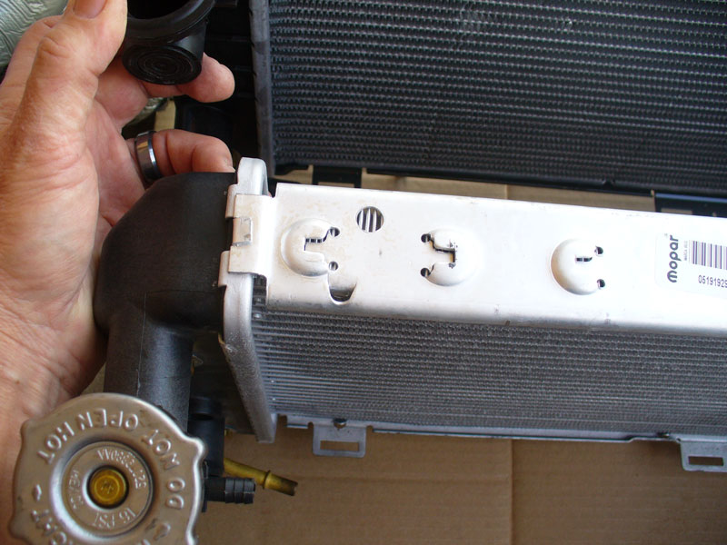

I bought the MOPAR 5191929AA radiator and found it to be quite different. I've been on the phone with the dealership and still can't find what I need to run this radiator.
The new radiator doesn't allow me to use the old bracket that bolted to the radiator and to the condenser to the radiator. It doesnt have the existing standoff's on the plastic end tanks to bolt that bracket to it. So I'm not able to remove the studs and mount it with the radiator up top. I found someone with a '00 (year of the part number), and he has the Same setup as my '98 had. So i guess this is a max-cool setup. It seems like the previous poster from me has the setup i need.
I have that radiator bracket resting on top of the old one.
When I replaced my OEM with a HD CSF I removed any brackets from the OEM over to the HD CSF. Your new radiator appears to have three different permanent bolt connections, not quite the same as the old radiator. I would try fitting one of the bolt connections to determine if one of them lines up. Possibly you can make your own bushings if needed for the top and possibly the bottom if missing.
IIRC correctly the radiator is bolted at the top using a cover plate that possibly mate with an A/C condenser. May have bushings on the top and should have some rubber bushings the radiator sits on underneath.

I have a 91 XJ, and having moved to southern Arizona, found my cooling system wasn't up to the task. I bought the 5191929AA to replace/upgrade the 26 year old radiator, and ran smack into this same problem. The answer was pretty simple, however. The studs on the original radiator are M5-0.8, so I got 6 M5-0.8x25mm flat head machine screws. I used a large, flat-head screwdriver to gently pry the notches a bit wider to get the head of the screw started into the notches. I have a short piece of aluminum bar-stock that I used as a punch to avoid marring the top of the radiator as I tapped the screws into the notches to press them into service as studs. They did want to spin when tightening the nuts, but I was able to hold them with pliers. Turns out the that 25mm was too long, so if I were to do it again, I would get 15mm screws, but in my case, I just cut them down. The need for hardware should not deter you; if you can install your own radiator, you can install this radiator. :)
