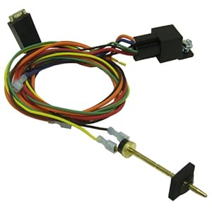

Hayden Temp Probe
Yes I'm going to do this too - you can get a Hayden Temp probe which goes through the radiator between core tubes in many different temperature settings. I will use the probe to trip the oem relay in my fuse block for the fan.
I have not started this yet so I'm not sure if I will have to "flip" the signal from ground to +12v with a bosch relay.
Either way, I'm with you, and it will also turn the fan on sooner than the PCM is - which I feel waits until things are already a whole lot hotter before finally engaging. I think I will try the Hayden 3652 - they do have adjustable ones also.
