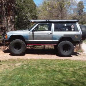

My 94 XJ with 250k is having some overheating issues that I cant narrow down and I'm about to throw in the towel and take it in to my mechanic.
Running around town the temp is fine and stays between 195-210f. Highway speeds is defintely hotter than i'd like to be at, and any kind of hill climb makes the temp gauge shoot up to the last mark below the red. At that point turning the heater on full blast will usually settle it back down to the 240f area. I live in Southern California so those of you that live here know the hwy climbs I'm talking about. I5 North going up Castaic, or I5 South Grapevine, but it's not just those, it's any kind of incline that starts making the temp skyrocket. This has been a problem for awhile. Add summer temps into the mix and it's just constantly running way too hot even on flat highways.
My setup
RE 3.5 lift, and 32's on stock gearing.
CSF Radiator (2670), Flowkooler, 195 tstat
New hoses (they arent collapsing)
New ZJ clutch fan from Napa
I've flushed the system and completely burped the system of air
I've tried 50/50 and 30/70 distilled water to concentrate mixtures
Efan is fine
And the mechanical fan shroud is intact.
The last thing I did this weekend was attempt to change the temp sending unit on the engine block out with a new one (Mopar) and now it seems to be reading at a higher temp than it used to. The dash gauge is now saying it's idling at 210, and will get up to 225ish at which point the efan will kick on. I've taken temp gun readings at the tstat housing and at the rear of the block where the sending unit is and it checks out to what the gauge is displaying. It sounds like the old sending unit was bad and this one is reading closer to what i'm really at.
At this point i'm wondering if I have a cracked head, or a bad head gasket, but i'm not seeing the obvious signs. My Jeep mechanic made the suggestion that it could be my gearing, but I don't really agree with that since it's ran hot even before I modded it years ago.
Any thoughts on what else I can do?
