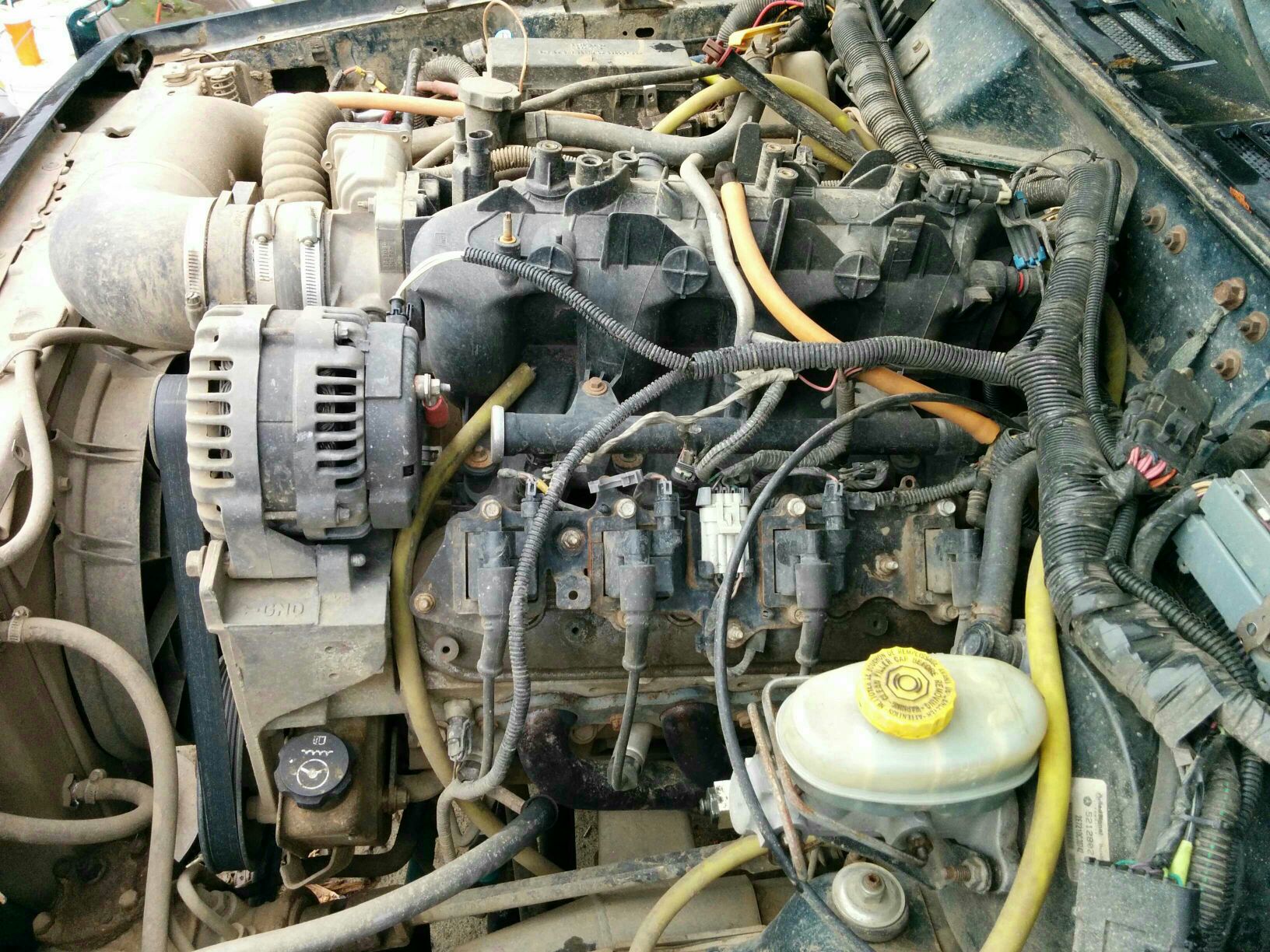

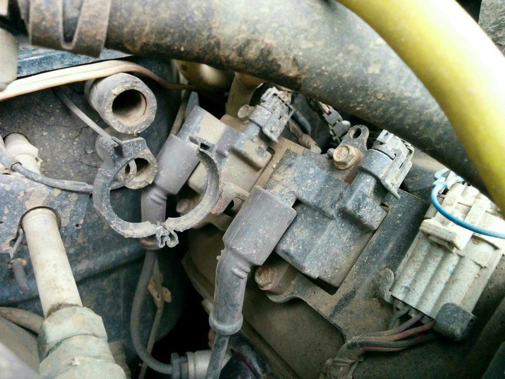

My setup is set 1/2" forward over your engine. I wasn't comfortable with the amount of firewall clearance I had so I decided to move it forward. One of the header bolts on the driverside was ~1/8" from the firewall not to mention the coil pack that was really close to the heater hoses. I'm much more comfortable with the fitment now.

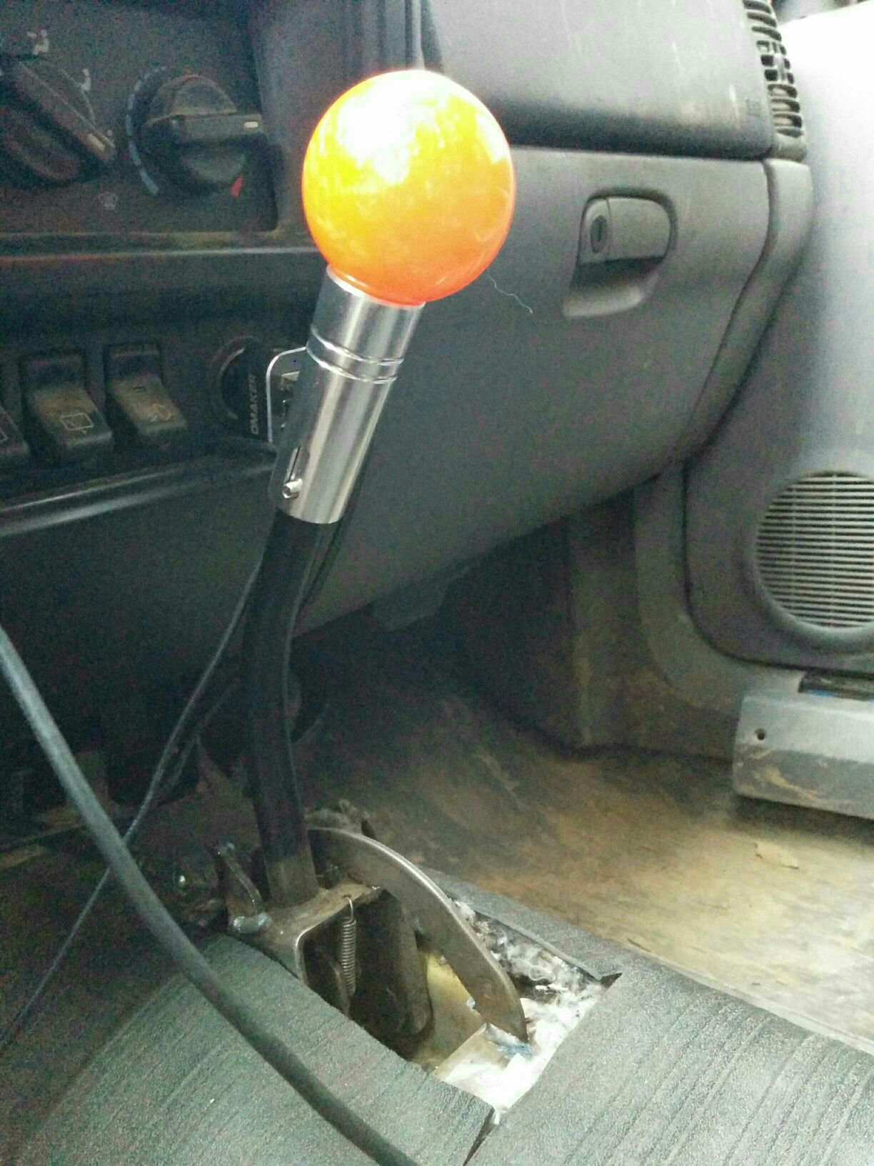

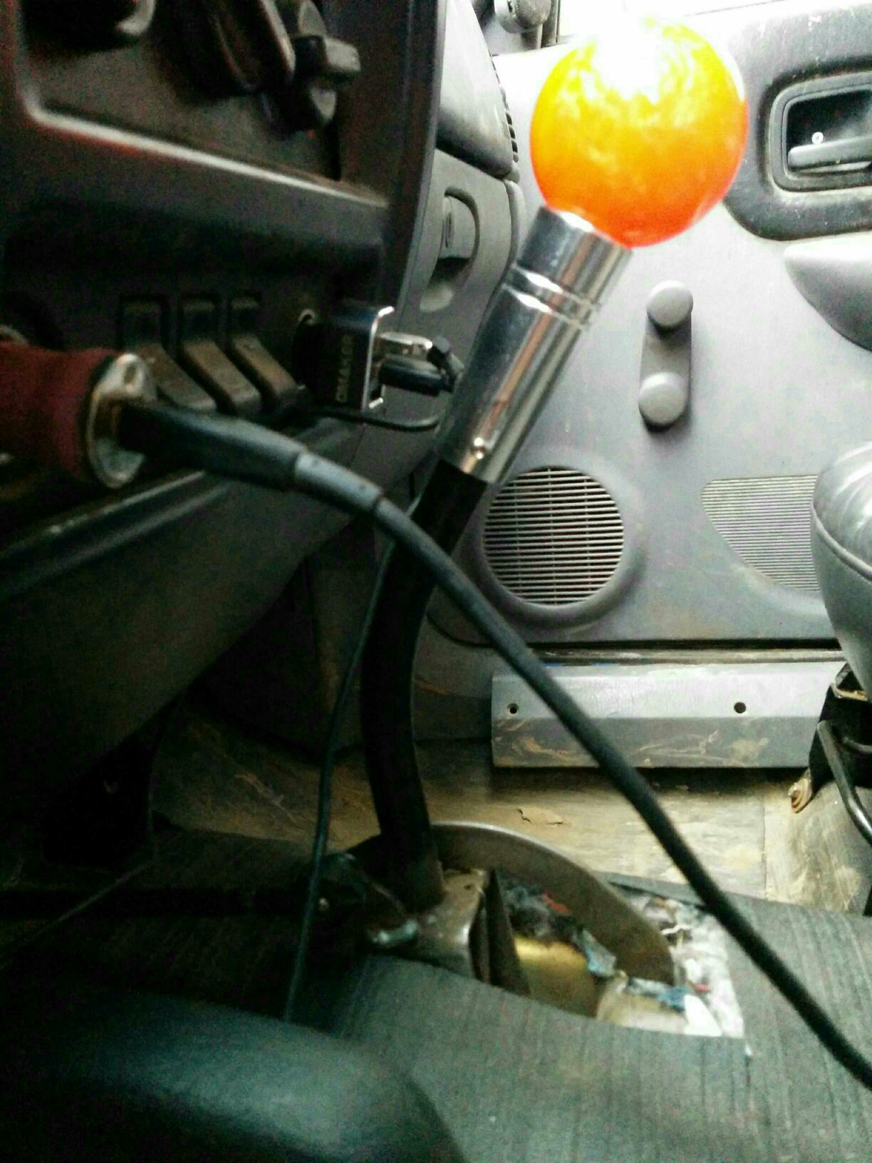

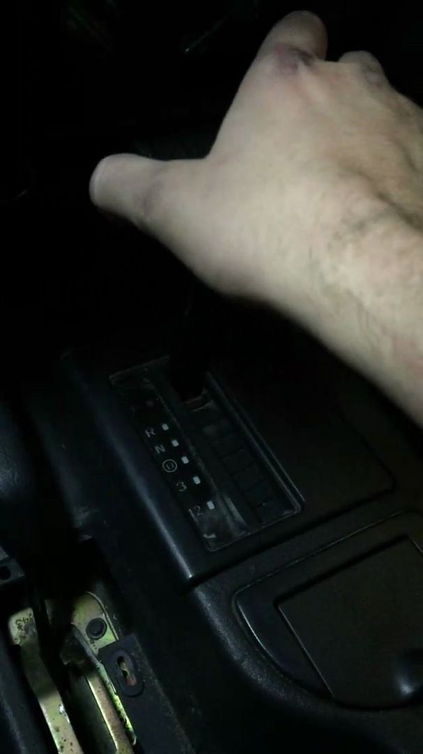

Had a chance to work on the Jeep a bit tonight. Here's what I figured out. This is almost the perfect shifter arm length for the throw the stock XJ shifter has. I cut off the last stop in the floor shifter to allow it to travel a little more. I also bent the shifter a little so it doesn't hit the center console when it goes down into first. I just need to figure out how to mount the cable bracket. I needs two mounting points so it doesn't move around.

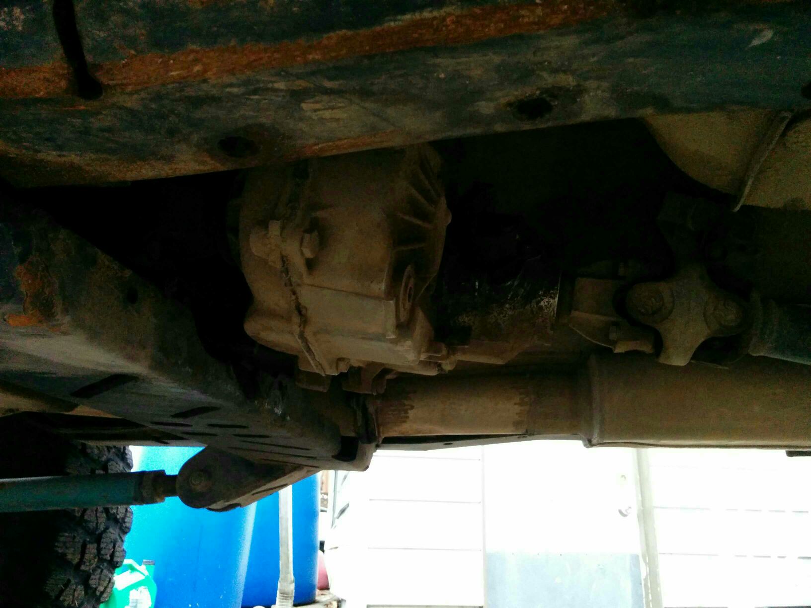

Also, here's a photo of the clearance issues I'll have with my driveshaft. The double cardan driveshaft almost makes contact with the frame side of the crossmember. The transfer case is not in its final resting place though and the crossmember is not pushed all the way up yet. It's in the position for a TC drop. My transfer case is clocked up and it is centered in the tunnel. I may purchase new long arms to remedy it, but I'm going to hold off on it for now.

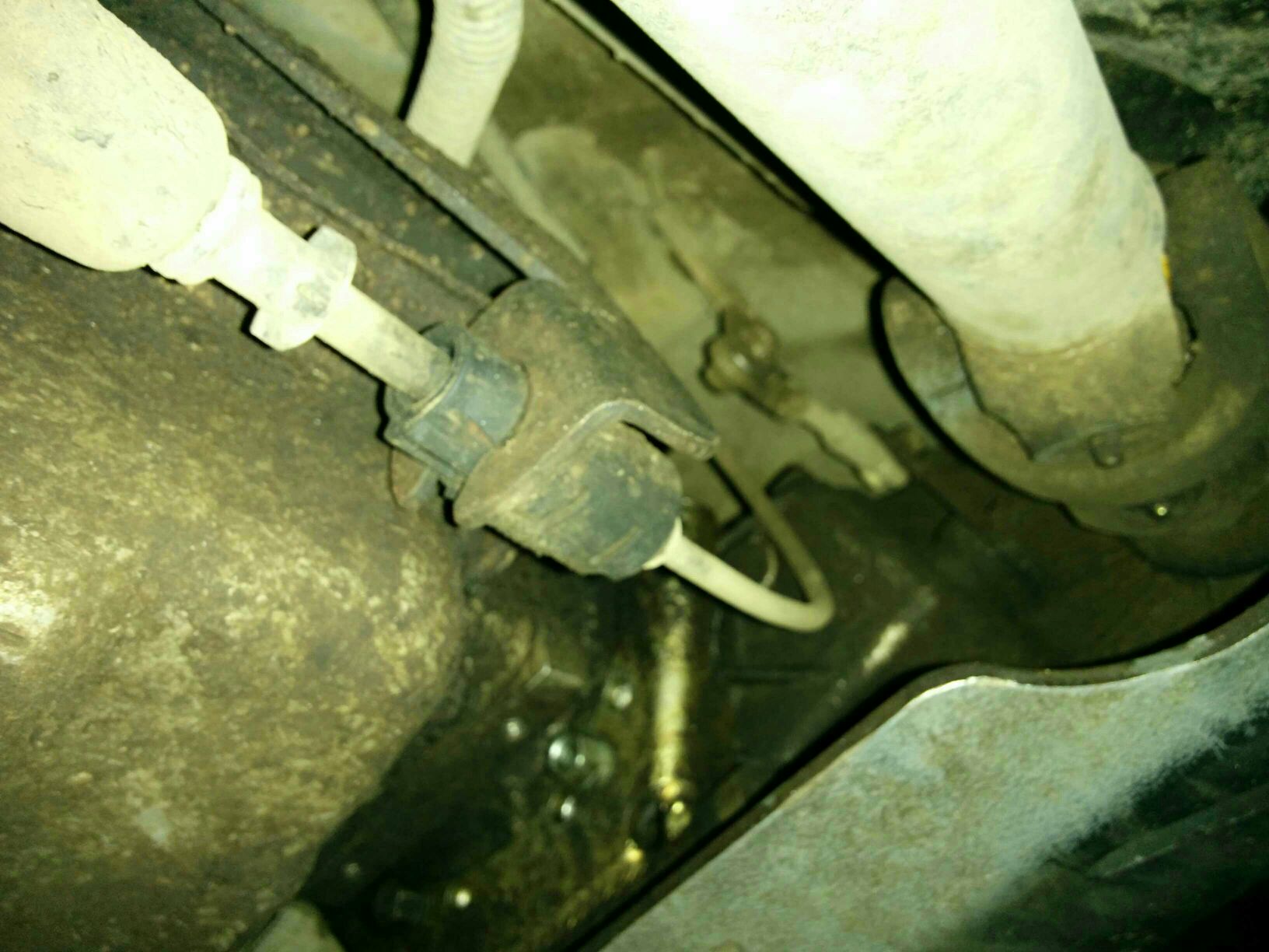

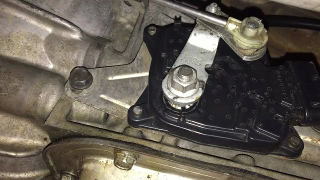

Received the AA TC cable shifter today and their transmission mount. Unfortunately the trans mount isn't the right spacing for the AA adapter bolts so I went ahead and just ordered the AA transmission mount (wish I would have just ordered it in the first place.
Novak cable TC shifter installed. Shifts are buttery smooth. Not as positive as the Boostwerks shifter but it's to be expected. Still damn good

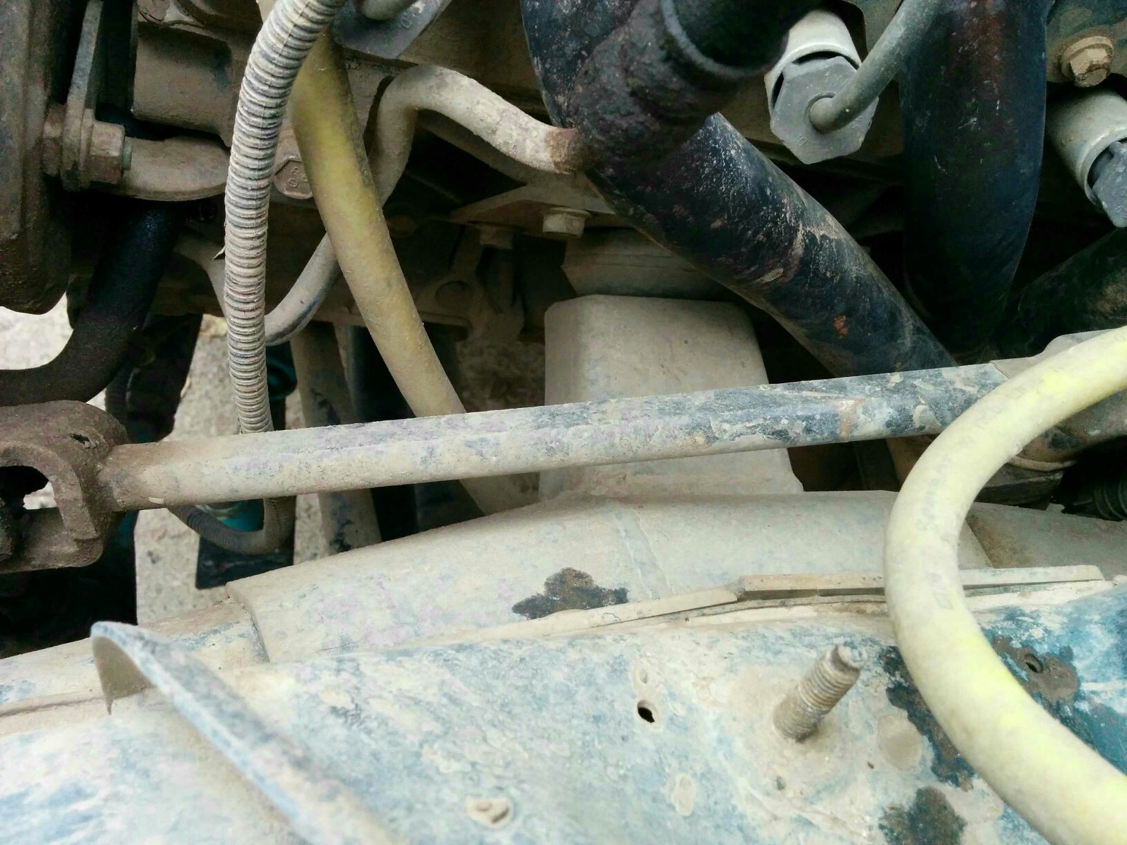

It's miles better than stock. Your reason is basically why I had to use this. You can kind of see from the photo that the transfer case handle is almost directly above the shift lever on the transfer case.
Picture of the bracket. I basically just flipped the stock bracket and bent the mounting point the opposite direction. I'm not entirely happy with the mount and angles so I'll mess with it a little, but it shifts through all gears no problem.
