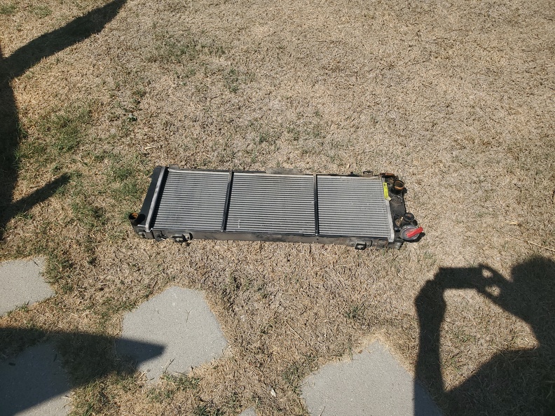

Its all those cheap parts you keep using... But seriously, in this case it was the $80 Spectra radiator.
It was $43 open box, and it worked just fine for like 3 years. ;)
Wasn't a problem until I tried to wheel at 12,000 feet elevation in 100 heat with the AC on.

So I yanked the Spectra out and tossed it. For what it was, it was a workhorse but it just didn't get it done.
Not sure what i was trying to show when I took this photo but here it is?

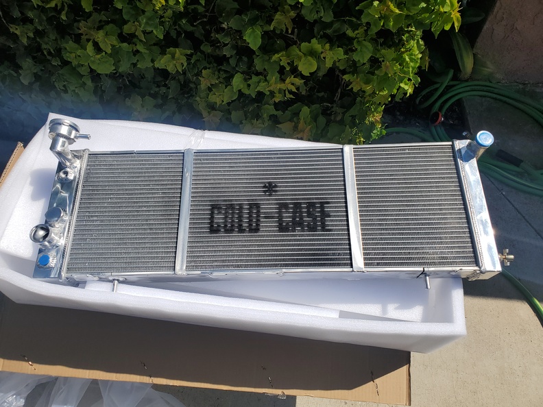

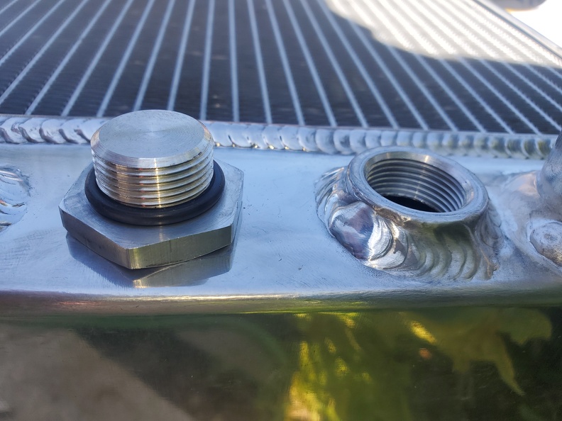

Pulled the cold case out to prep it.

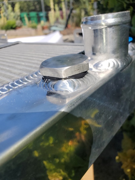

@Anak warned me about this o-ring
Solved that by removing the o-ring and resealing with some JB Quik.

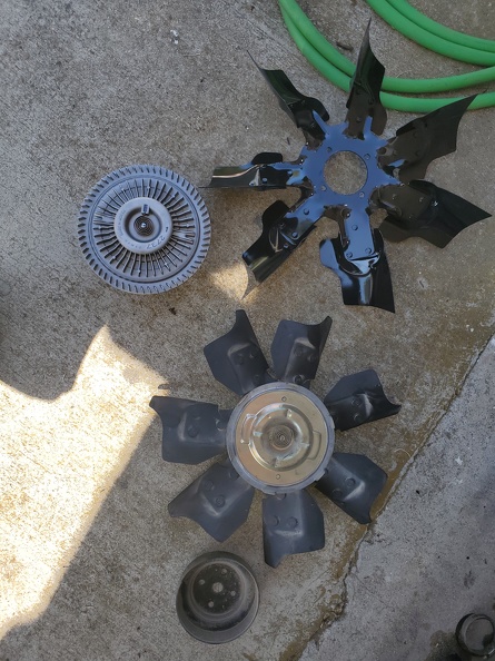

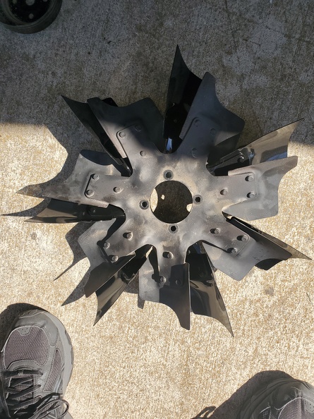

Started looking at the ZJ fan and fan clutch vs the XJ stuff.
the ZJ fan is quite a bit bigger!

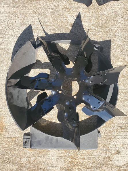

Buuuut it's not going to fit within the XJ shroud.
Overall it is 1.5" bigger OD and sticks forward just a hair closer to the radiator.
Dallas and I are going to revisit later if we can build a new custom shroud that lets people run this fan.

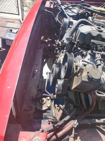

Then I bolted up the ZJ fan clutch to the XJ fan and installed it, and dropped the radiator in for a test fit.
During that process I managed to break my fan shroud, and ended up having to go pickup a spare from @CharlesDB so I could keep working. With that distraction I forgot to take any more photos.
I redrilled the holes on the rubber upper isolators for the radiator to move the top forward ~.750 the same as the bottom. ZJ fan clutch with the ZJ fan fit great leaving me about 7/8" to the radiator from the fan clutch. Installed a new MotoRad high flow thermostat with 1/8 holes drilled at 6 and 12 to burp air, new GMB high volume water pump, new Mopar thermostat housing ground a bit for higher flow, and filled the system with water wetter, cheap autozone coolant and distilled water.
For the time being the trans cooler is still routed through my little one in front of the radiator and the radiator itself, until I can get the Derale 13740 mounted up and plumbed. Still working on where that's going to go.
