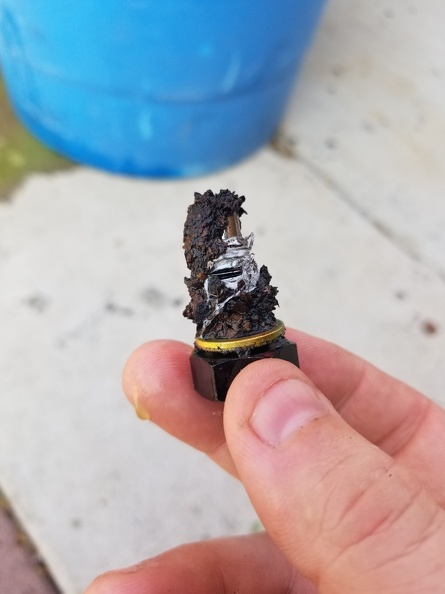

Well, the mopar HD radiator was a fail. Literally.
End cap of the fill neck failed running up a hill on the 215, and blew all of my coolant into the airbox. There was no shoulder to speak of where we were, so ended up driving it almost 3 miles to get to a safe place to stop. It got.. HOT.
Today I'll see if the engine seems OK, if so order up something all aluminium to replace it. I just don't see the big Griffin fitting with the AC and such.
Who's been running the Mishimoto? $400 with a lifetime warranty seems acceptable, particularly if I buy from Amazon (who honors the manufacturers warranty).
If the engine's *not* OK, then I guess I need to go visit Russ and see how he's coming on the replacement. ;)
I ran one of the Mishimoto's in my BMW 328. They warrantied it twice for me. 1 leaked where the tank joined the fins. Don't remember what happened with the first but I think it was a fitment issue. 3rd one was fine. All in a short time period of about 4 months. 3rd was good for 3-4 years until I sold the car.
Well, with some detours to the radiator review thread, you'll discover that between then and now i've been thru 2 mishimoto radiators and an engine.
