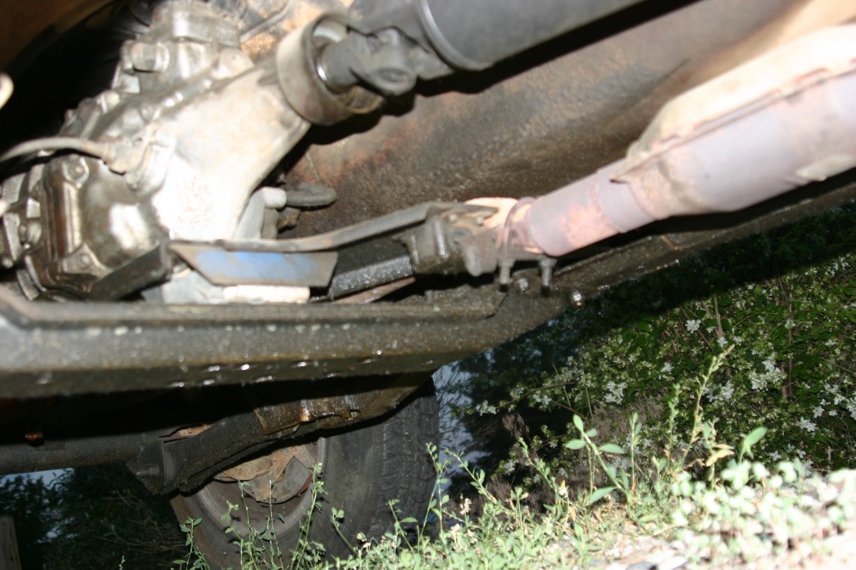

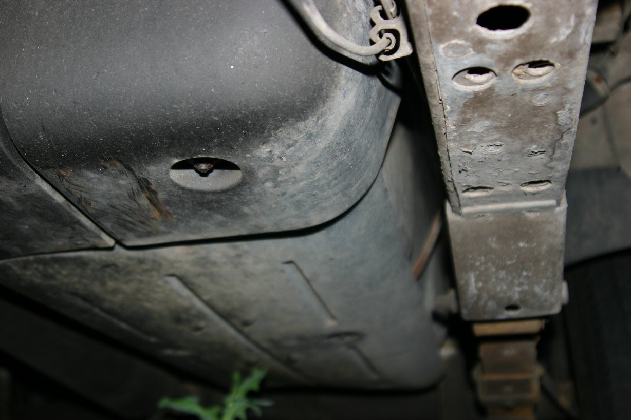

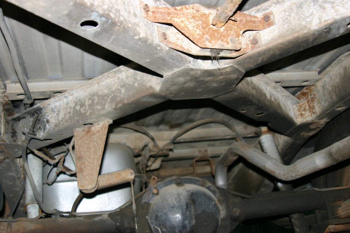

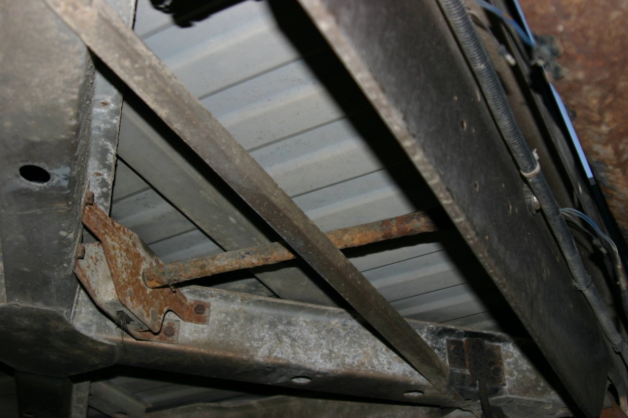

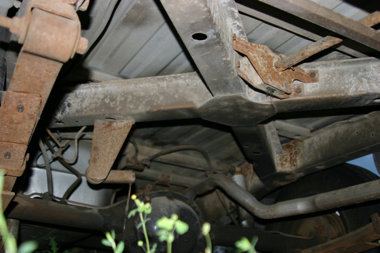

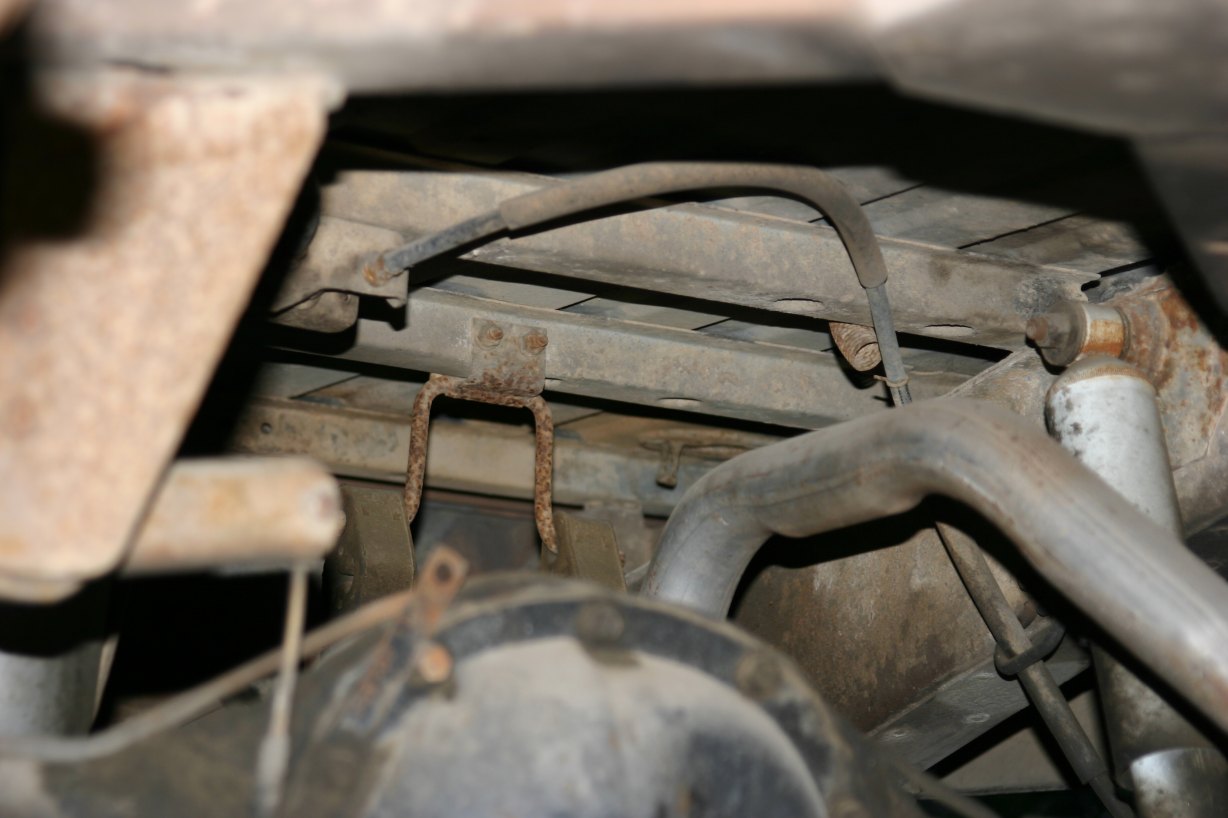

Snapped some pics under the MJ today:
Ew, 2wd, gross!
Some light surface rust on stuff, but nothing structural or cancerous. Might try to get it sand blasted instead of wire-brush-drilled.

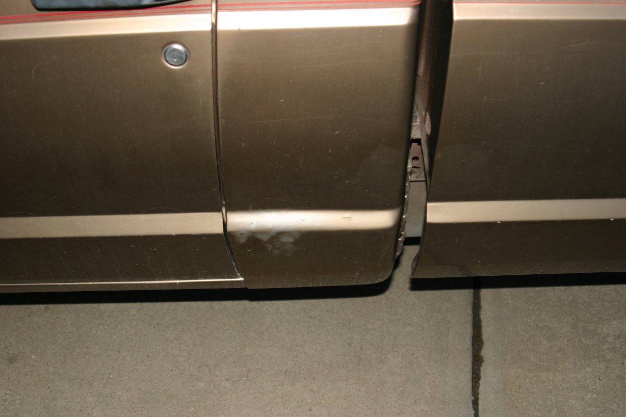

The one part of the body where I will need to do bodywork:

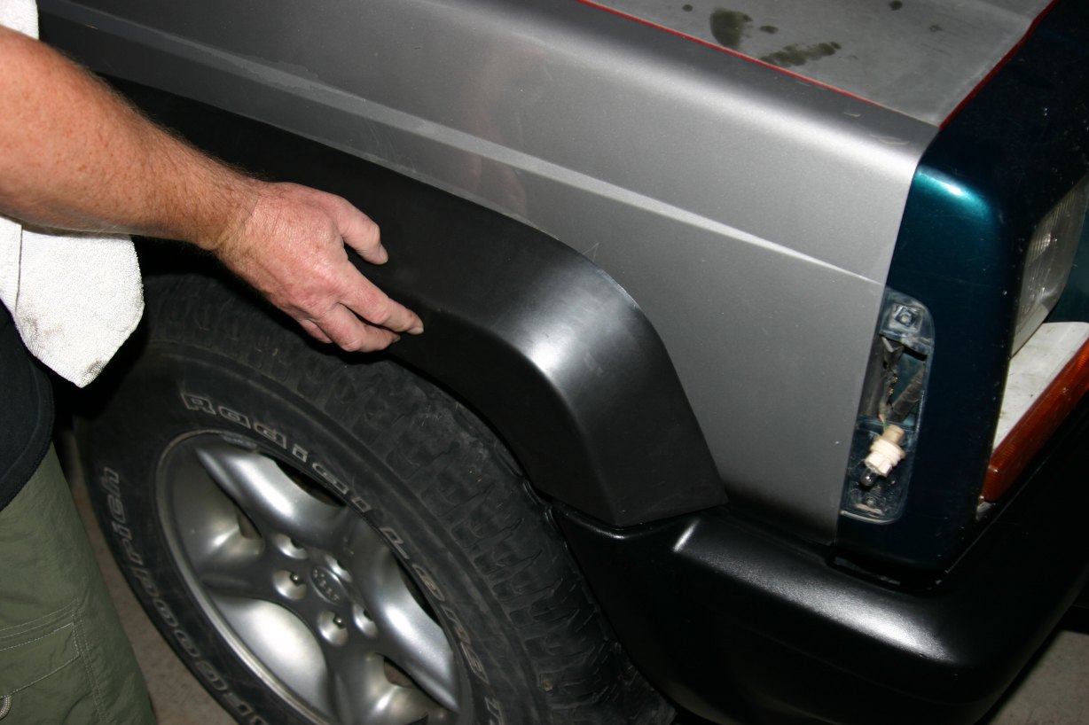

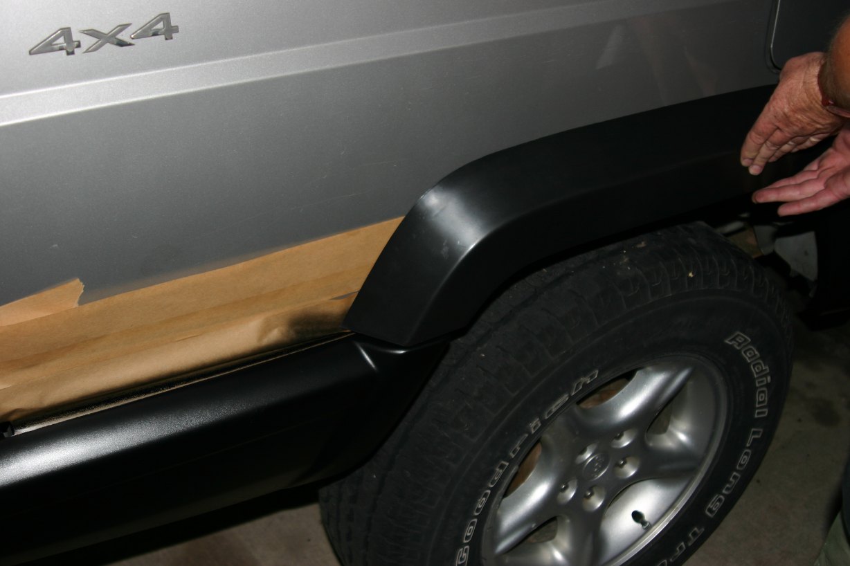

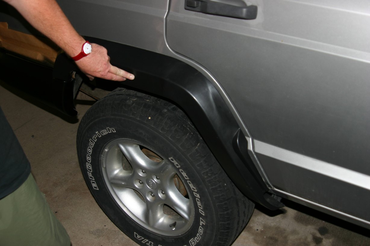

Testing out the 2500 flares, they basically take up the same amount of fender space that the 97+ flares do, but have a somewhat different "squared off" shape to them.

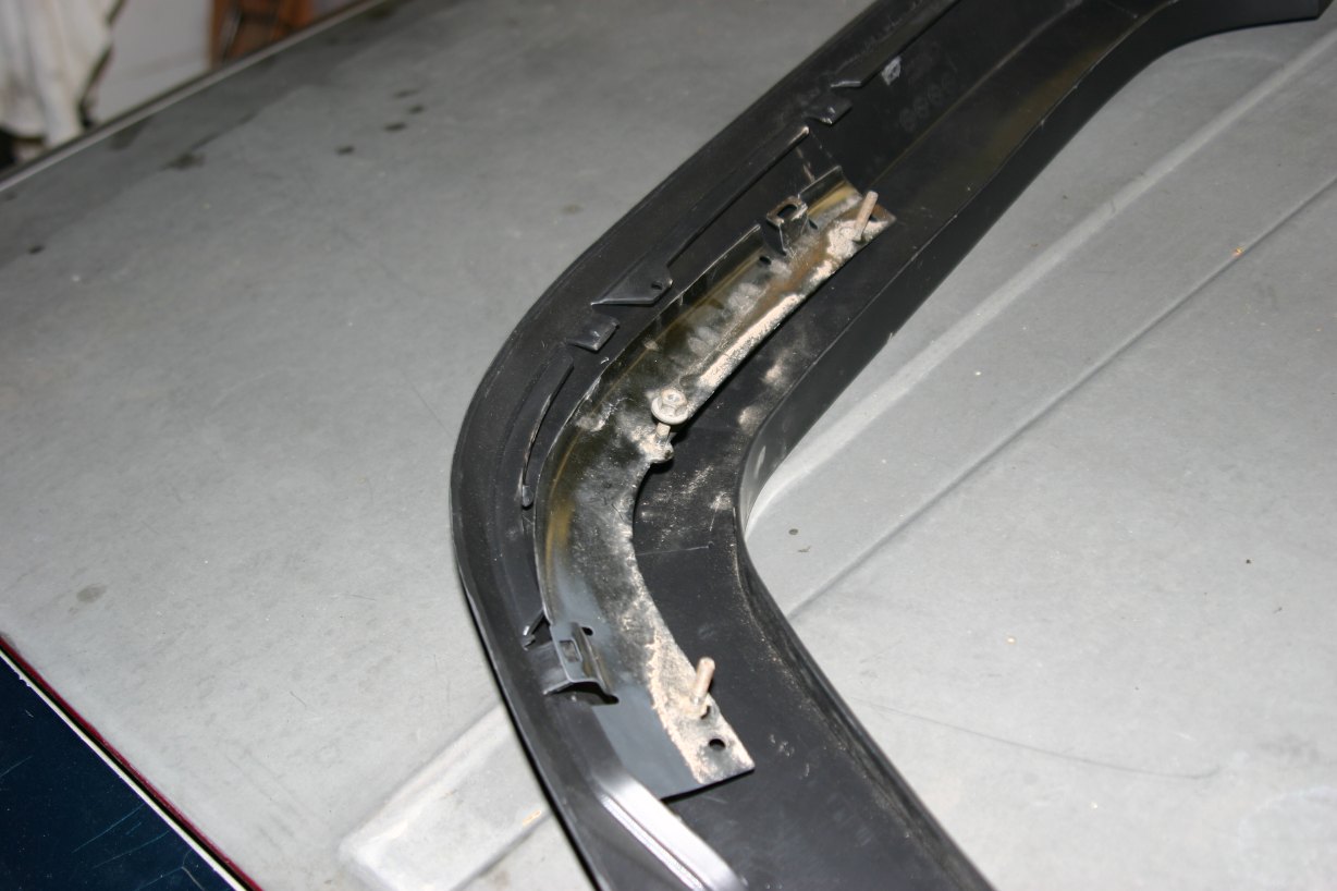

We will not be able to use the 97+ flare tie downs without modification:

Looks pretty good to me? ;)
Yeah, that looks decent.
If your anal your could fill the gap with some weatherstripping or something.

Its not the gap thats getting me, its how much the edge is rounded vs squared.

About the crease vs the round tail light edge... From the pics it doesn't look like a big deal. Yeah, kinda disjointed but then so is the round parts in the square housing. Fill the gaps somehow and it'll be barely noticeable - at least in the pics. Maybe it clashes more in person?
For what you have in mind for the MJ, don't spend a lot of time on the tail lights till the other big stuff is done (IMO).

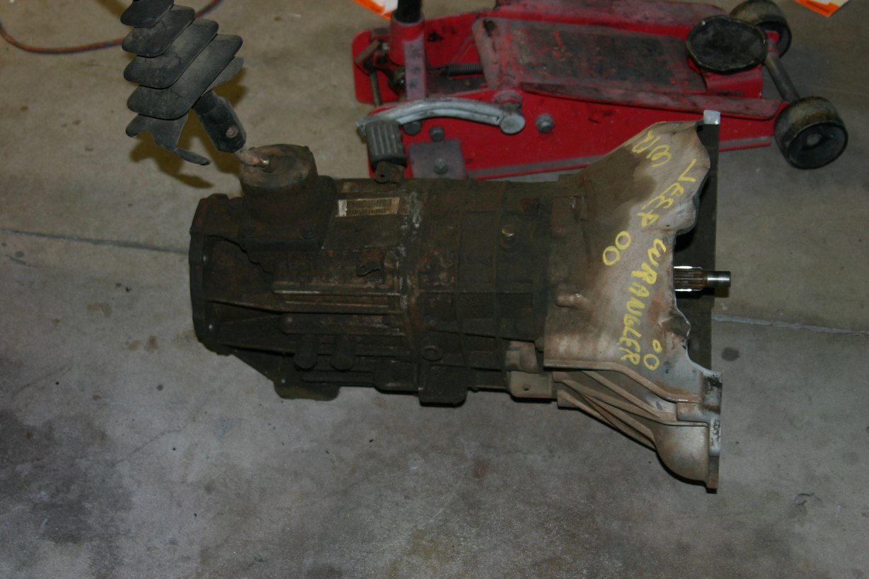

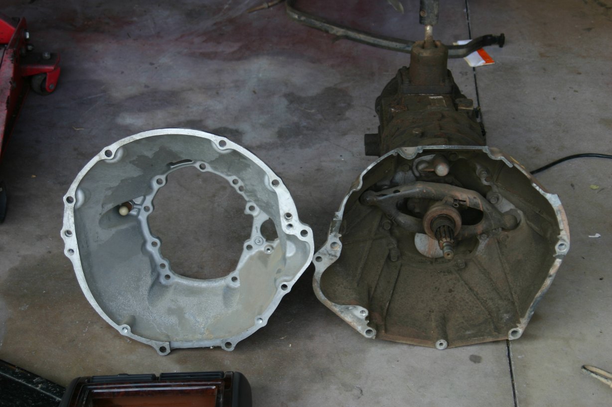

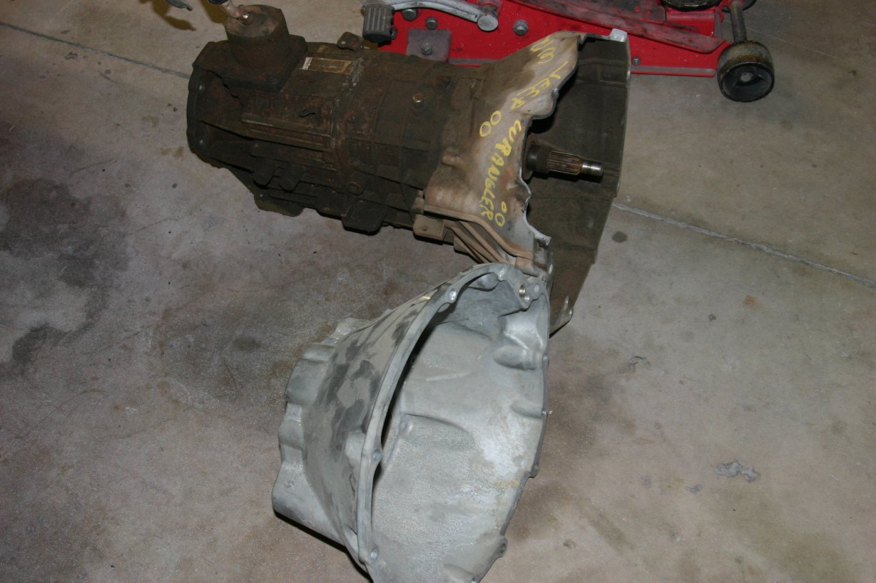

Bought this NV3550 for my MJ today for $550:
As you can see the bellhousing is broken so I got him down by $50, its the wrong bellhousing for me anyways, pictured next to it is the correct bellhousing for the CRD engine.

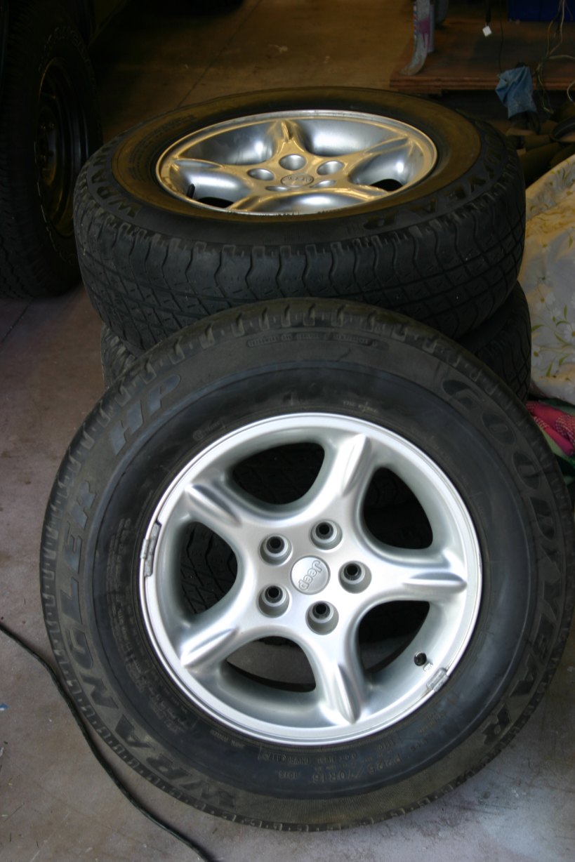

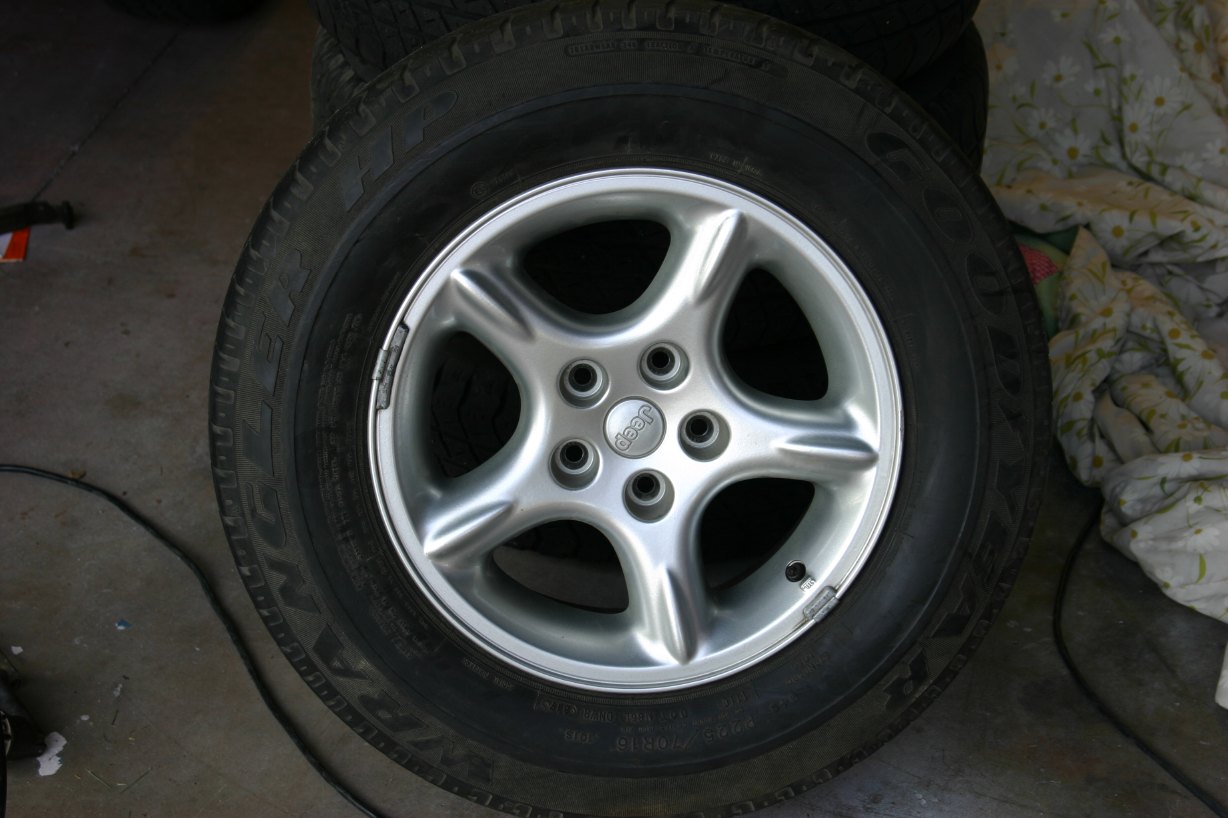

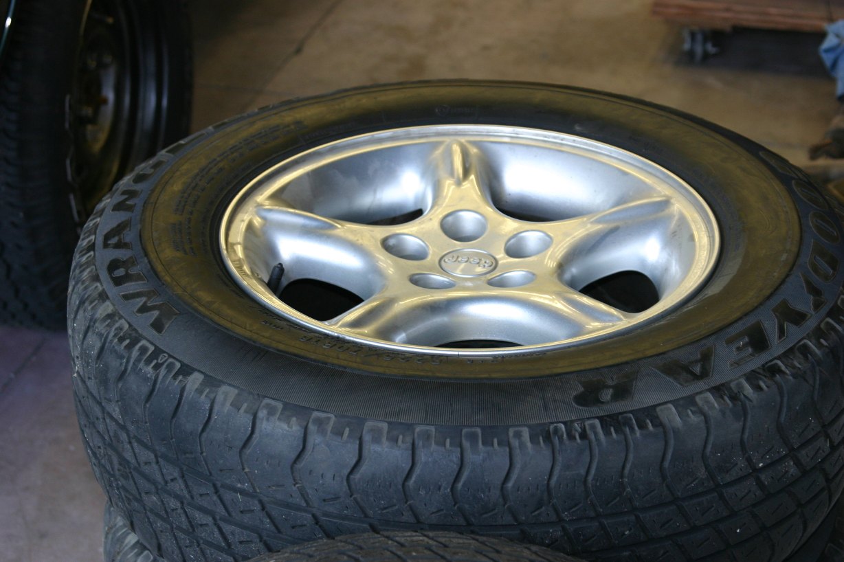

MJ gets some new shoes:
Got em for $300 locally, wheels are just about perfect, nar a scratch on them....for now.

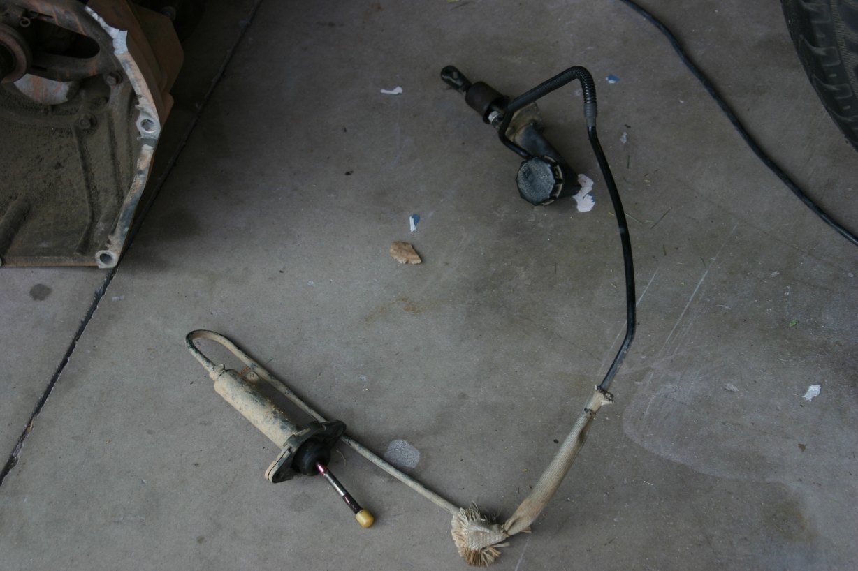

Got the master/slave combo out of a 96 today, gonna go back on sunday and grab a NP242.
Here you can see the difference between the 4Liter bellhousing and the CRD bellhousing:
Got the master/slave, plus a bunch of other junk for $26.
