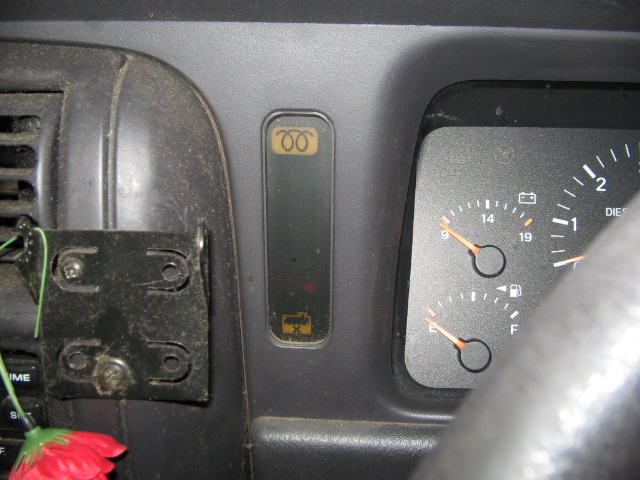

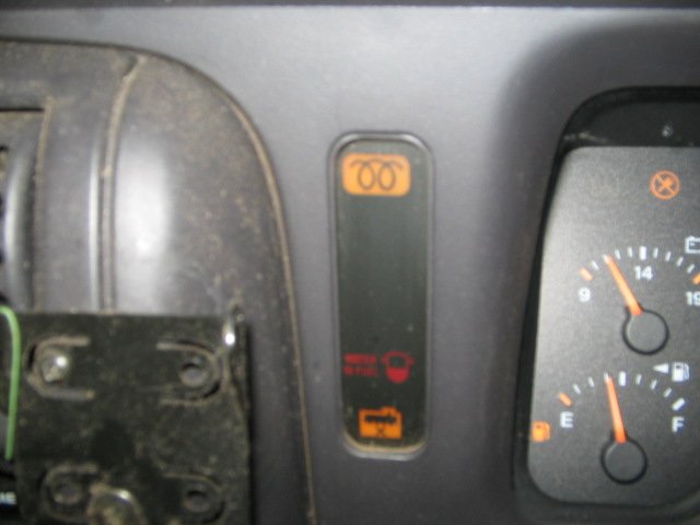

Something else:
Its the "Vehicle information center" for the diesel XJs, has the glowplug light, WIF light and low coolant light.
I'm probably going to try and pick up the little bugger for my swap.
