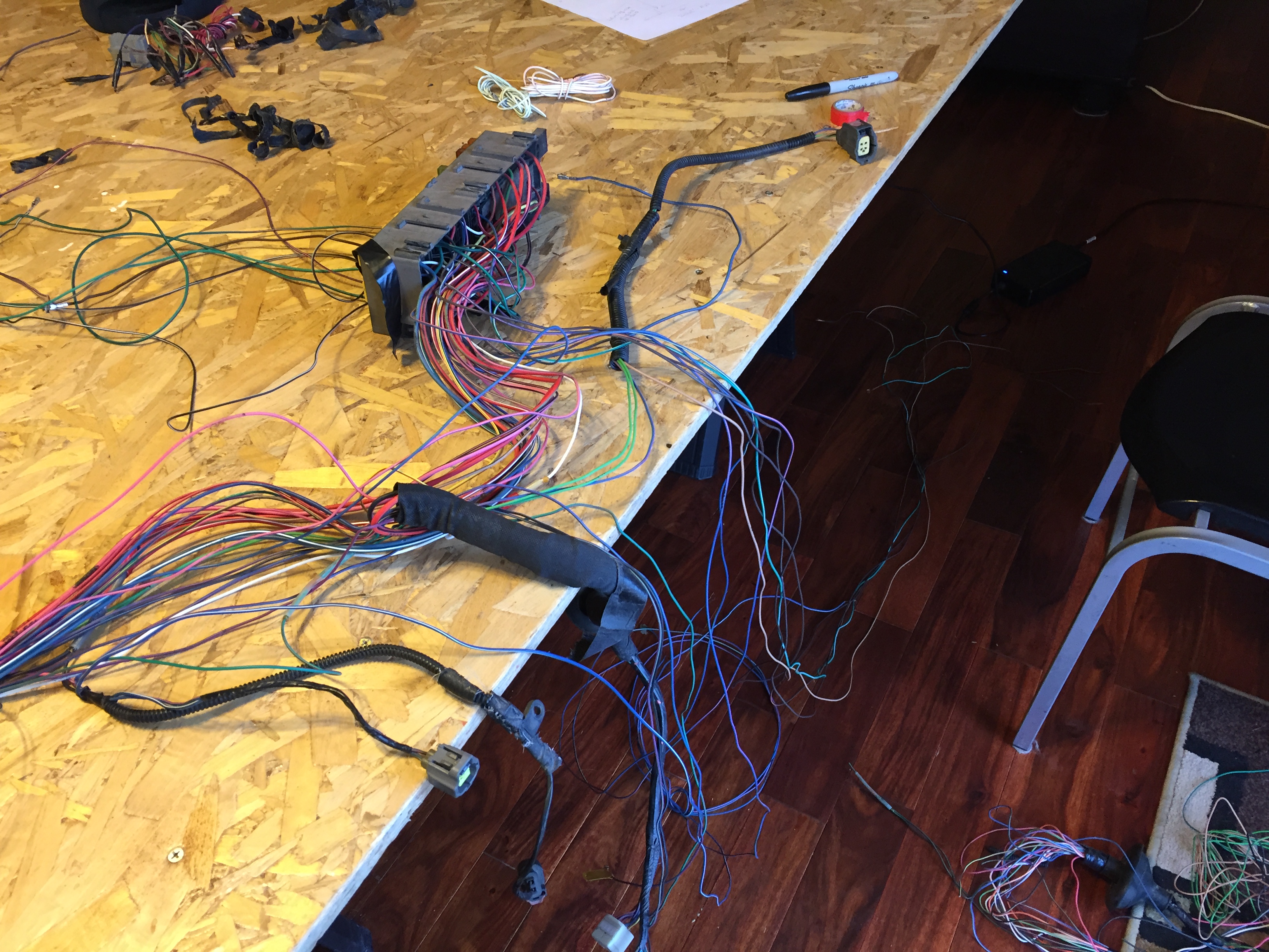

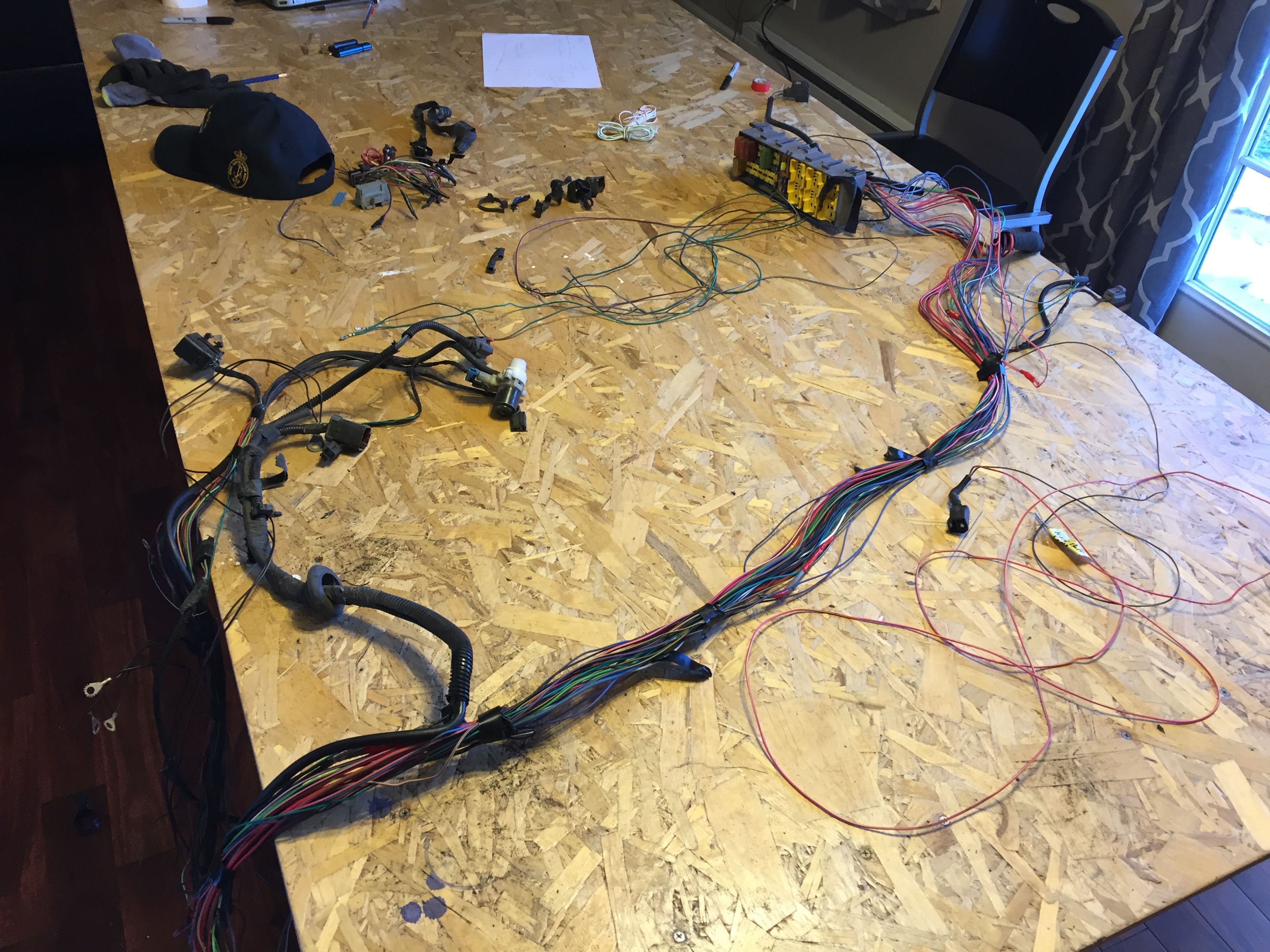

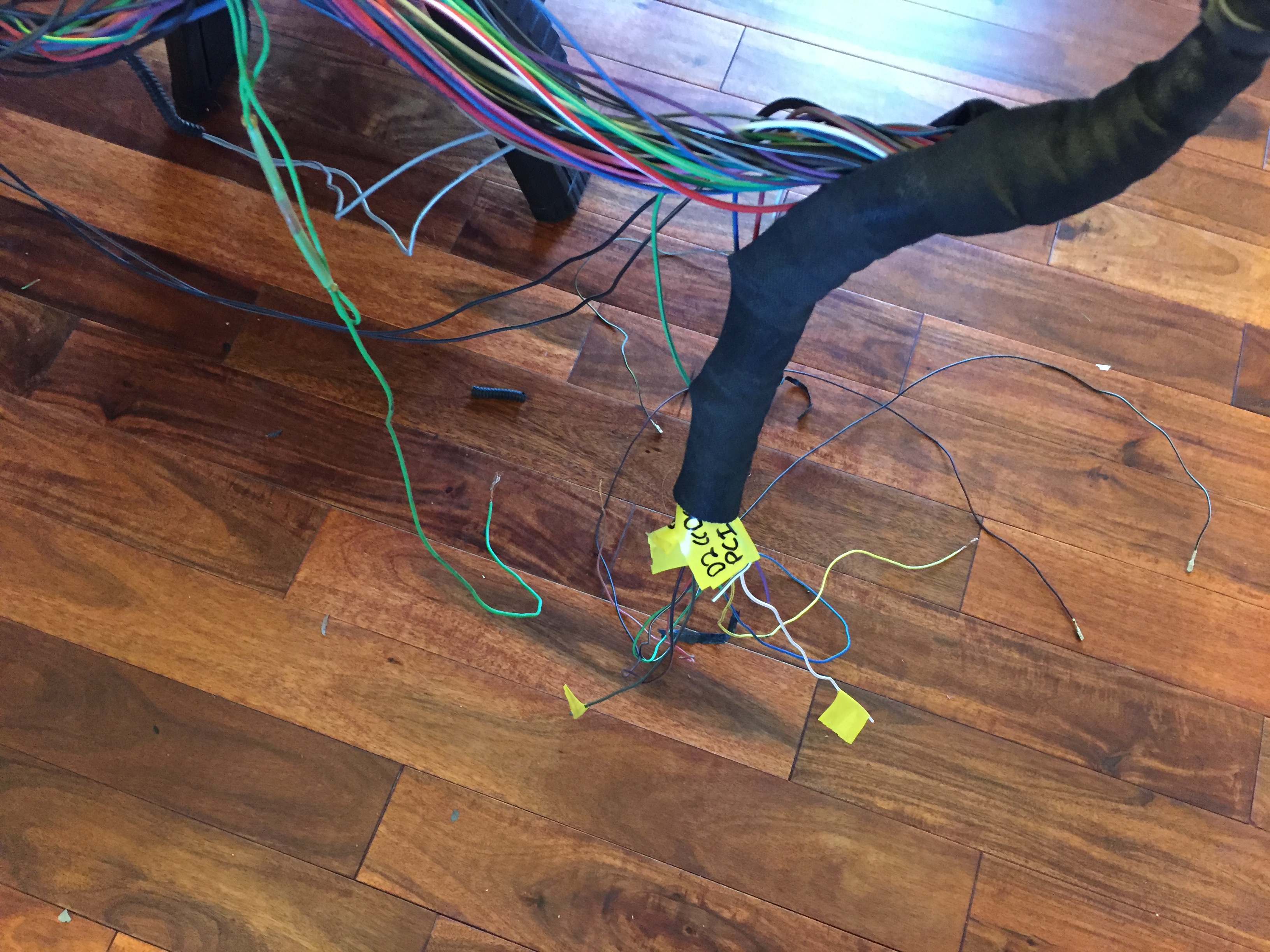

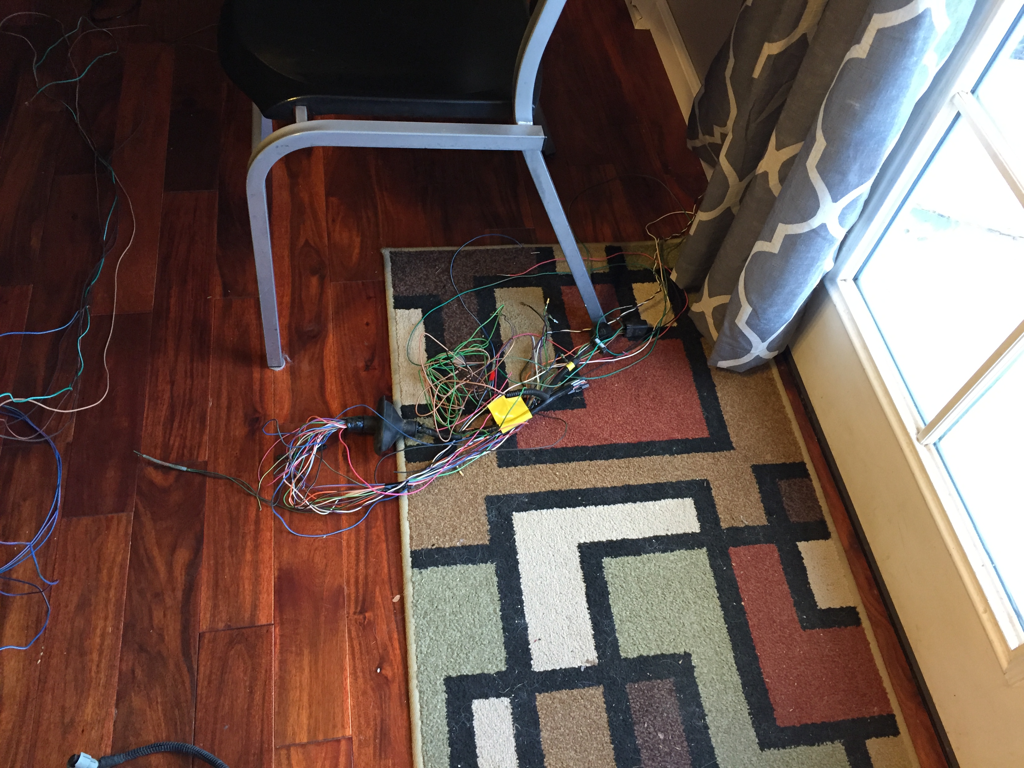

Wiring work continues on the main engine harness:

I gotta start sitting down the with the Xj wiring diagrams and the KJ wiring diagrams to see what I can adapt from one to the other, and what I need to add, like glow plug relays. etc.
