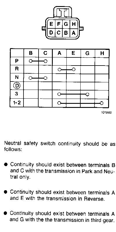

just splice b & c together and wola ..no more worries withthe NSS and the backup lights will still work ..gather ing they are working at the present
note here guys the jeep WILL start while in gear thereby... jumping.. forward
