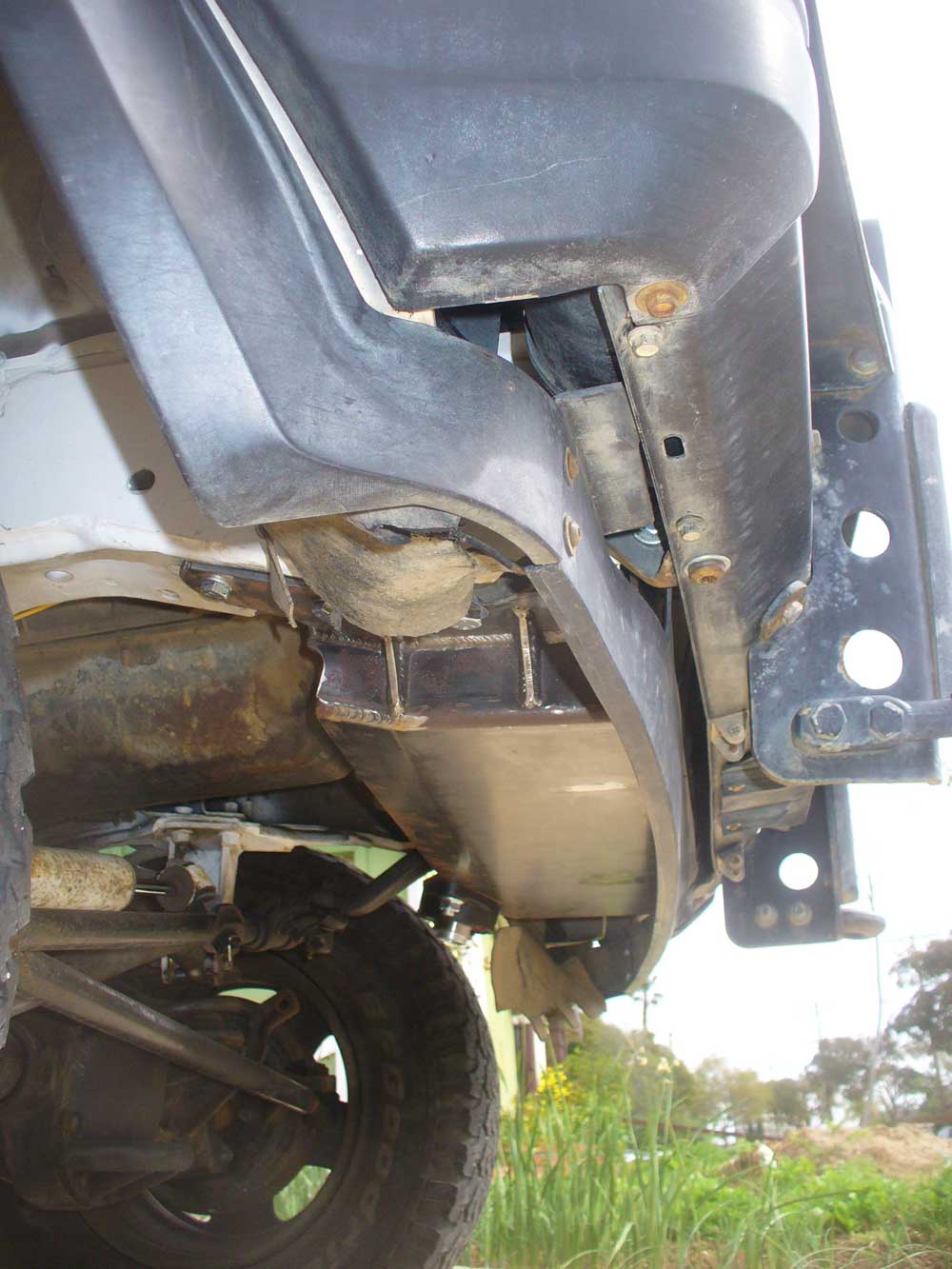

That looks great. I need to get mine in still. I was working on how to go about building a bumper over it. Do you have any other pics of the tieins. It looks awesome brent.
I bought a set of "builder tie-ins from DirtBound, then cut them down and notched them to fit the 1.5" x 3" tube. I'll add a gusset later between the tie-in and the wing.

Here's what I ended up with for a home-made bumper. Took me way too long - I really don't have all the tools needed to do this the easy way, but it's finished now. Just needs paint and final install. Approach angle will be awesome and I'm happy with how it turned out.
IMG_0166 by Brent Taylor, on Flickr
IMG_0167 by Brent Taylor, on Flickr
IMG_0168 by Brent Taylor, on Flickr
IMG_0169 by Brent Taylor, on Flickr
Like this:
To be fair, there is not yet an opening in the bumper for the fairlead. I am still working on that. I will probably have to cut out the bottom third of the bumper in the center, about the width of the license plate. We will see how well the license plate hides it.
The plastic valence is necessary in order to hide the mount. It hangs lower than the bottom of the bumper. The valence will require some trimming and some different mounting holes. I have that planned out in my mind. I will post up pics as progress occurs.
