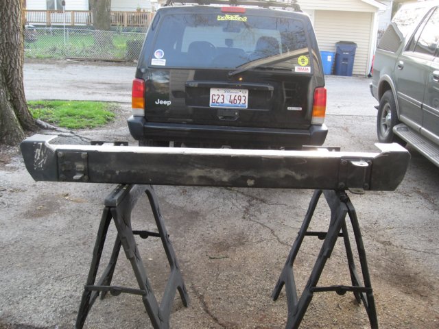

Anyways, when my 92 was still in decent shape, I was running a C4x4 rear bumper with tire carrier. Now that I have a 2000, I decided to install that bumper on my new rig.....good thing I kept it around

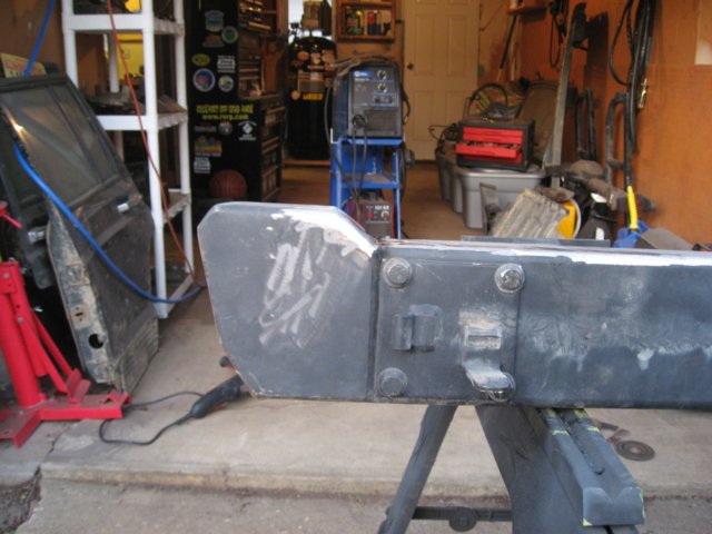

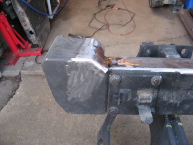

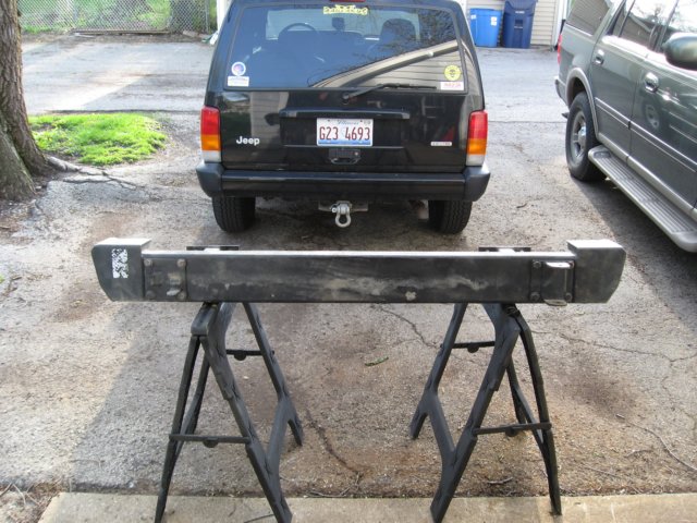

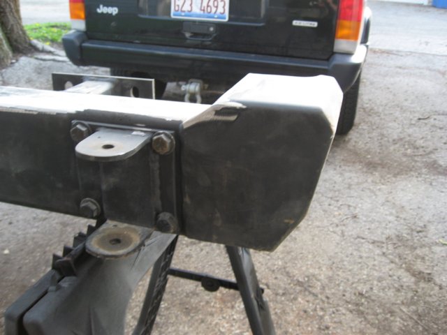

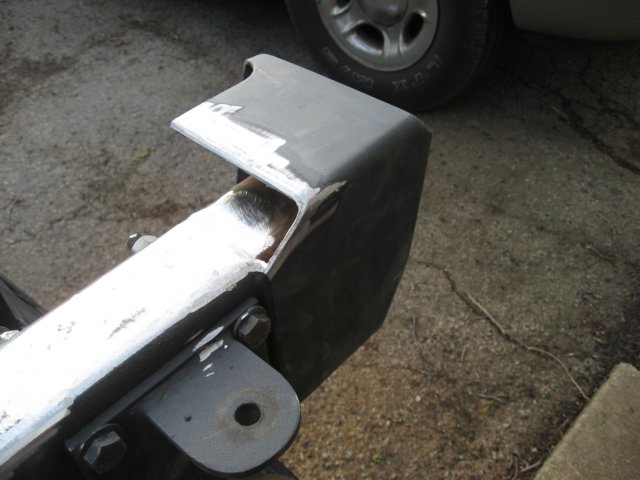

Really, the only problem is the end caps. The hatch is wider on the 97+ so you can't open the hatch with the old style bumper unless you modify it. I have seen someone bend the corners of the hatch to make it work, but I really didn't like that idea. Instead I just cut down the end caps a little.
The bumper:
after i cut

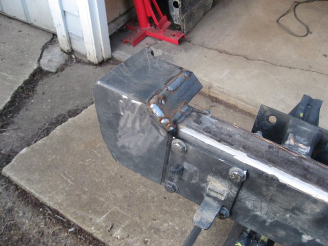

test fit with some strap tacked in place
welded

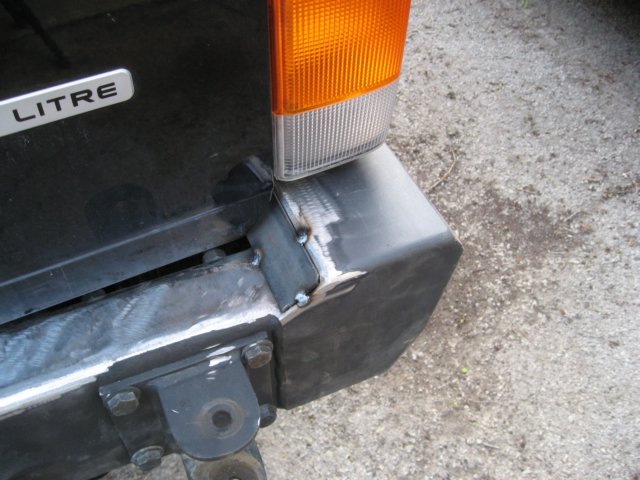

blended

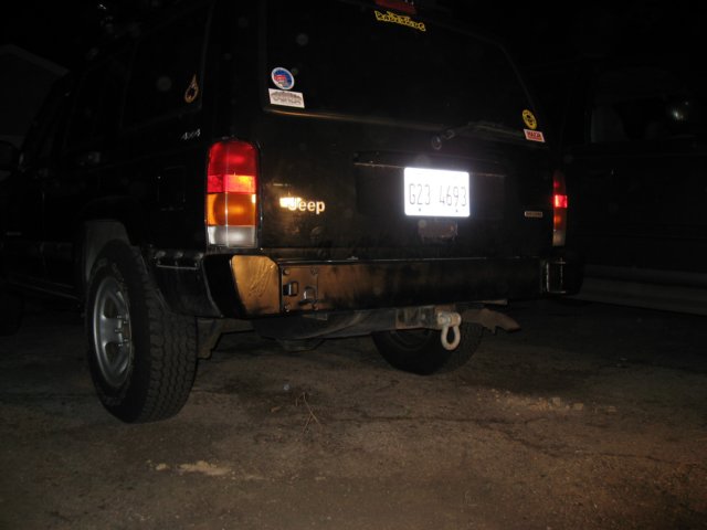

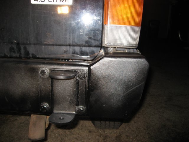

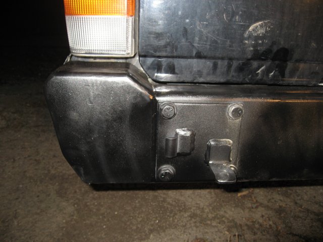

done. nice fit
sorry, dark pic
