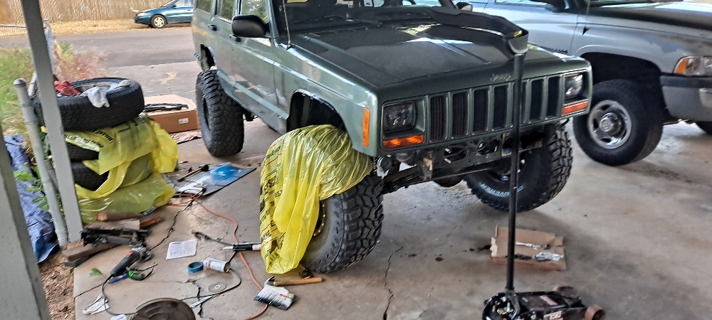

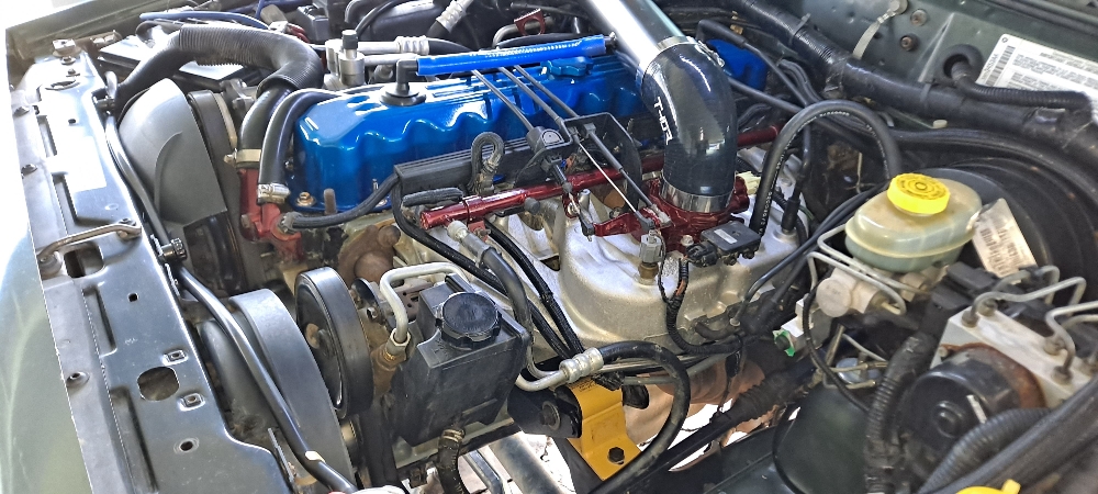

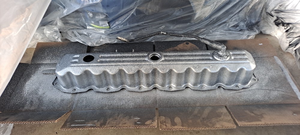

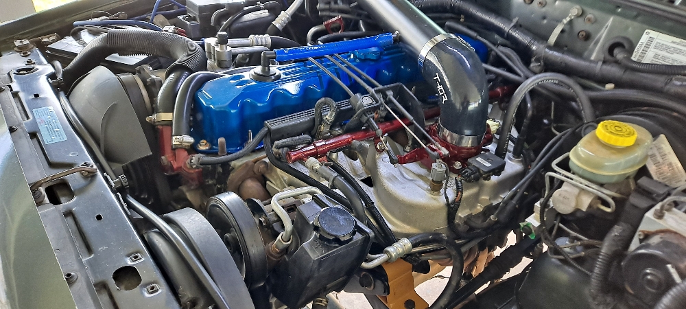

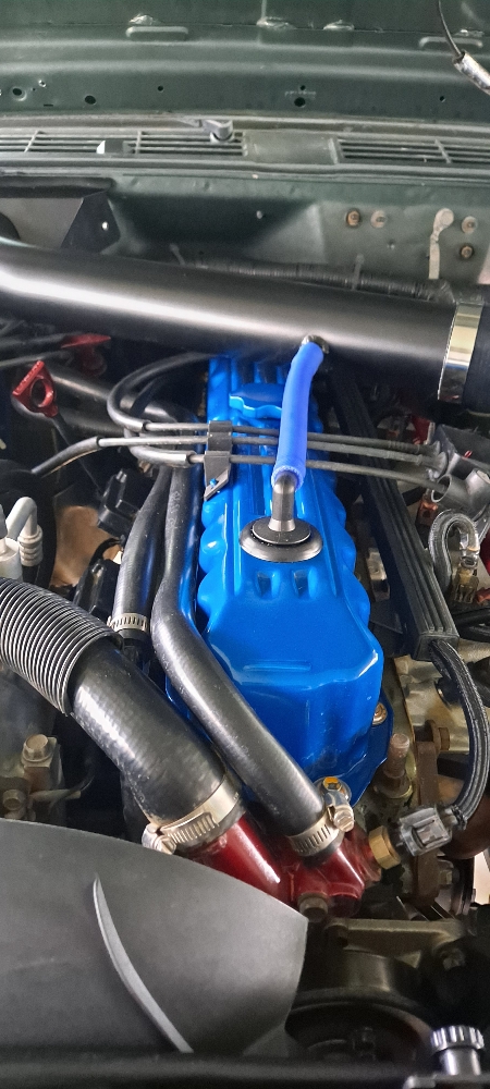

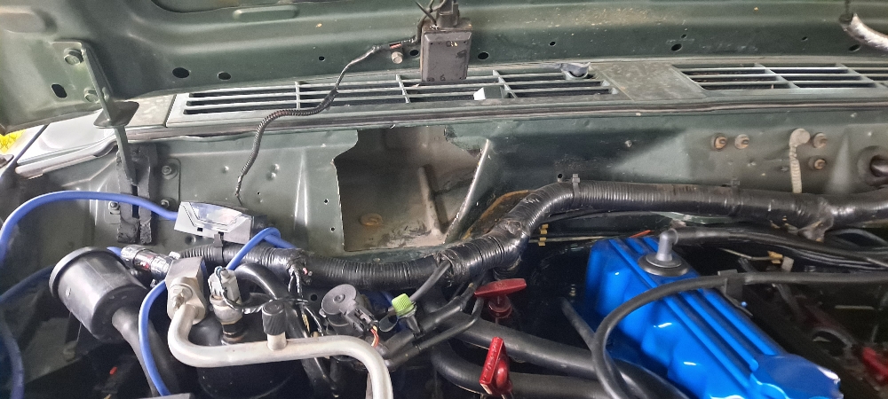

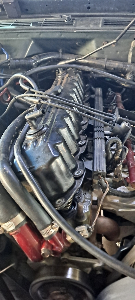

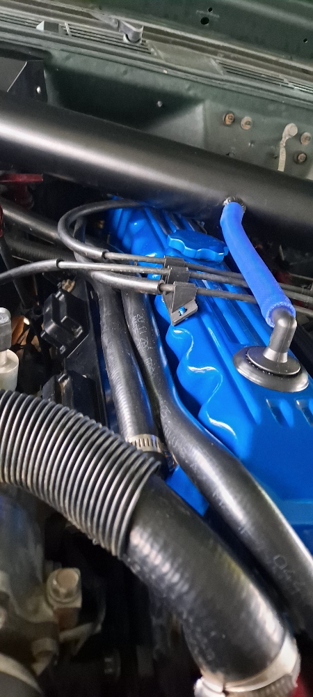

But anyways i pulled the valve cover and painted in the rain with my table makeshift booth
I used the duplicolor metalcast paint qnd they recommend a base layer of silver after your primer to get the metalcast effect

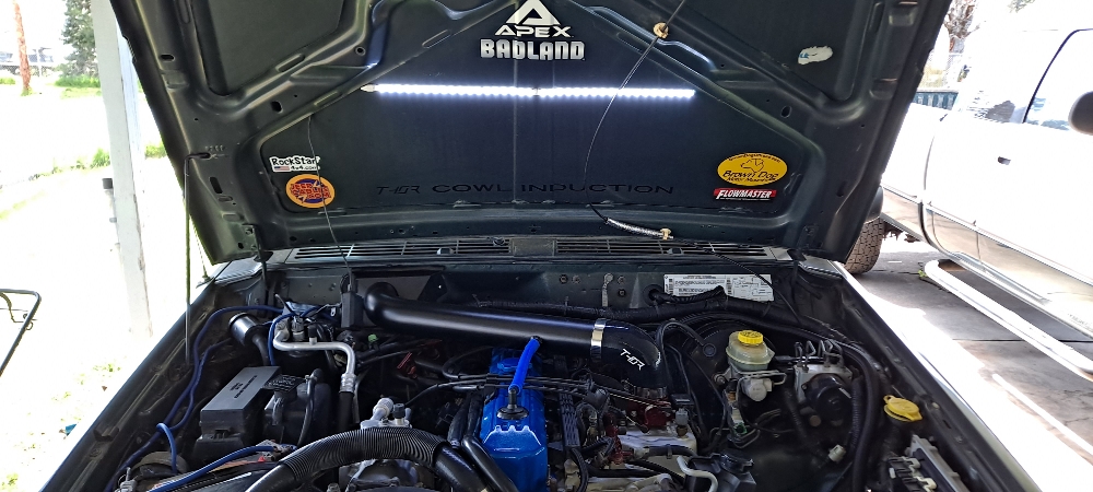

Then i pulled out the grinder and cut a hole in the fender to install the cowl intake
Im happy with how it all came out and now wondering how to build a splash shield that wont get torn up by the suspension

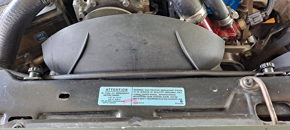

Then i installed the fan shroud i have had sitting in my living room for almost 6 months and realized i didnt have the bolts for it, so instead of bolts i found these turn knob bolts which i was happy to find doubled as a home for the overflow tube and also makes quick work of removing the shroud

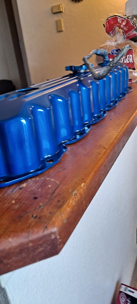

Valve cover came out cherry man! I lack patience for painting... but nownya got me thinking I'm lacking being under my hood- that looks absolutely great! Cowl came out niiiice too
Thanks man, painting can definitely be time consuming and i put it off until last as well but knowing it was the last thing to do kind of helped. This is the only thing iv actually spent the time to sand down the primer and finish up with 2000 grit but since its kind of the main thing you see when you open the hood it makes it worth it even if its the only thing painted its a difference for sure.

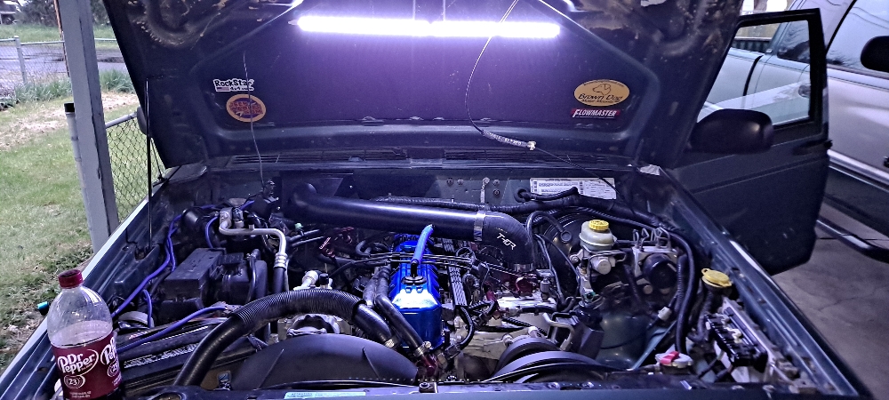

Heres a few more shots with better lighting

Everything is so fresh looking! Was it garaged its whole life or did you replace the condenser, compressor, cooling hoses, wire looms, and what not??
Even the firewall ground looks minty... on that note, one of the best upgrades I've done is the jeepcables.com big 7 wiring connections. You can buy welding wire and lugs and do it your self, but the 0 guage kit comes plug and play ready to rock. My grounds were trash before leading to no starts, dash cluster intermittently going bananas, and even an aftermarket sterio smoking itself. While yours looks far from my dire straights.... the stock grounds and battery cables leave much to be desired especially running an amp(s), subs, lights, winch, etc etc so on and so forth.
Keep up the stellar work! It's a joy to see a decades old vehicle looking like it just rolled off the lot

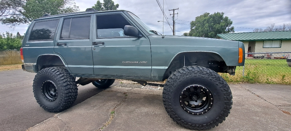

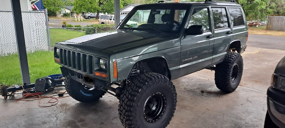

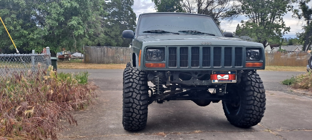

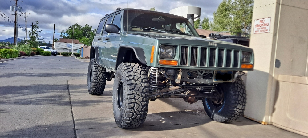

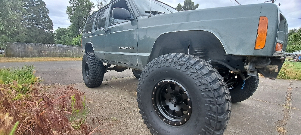

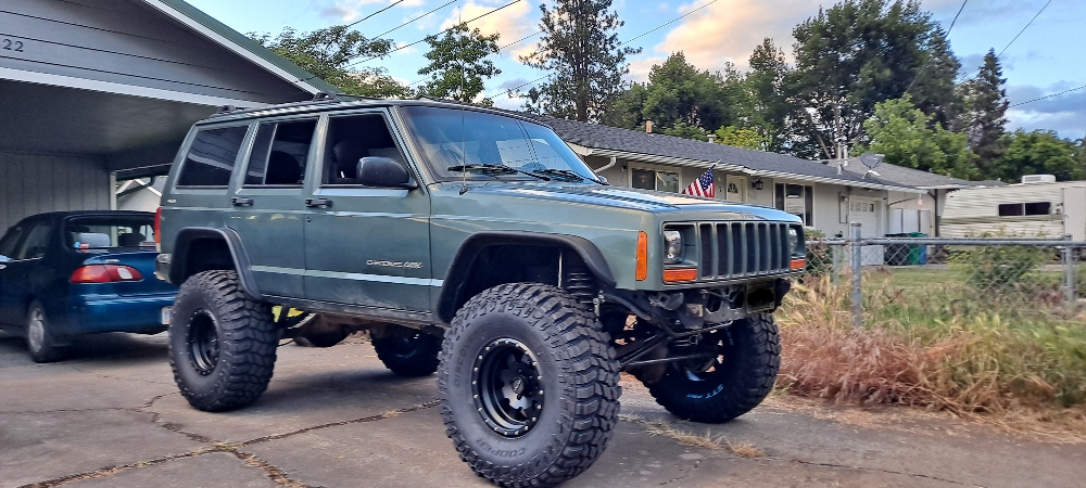

Iv been out in New Mexico the last 36 days on Fire so i havent been able to do alot but She finally got some shoes! 35" Cooper stt pros on 15x8 Raceline Defenders with 3.5" backspacing Now i gotta get trimming some more and im torn on a few different flare options. The Notch X-Max flares, Custom tube flares. Or some flat style bolt on plastic flares for now. I love these tires. I have an advance adapters SYE sitting in my living room im going to be installing here soon but oddly enough i didn't get any driveline vibrations on the way home from les schwab granted i was only going 55 but thats good news for the long run on this build!

I only had 1 complaint with running the STT PRO's in 35" when i had them on my old JKU is they absolutely killed my fuel mileage but mine were also 10 ply sidewall. But the ride quality and trail/ terrain had no chance against them. Many creeks, hills and valleys and some light technical trails and some ugly muck. Those tires performed very well for me. Enjoy them sir! And love the XJ so far, giving me lots of ideas
Thanks man, yeah im very happy with them they had great reviews and tons of youtube videos sold me, i love how quiet they are for mt's and i'm excited to see how they perform offroad.

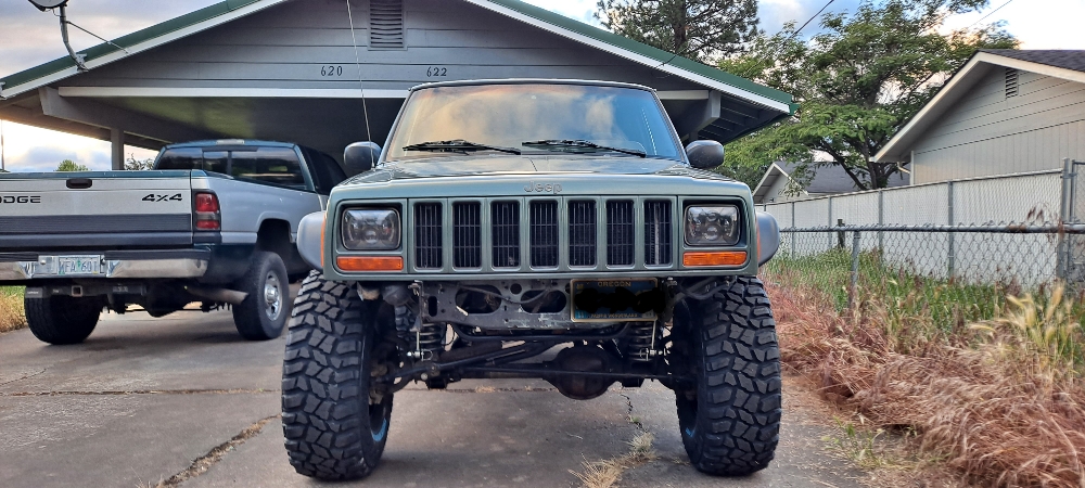

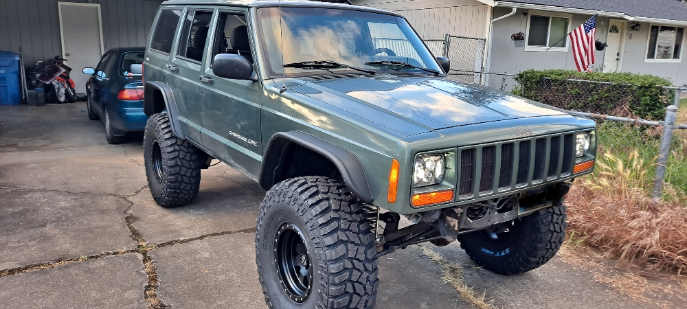

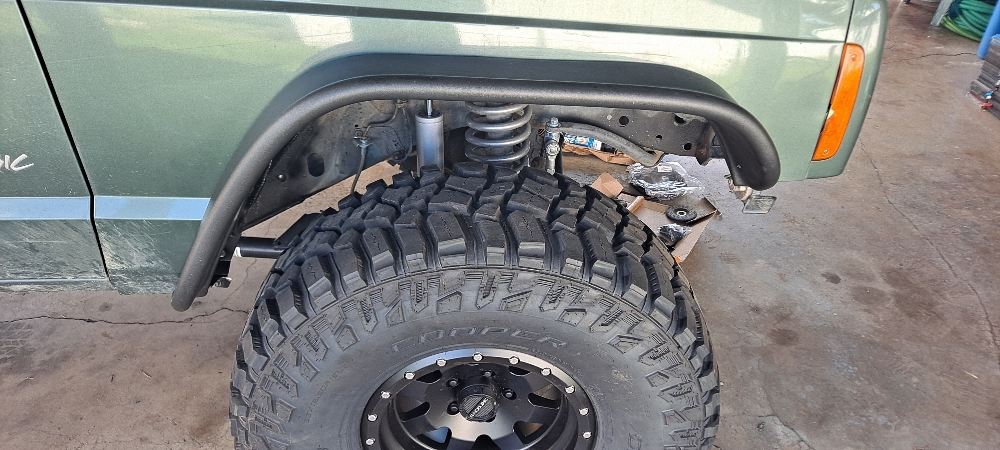

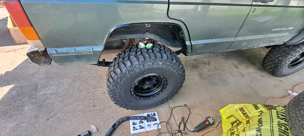

So i wanted to the cut the fenders more than the aftermarket fender flare market supported and had to go back and unbend my cut and fold job to keep it street legal for now. I stayed up for 2 nights trying to find a flare that would be bolt on without spending weeks in the shop so i could enjoy her for a little bit in between fire calls and came to the conclusion that im just gonna have to wait and have custom fenders and sheet metal work done to the rear so im going to wait to do that and do it while i build the axles but in the meantime im running these im happy with how they came out.

Ive seen these tires do killer on the trails.
Your jeep is looking great.
The one pic looks like your tires are over inflated. Id chaulk tune the pressure before you wear the centers out. Probly with a 5-10 Variante on each tire come from less swhab. With a were shooting for 35 psi ball park.
Im running 15" psi in 35x12.5 on 8" wheel could probly go down even more to get more tread on thr asphalt. Im not quite 100% contact across the tread face.
Lets see some dirty pics.
Ohh good choice to wait on fenders youl be glad you did.

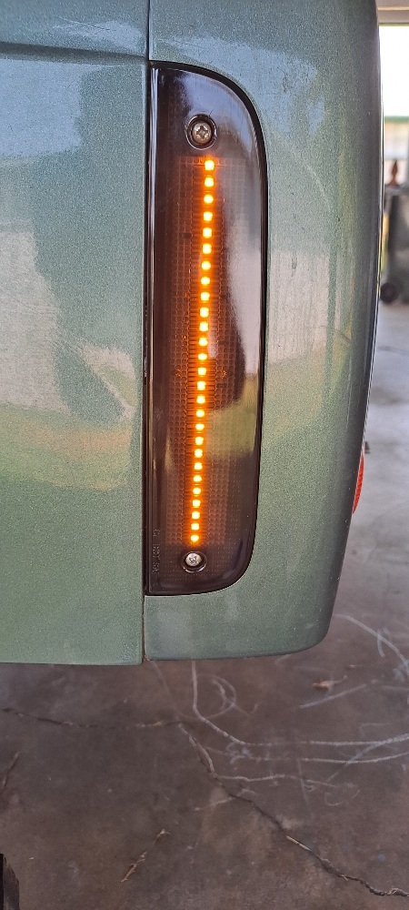

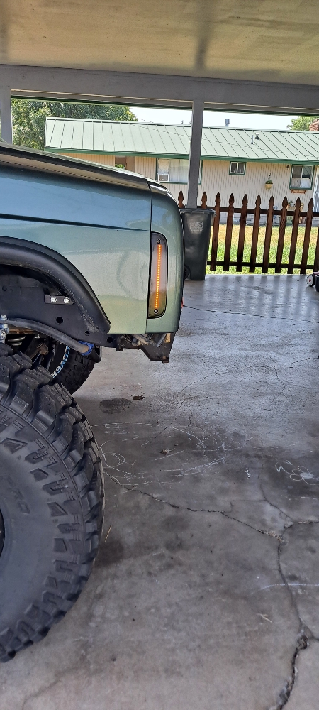

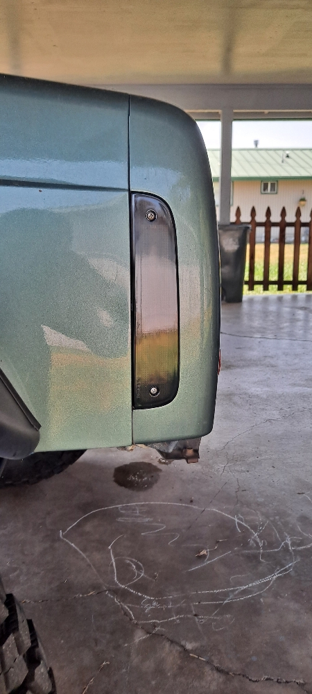

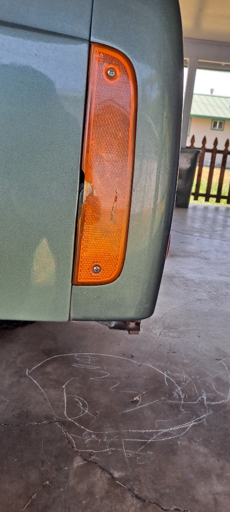

i swapped out my marker lights for these leds

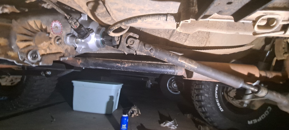

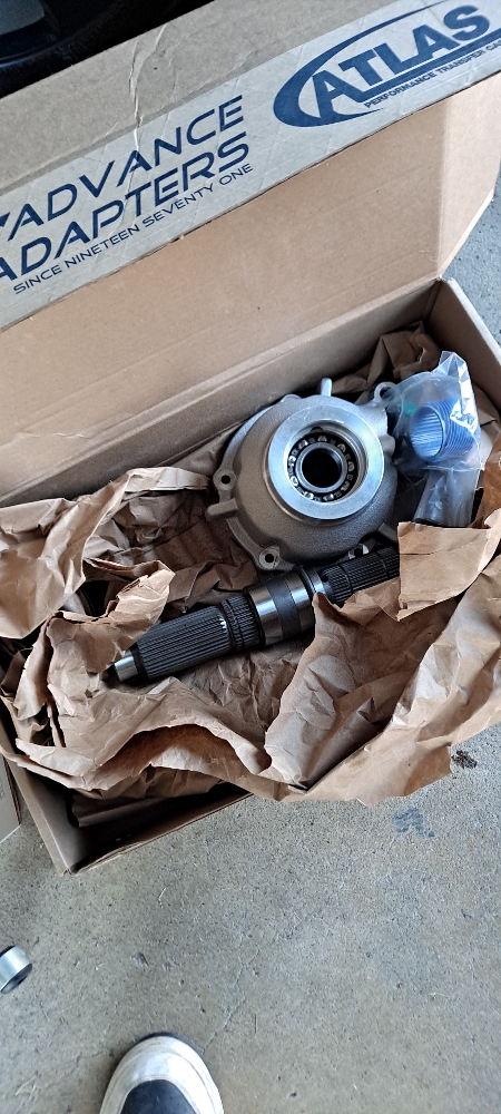

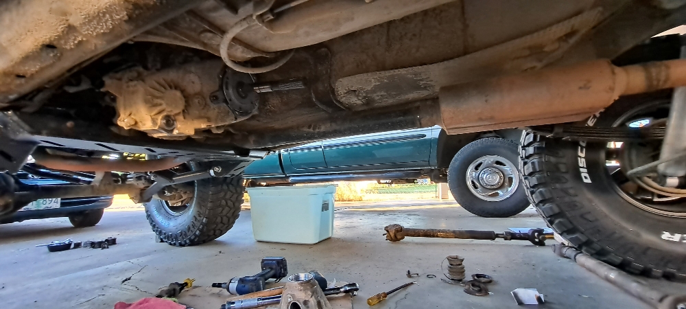

I went with the rubicon express Slip yoke Eliminator
Sent from my SM-A516U using Tapatalk
I guess i went went with the advance adapters SYE lol disregard the last post,

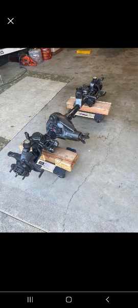

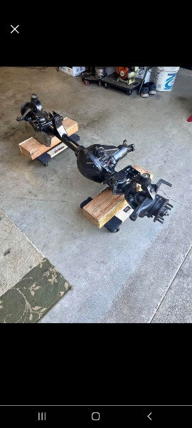

So i ended up settling on an 06 rubicon dana 44 for the front axle. Axle is in good shape with fresh 4.88's, New Seals, Sleeved with the OEM Air Locker.
According to my research i can get the compressor they used in the rubicon from a range of vehicles that used it as an axle disconnect at the junkyard.
I was going to build the hp dana 30 housing i had but this ended up being half the price it would have cost me. Ill be throwing chromolys in it to keep from breaking u-joint ears. Only thing past that is C gussets and possibly a truss but i may wait to do that.

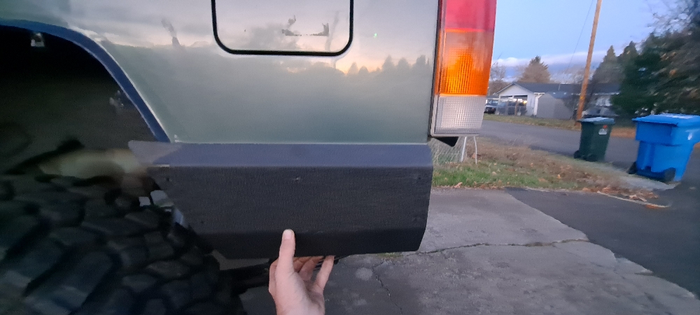

I think the cut and fold looks silly with some bumpers... never seen anyone crush that lower corner either. Not like it's killing depart angles right? Cut and fold can look slick, but without a custom bumper idk it's worth it? Plus an obstacle that would actually hit that corner, would probably have ya high centered after the front tire clears, no?
Maybe I need a visual of "why"
Nice score on the Rubicon 44! Whatd it set ya back?? I'd love one, but fear the investment might be too steep and nearly to a 60/ 1ton set up. Like I'll ever be on 40s with my budget lmmfao
No joke those rubi 44s are lined with gold local to me... the jk rubi stuff is currently lined with diamond though hahaha
