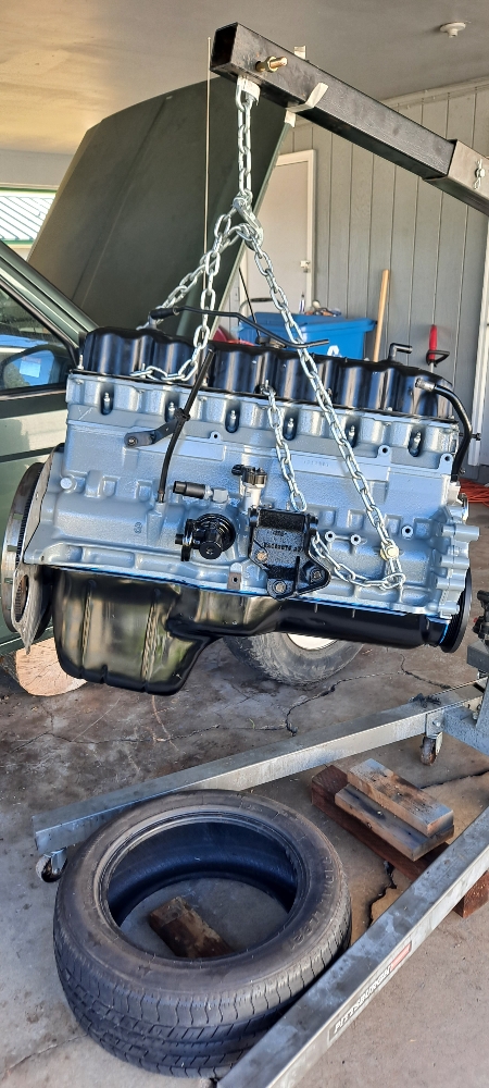

I went ahead and replaced the oil filter adapter seals, front seal and timing chain/gears, Then i replaced the rear main and oil pan gasket the next day.

Cleaned the donar engine up amd taped it up to get ready for paint

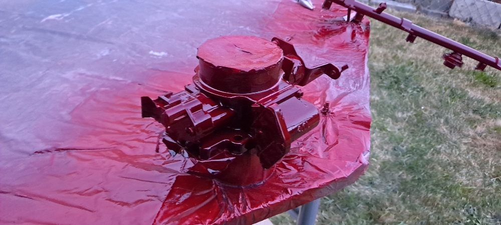

Painted the fuel rail, throttle body and thermostat housing. I really like this paint.

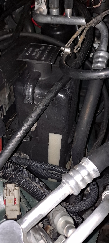

Painted the coolant resevoir after cleaning it for 3 days then accidently got electrical cleaner drip on it while I was spraying all the connectors out tonight but even if I gotta touch it up no biggie I think it turned out good.
And here the engine sits as of today

I also had to clean and repaint the other fuel rail as i overlooked that there were specks of rust inside the the one I had painted before :/ so I used the one of the 97 and gonna have to double check the fuel system. The injectors wernt clogged so I don't know what that's about..
