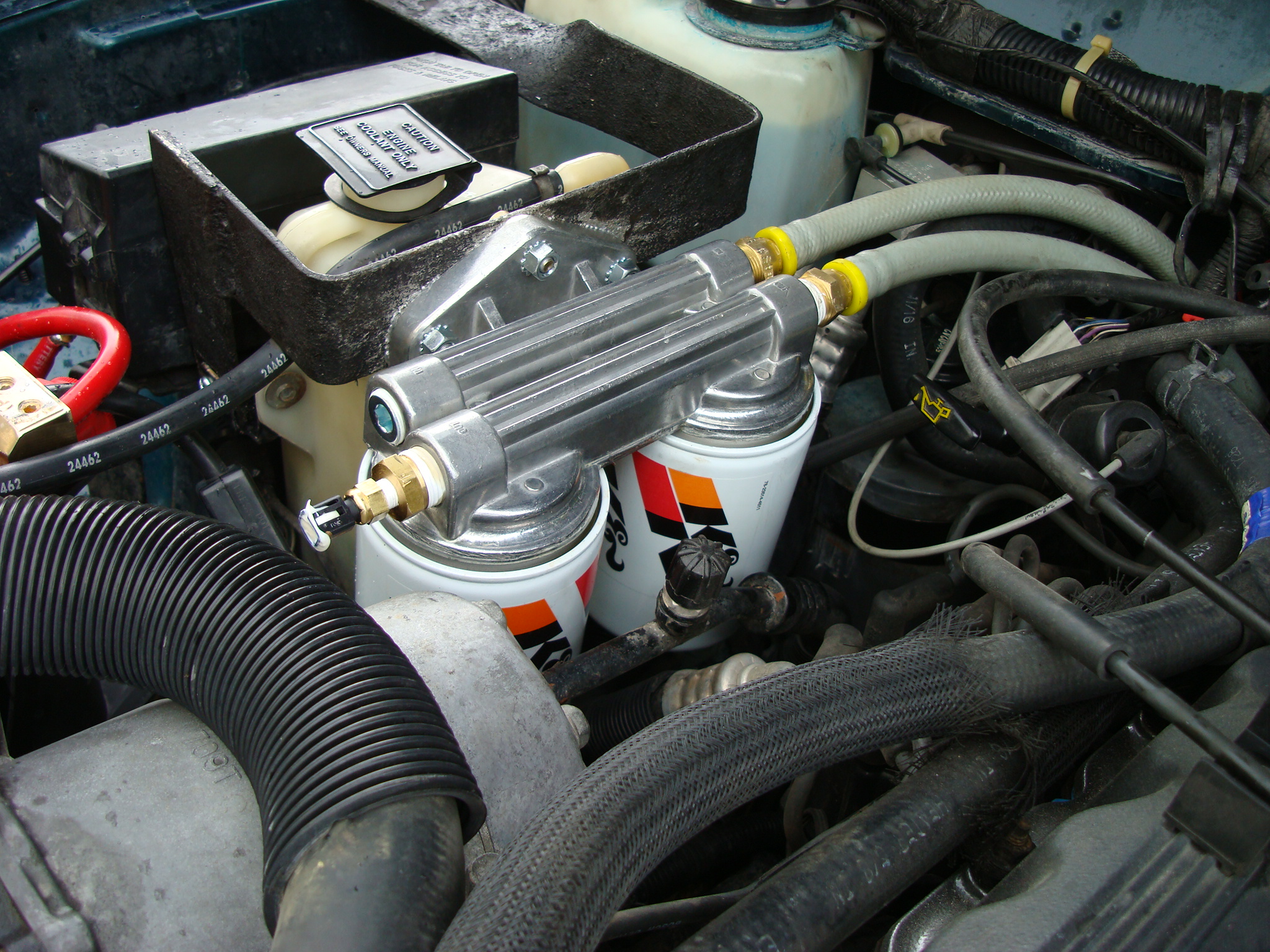

I like my dual filter set up... takes about 2 gallons of oil with the two oversized filters.
Nice installation. Not that familiar with the 95, did you fab the bracket?
yea, got some 2" flat plate (1/8" thick) from homedepot and used a torch to get the bends. Its tied into the hood hinge bracket on the fender/body and then bends around and ties into the bracket that the coolent tank and power distribution attach to.
this just uses two filters to flow an equal amount of oil....
It is not one of the more expensive and fancy ones that takes a % of the oil and runs it through a high effeicent filter.
But it is a complete remote relocator.
