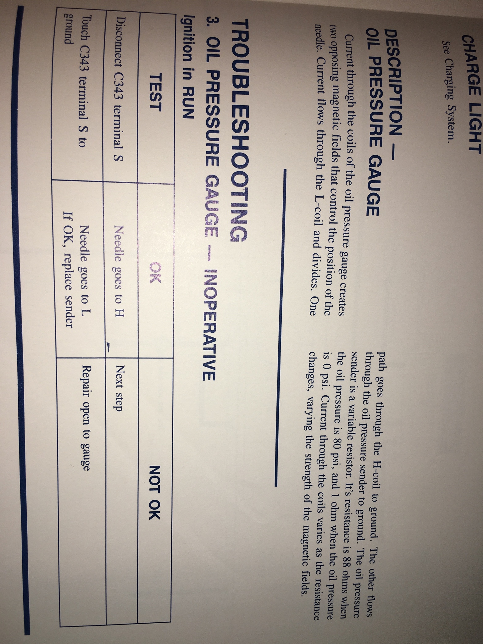

Here is the jeep trouble shooting guide for 1988. If you can zoom in it should explain everything like 1 ohm = 0 psi, 88 ohm 80 psi.
Basically disconnected the gauge should read H , grounded L, if that checks out the sender is bad, if not the gauge is bad. But keep in mind that sender wire could have a problem too.

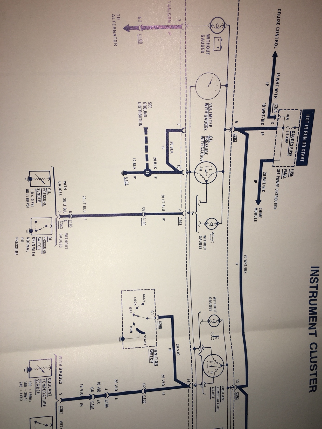

I'm not near a wiring diagram at the moment. Perhaps check online and look for a plug somewhere between the wire at the sender and the gauge.....

Sounds like either the gauge is not getting power, or the wire between the gauge and the sender is shorted to ground.
