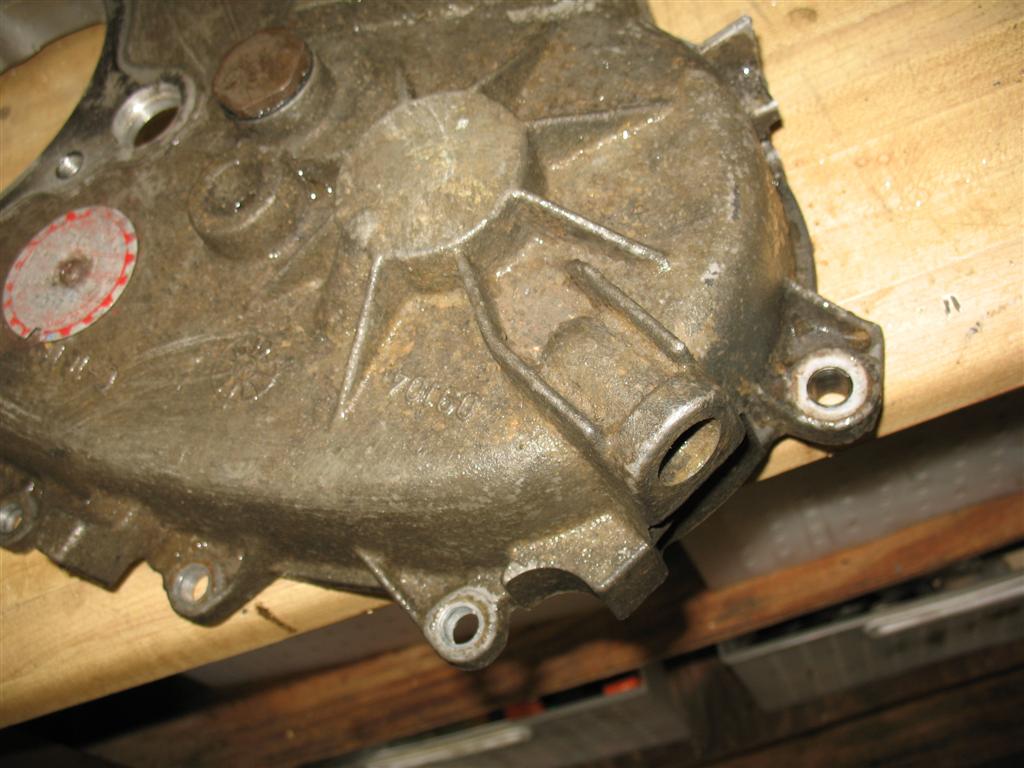

I picked up a 1990 vintage NP242 from a guy in the local club. Interesting thing, the rear case half has some kind of tube fitting on the top at the drivers side. Could be useful for a little 12v cooler pump return. The inside is closed, but it could be opened with a drill pretty easily. Its just above the front output bearing.
Might not work that great since it is above the fill port, so there would have to be some air in the cooler line by necessity, but if it just kicked up at the end and the rest was full of fluid it would work alright.
Re: Re: NP242 rebuild with upgrades
While your at it, you could drill out the upper drain hole too. Neat find! Does it have a casting number?
