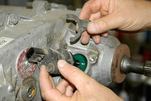

Ok so here's the story. For a week or so the gauges started acting funny, namely the speedometer.
This started happening after I swapped the Transfer case.
Figured it was just a bad speedo sending unit on the donor t-case.
Before I had a chance to do anything about it, and after a week of the jeep sitting in the garage (its not a DD)
