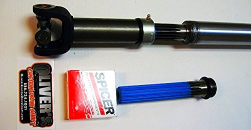

Are you sure your slip joints have enough engagement length? It is fairly unusual around here for them to give up unless they haven't been greased or are pulled to far apart.
I just ask, because if you order the same length and this is a problem, you will be back ordering in no time. Some drive shaft component manufacturers offer a slip joint that is significantly longer just for this reason.

And when I meant HD slip I meant this so you are spot on with your recommendation.
