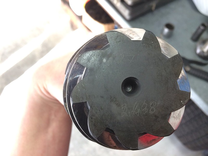

My question- I have all new Motive gears, and Timken bearings. Factory 8.25 gears should have the "+ or -" markings indicating the addition or subtraction of shims. (As per our FSM at work.)
My old gears, and the new ones do not have this. Can someone explain what these numbers mean? Thank you!

Only factory gears do the math for you. The +/- is deviation from the standard depth. So you just subtract 4.125 from standard C8.25 pinion depth.

Aftermarket gearset makers don't use the same grinding machines that OEM uses, hence no + or - offsets. Disregard that section if you are using a factory manual.
4.125 is the master housing dimension (truth be told it is actually 4.124) of the 8.25. It really means nothing to you unless you have the pinion depth setting gauges.
Winging it, as you will be, you will need to at least start with (even though you don't want to) the current pinion shim and go from there. You need a starting point and it's better than nothing.
